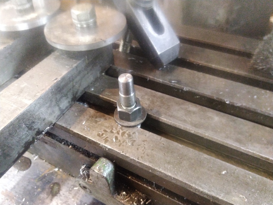

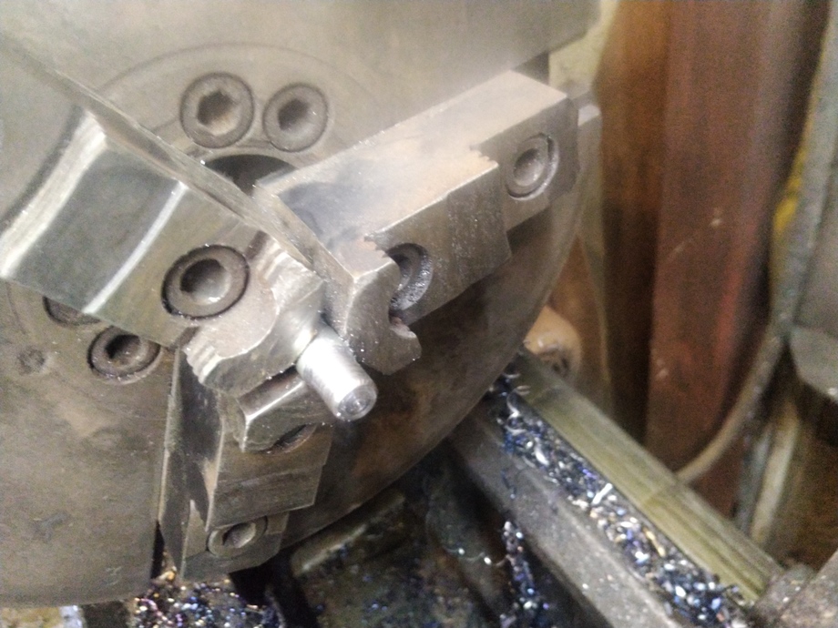

For drilling a series of holes in a straight line on my mill or in a drill press for that matter I like to make a stud pin hole locator.

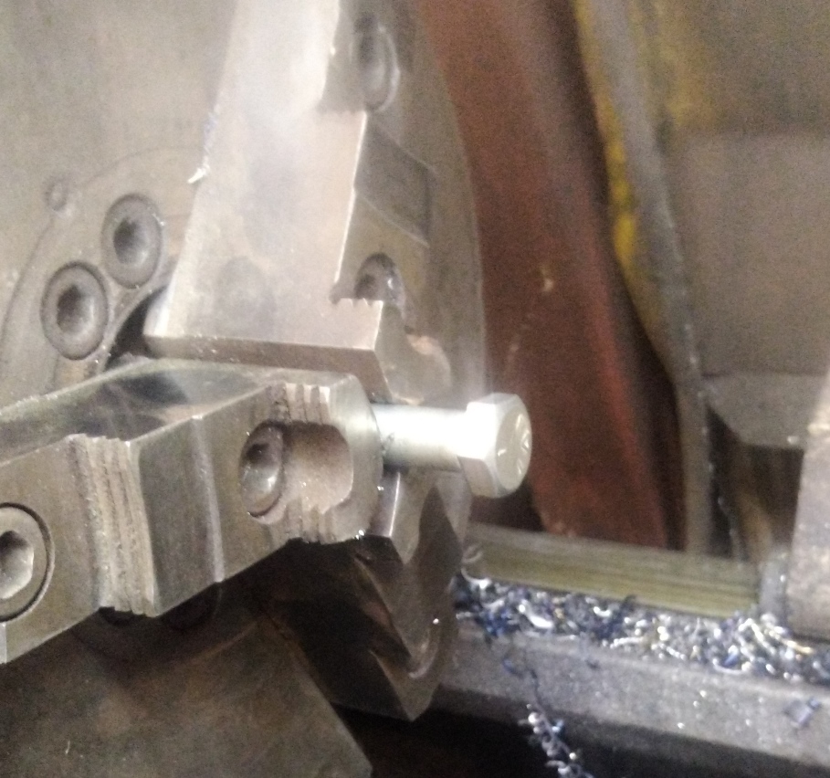

For my T nut project what I did was machined off the head of a 1/2" bolt then turned the OD of the end of it down to match the ID of the holes in this case 27/64s
Attachment 42171
Attachment 42172

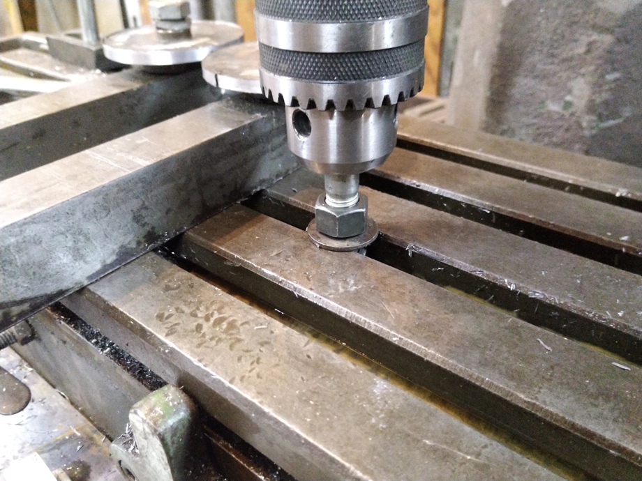

Loosely mount it in the table slot

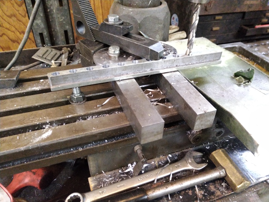

Attachment 42173
Center the drill chuck over it snug up the chuck and tighten the stud pin in the table loosen off the chuck and shift the table the proscribed distance to where the next hole would be lock down the table and start drilling

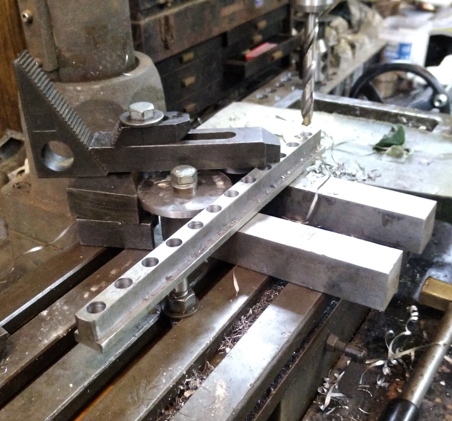

Attachment 42174
Advancing the bar one hole at a time the standoffs position the bar in the Y plane while the pin stud positions in in the X plane until I have advanced as far as I can still clamp the bar

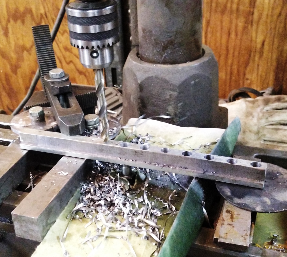

Attachment 42175
Then I remove the stud pin flip the bar around use the drill bit to locate the last hole drilled re locate the stud pin under a hole in the opposite end of the bar then drill the remaining holes

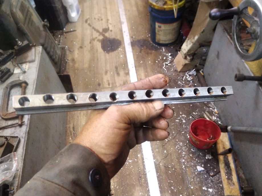

Attachment 42176
Attachment 42177
Attachment 42178
