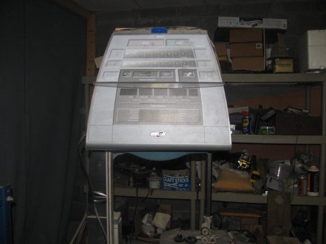

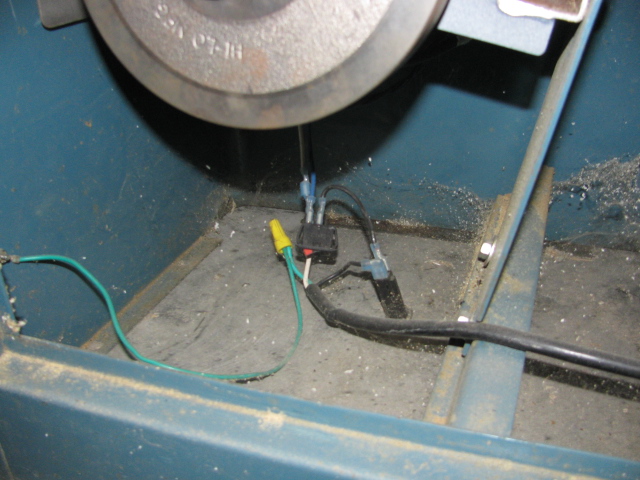

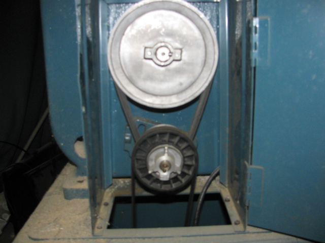

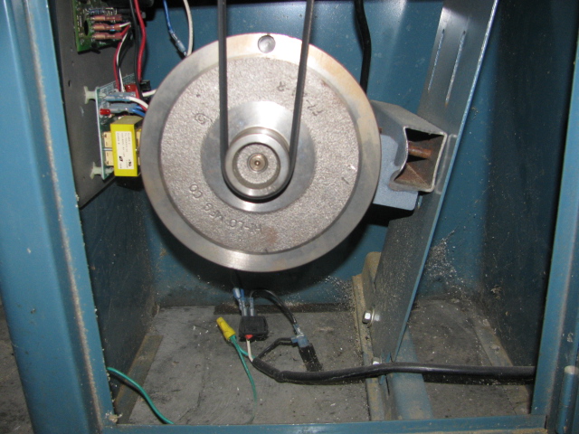

Here is an explanation of the numbers for the length of belt that you need. This is a Gates number==380J8. 38 meaning the length O.D. in inches,- J, meaning a micro poly-groove V belt and the 8 meaning 8 grooves. Here are some pictures of the treadmill motor setup on my bandsaw, hope this helps. The motor rests on a plate that is hinged and the weight of the motor tightens the belt. Robert Brown. If you have any more questions, please ask. The controls are upside down because that is the shape that fits the top of my saw. If you don't want to use the whole console, I suggest that you get the type of controls that either have a slide type control for speed or a round knob type and then you can relocate the controls elsewhere so that it doesn't ugly up your saw.
