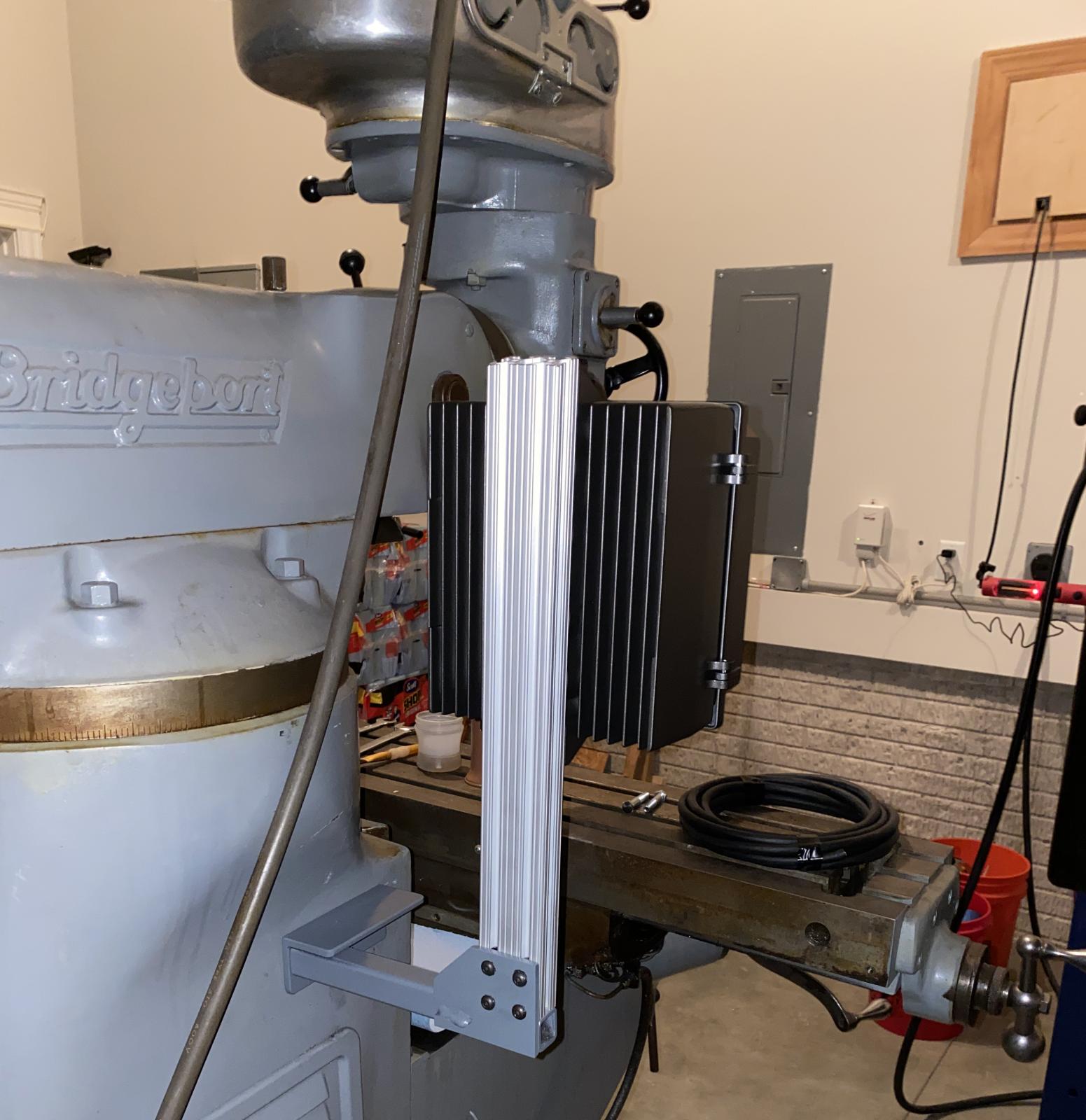

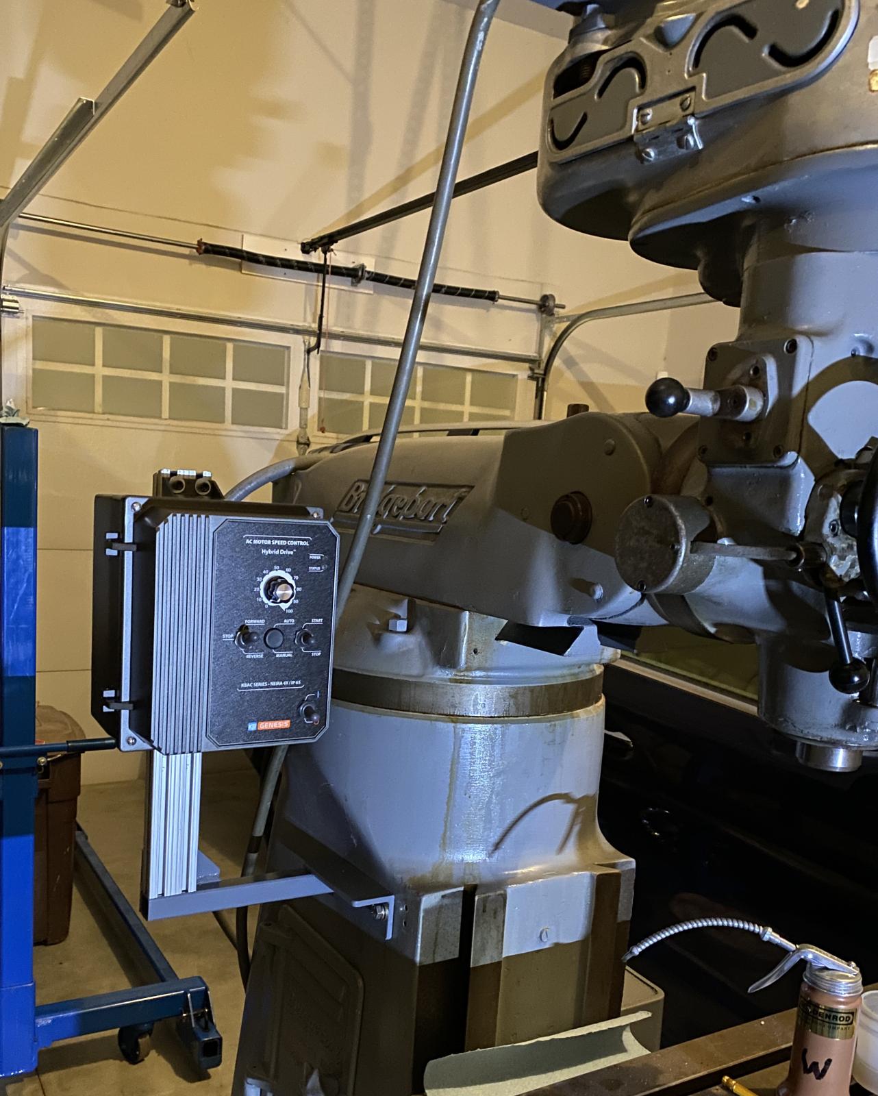

Used a length of 8020 1" x 2" extrusion, some 1" square tubing, and some angle iron. Enlarged and tapped two existing holes in the mill body. The slots in the extrusion match the bolt pattern in my VFD perfectly.
