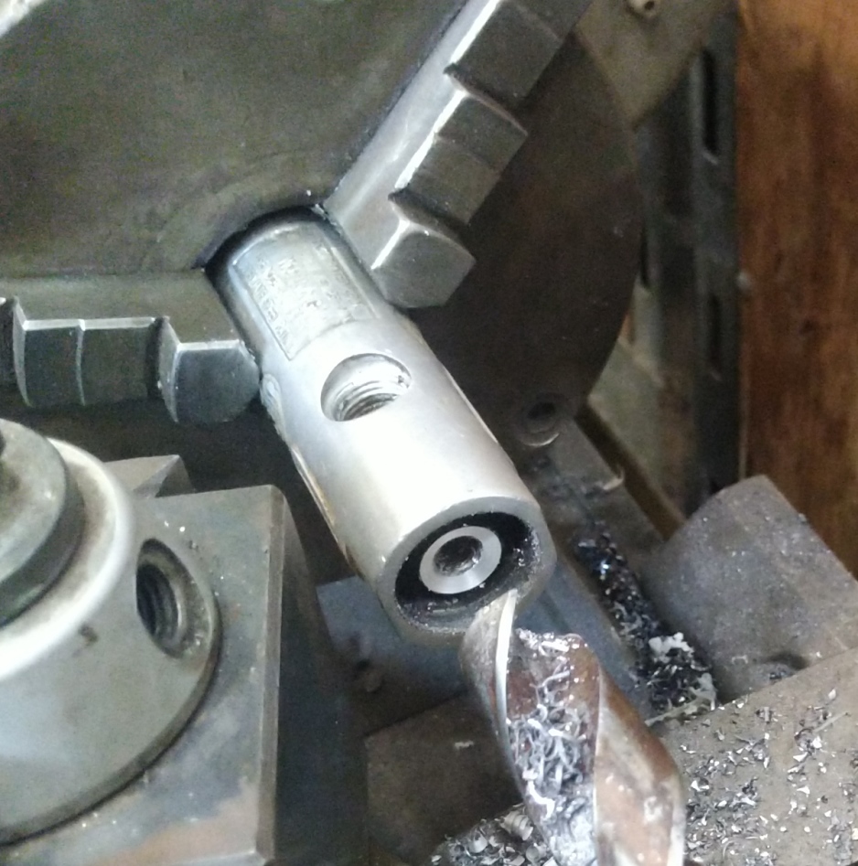

Starting with a 12Vdc linear actuator motor, a worn out die grinder, a cylindrical NEO magnet this is what I came up with

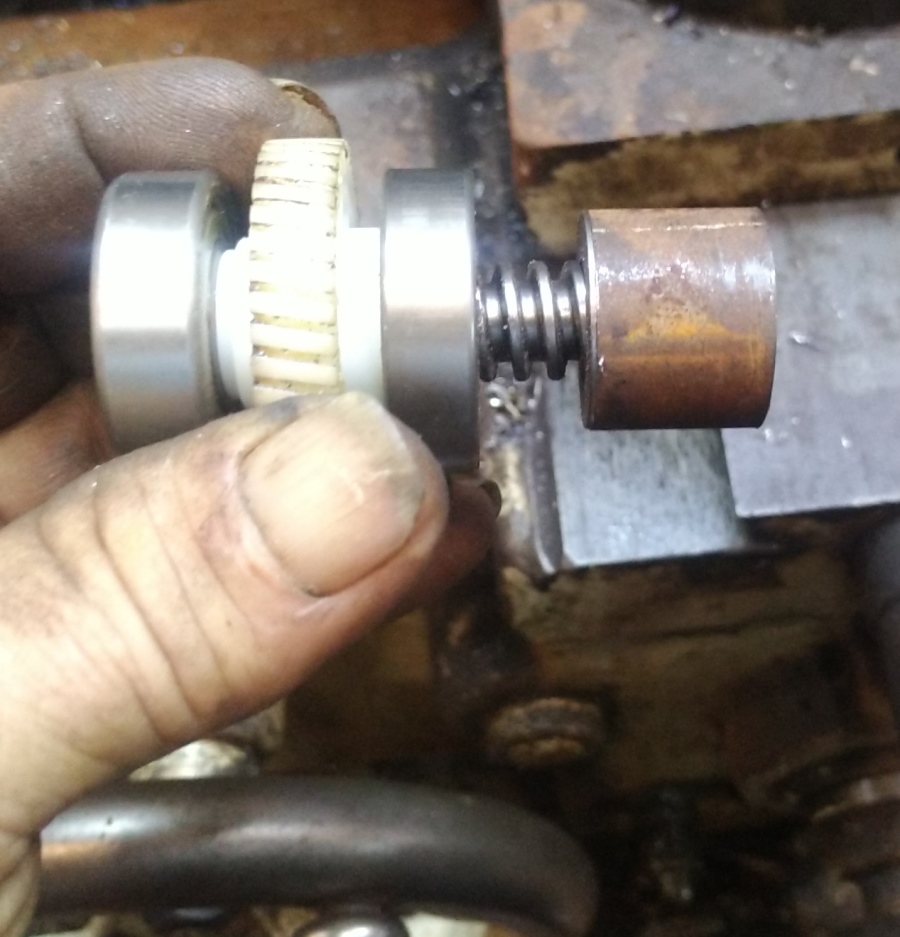

Attachment 43664
I shortened the acme screw and pressed hub on the end of it to mate up with the magnet

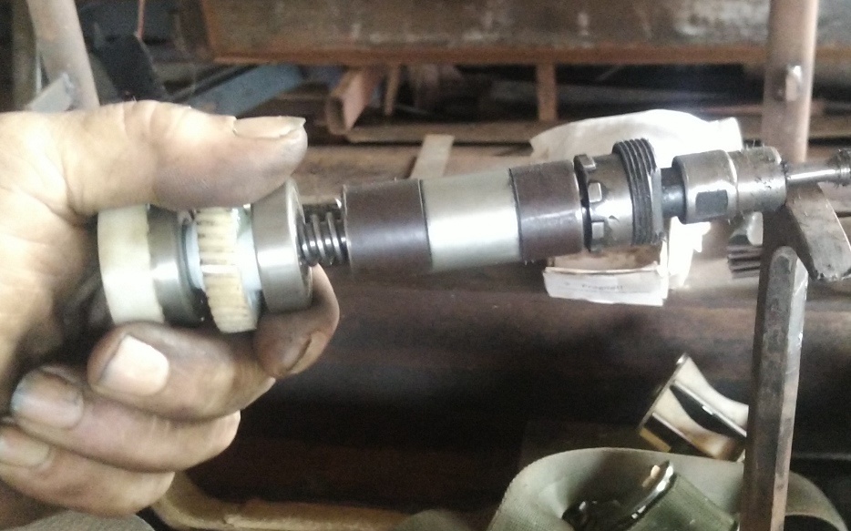

Attachment 43665
I did the same thing to the die grinder rotor then by magnetic connection only picked up a 20 inch heal bar with it while holding it horizontally, Seems plenty strong
Attachment 43666
Attachment 43667

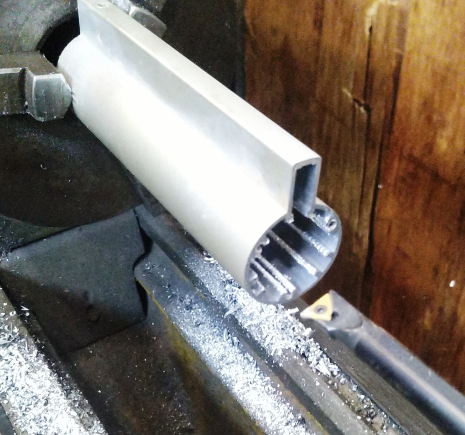

I then drilled and bored out the die grinder housing so I could take advantage of the shaft bearing

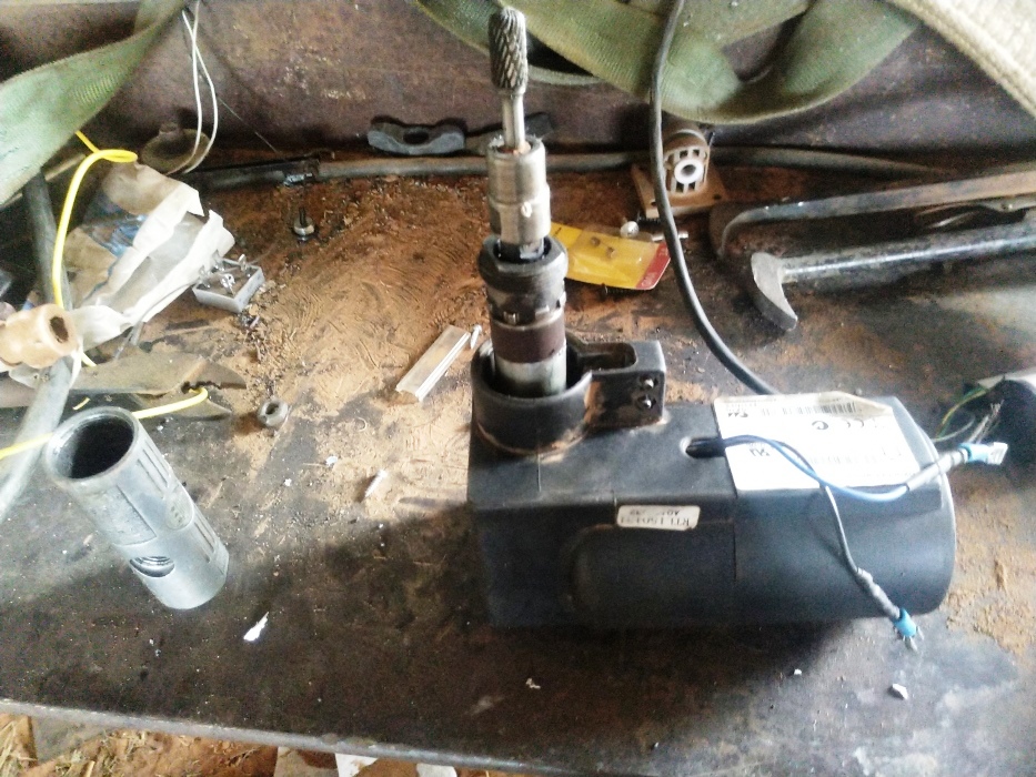

Attachment 43668

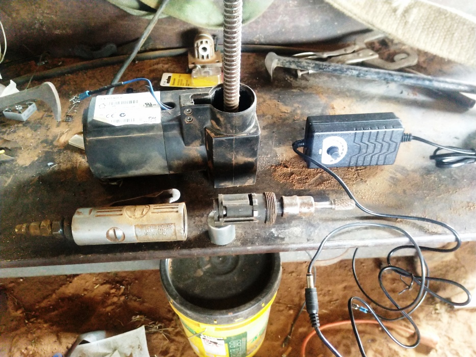

then I bored out the actuator housing so the die grinder could fit inside
Attachment 43669

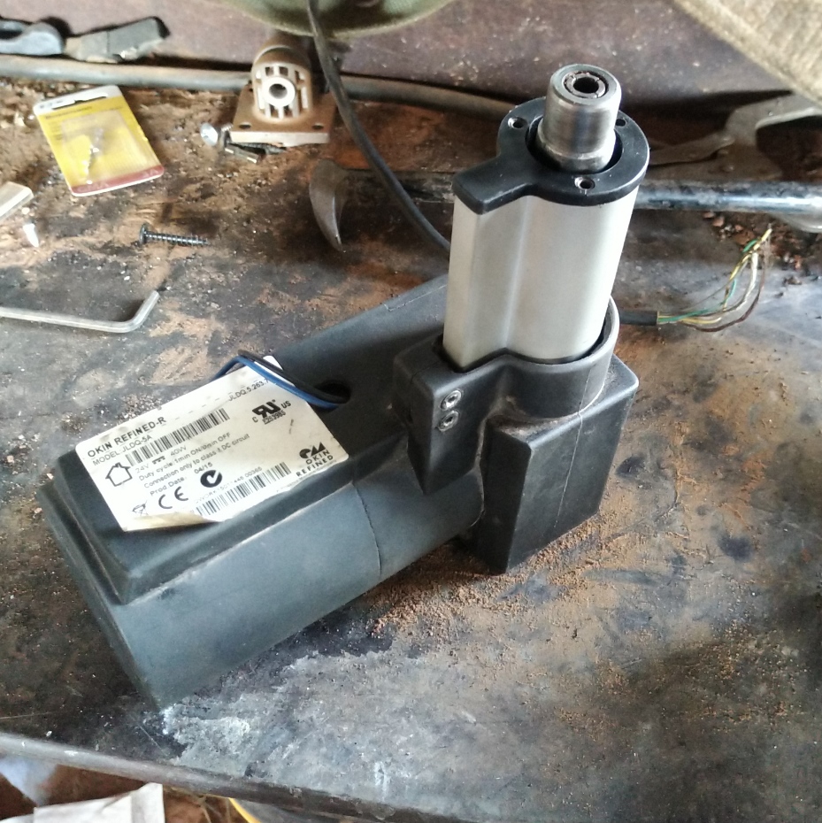

After shortening everything and assembling this is what it looks like
Attachment 43670
