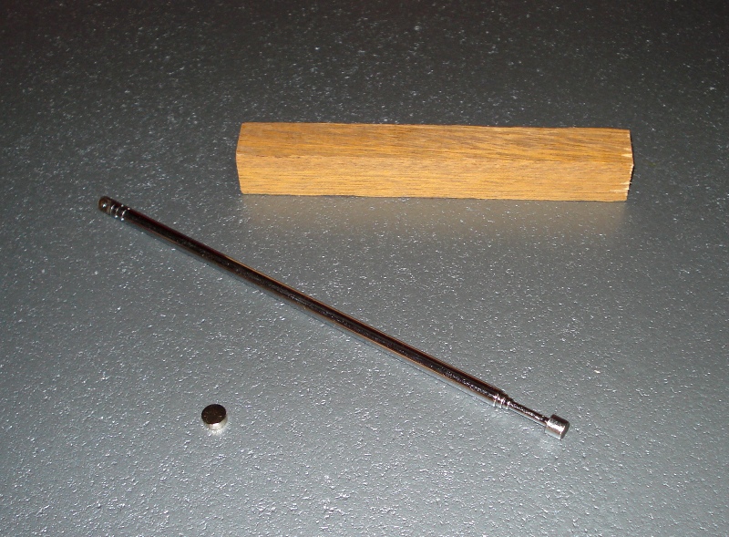

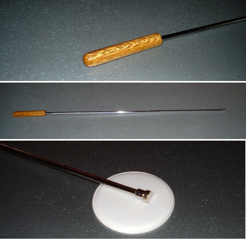

This tool was made with a discarded radio antenna, a neodymium magnet and a leftover piece of oak.
The handle was shaped at the lathe, and finished with sealer and lacquer; both the magnet and the handle were epoxied to the antenna.
It is very useful for picking up screws or metal parts when they fall out of hand reach.
Although commercial versions of this tool are cheap, doing it by yourself allows the reuse of discarded materials, and grants the (priceless) satisfaction of making your own homemade tools.
