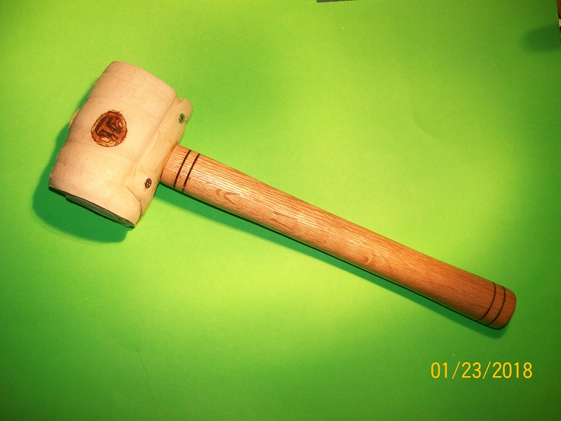

Make Your Own Large Rawhide Mallet
Attachment 21776
Inspired by Roy at Christ Centered Ironworks on Youtube, I decided to make my own large rawhide mallet to achieve better finish results on some of my steel work. At first, I thought I’d simply buy one. I was somewhat dismayed though, after searching online for large rawhide mallets and discovered there were few to choose from, and prices started at over $60.00 (U.S.) plus shipping.
I searched the internet for rawhide materials, and discovered they were certainly available, but at prices and quantities that were more than I wanted or needed. An idea occurred to me that I could possibly use one of those large rawhide “bones” for big dogs, found in pet stores. I figured there would be just enough material to make the mallet I wanted. All I had to do was soak it in water until it softened up and became pliable. The “bone” could then be untied and I could reform it into the shape of a mallet head.
This video shows you what I did and how I did it. This is a project that is easy to take on and does not require any specialized tools or equipment. You will see me using a wood lathe to make a handle, but you can buy handles at reasonable prices almost anywhere. You can even use a 1” or 1-1/4” diameter wood dowel for a handle if necessary. A little wood glue, and a couple of screws are the only other materials required to complete the project.
