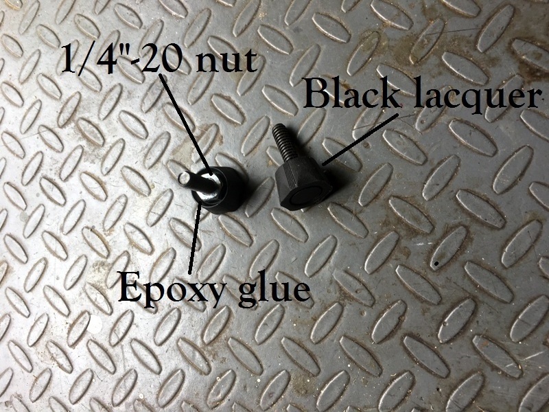

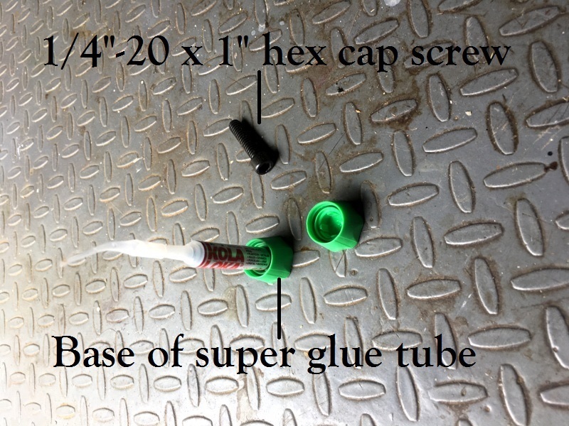

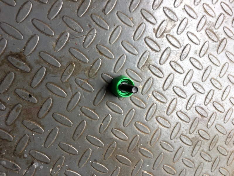

There are lots of homemade knobs. This is a quick and simple improvisation.
Attachment 36113
Attachment 36114
Attachment 36115
