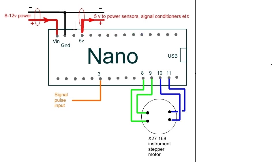

Just a quick one - your Nano schematic shows +5V power coming out to sensors etc from pin 28 - which is actually a Reset and 5V out is from the adjacent pin 27 (as actually indicated on your diagram - but not 'connected').
