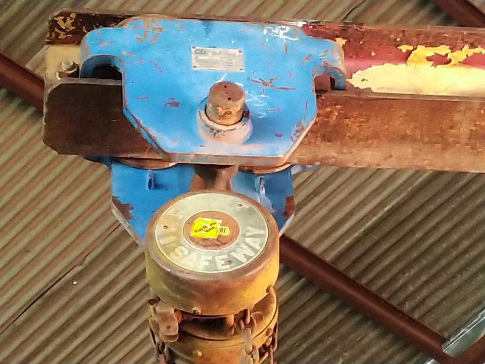

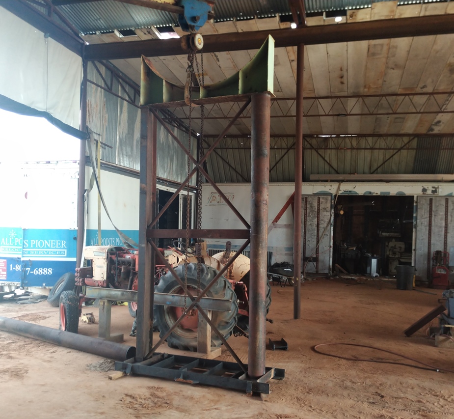

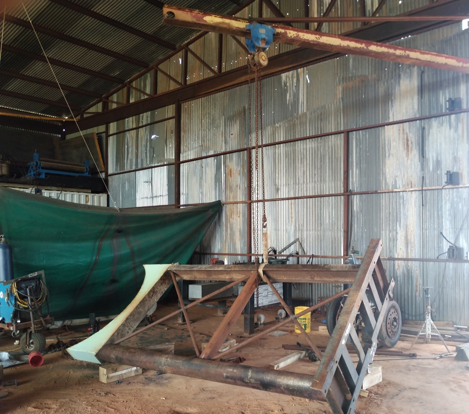

the crane in use
having this sure makes for a much easier and safer way to do things
I could do with extending the boom another 19 feet for more reach and larger coverage area, which could happen in the future as when I designed the hero column I mounted it on I made it strong enough for a 5 ton crane 12 ft from center line on the inside and the outside of the shop with 3 ton capacity at 25 feet from center line as long as the opposing crane was used in conjunction with a counter weight of at least half the load weight when at full length of the beam since I only plan on ever having larger than the 1 1/2 ton hoist I can extend the beam without worries the experience of having built dozens of these in the past even much heavier duty free standing ones installed on US Military bases over seas plus designing and building the bridges for bridge cranes up to 60 ft long and 20 ton cap lets me feel more than qualified to build my own baby jib cranes by comparison

I am constructing a tower to place my 3000 gallon water tank on which was a huge part of the timing of installing the jib crane
More about the stand and the water tank at a latter date

The base for a Jib Crane can be non trivial. Gorbel (www.gorbel.com) for example has suggestions for concrete bases for jib cranes in their manuals and you are talking about pads that can be 4 to 5 feet thick and as much as 10feet wide for a large crane. Needless to say that is a big concrete pour projects.
Given that you may want to consider alternative crane systems for a boat rebuild project. One approach that can sometimes be more economical is a bridge crane. The nice thing with these sorts of cranes is that they often can be installed with little additional foundational work. Also you can be assured full coverage of whatever you are working on. A jib crane almost never covers all of a vehicle such as a boat.
I only mention bridge cranes due to the adoption of them at work over alternatives. They can be fairly cheap to install and operate compared to the need to cut a big hole in your concrete floor for a massive foundation.
