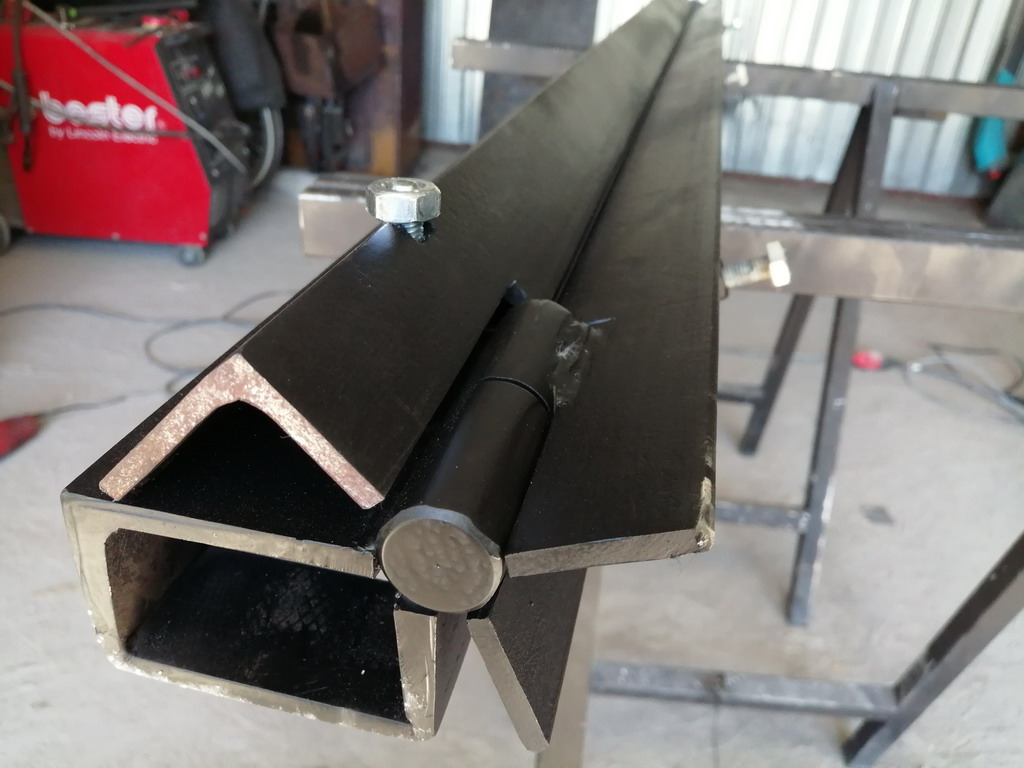

Construction of benders, sheet metal benders. Working width 130 cm.
The construction was used:
metallurgical channel 100x45 mm
2x metallurgical angle 50x50x5 mm
2x turned hinges, diameter 25 mm
5x M10 screw
profile 30x30x2
profile 25x25x2
expansion spring
socket 17 mm
50mm x 5mm flat bar
