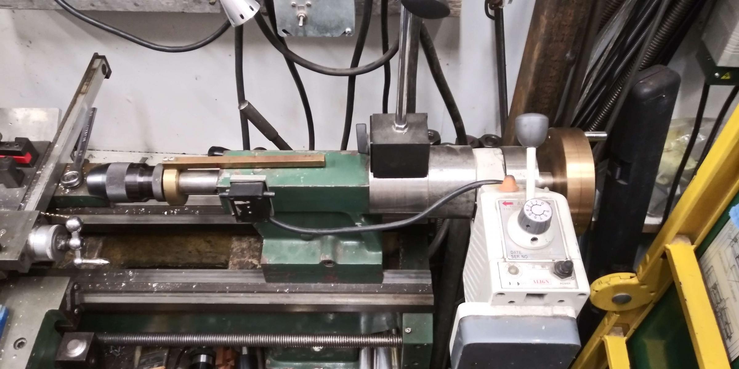

One of the most useful lathe mods I did was putting a power feed on the tailstock. I have this on my 10x20 lathe, and need to make the same modification to the 18x40. It allows very slow feed using large drills, and they don't grab (I can adjust the feed speed to get the thinnest of swarf from the twist drills), as that was a problem with hand feeding, at least for me. This reduced the number of drill changes or boring bar cuts when enlarging a hole in the job.

The power feed on your tail stock sounds cool. I made a new spindle for my South Bend and put two 3/8" set screws in the side that line up with the flat tang on the end of the taper. The taper will NOT spin now.

Yes, I had to make a new quill for the tailstock that I could mount a new female acme thread component I purchased from MSC along with the precision lead screw.
And I machined the MT2 hole to have the tang holder.
Attachment 36727
The cylinder between the power feed and the original tail stock was for a longer quill, as the original travel was less then 3 inches. I seem to do deep boring on most of the repairs around my shop. The crank came from a scrap piece of brass I had in the shop. The original crank, got damaged, when I accidentally pushed the tail stock off the end of the lathe, when putting in a long part between centers. This repair was what resulted in the power feed being added. There's still some projects to finish this, like improving the power feed feed stop switch. I would also like to mount a DRO on this for measuring the depth of a drilled hole.
