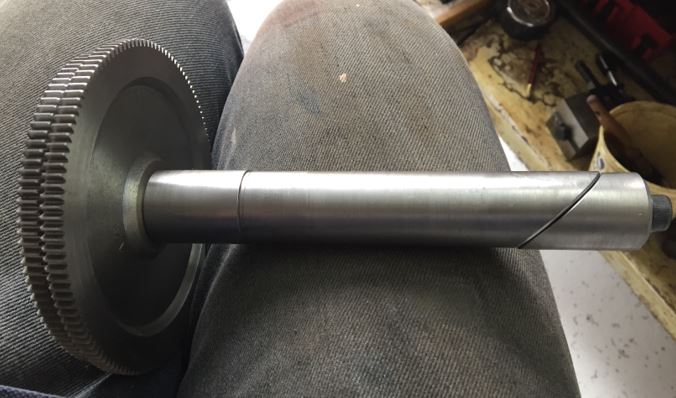

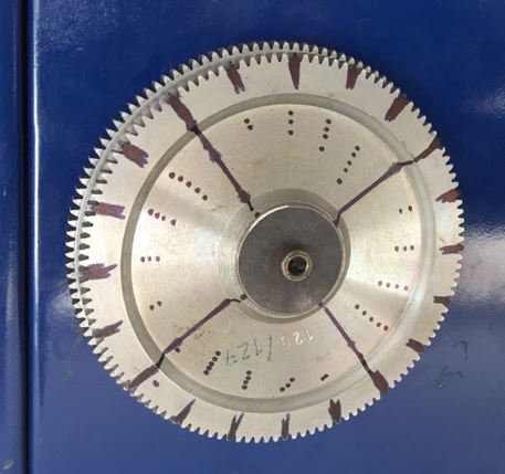

Unfortunately not. Found one of my gears for my lathe has 120 teeth.
So made up an arbor to secure it to the other side of the chuck. Now to make up the stop to fit into the teeth.
Attachment 20979Attachment 20980
