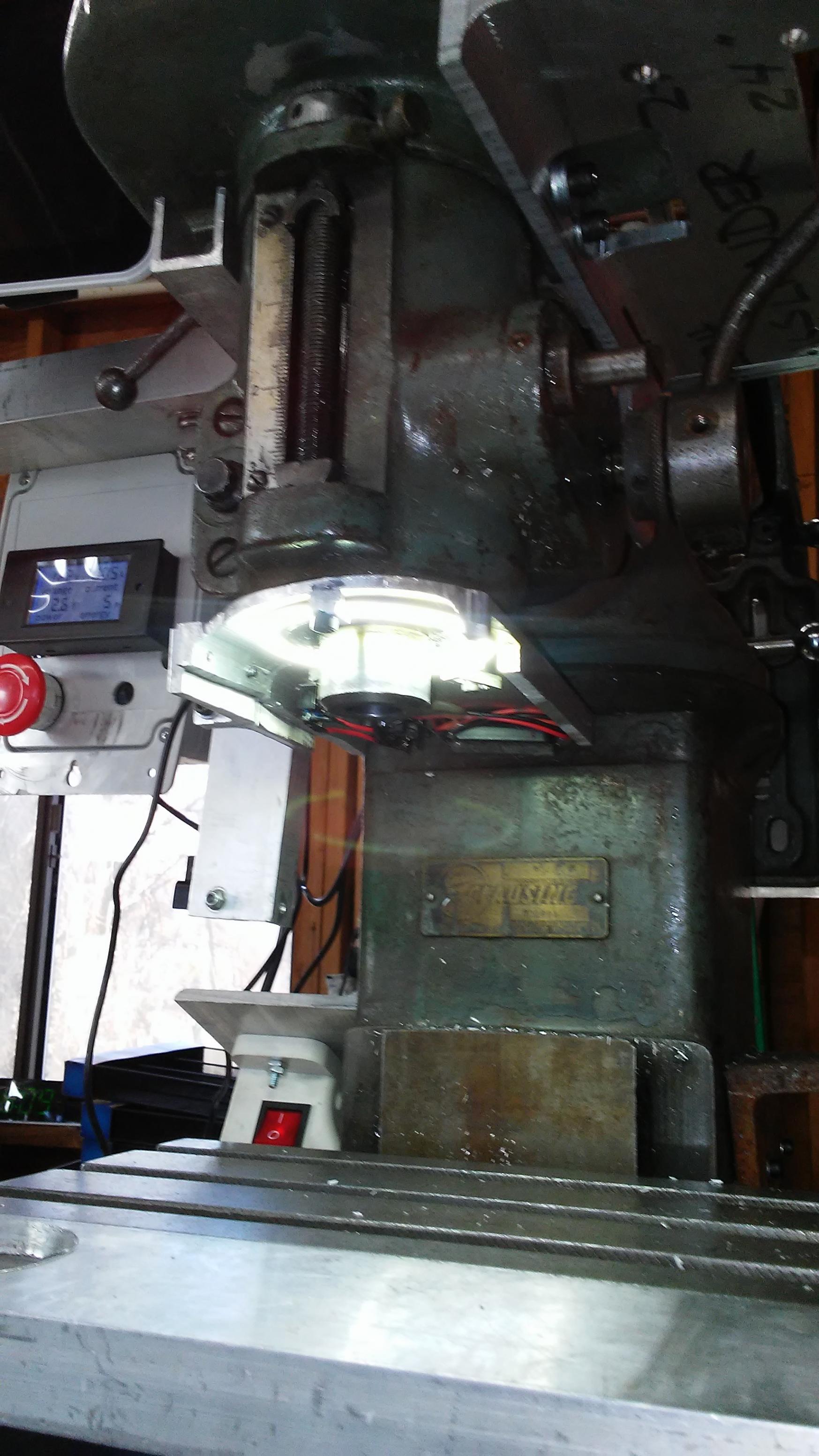

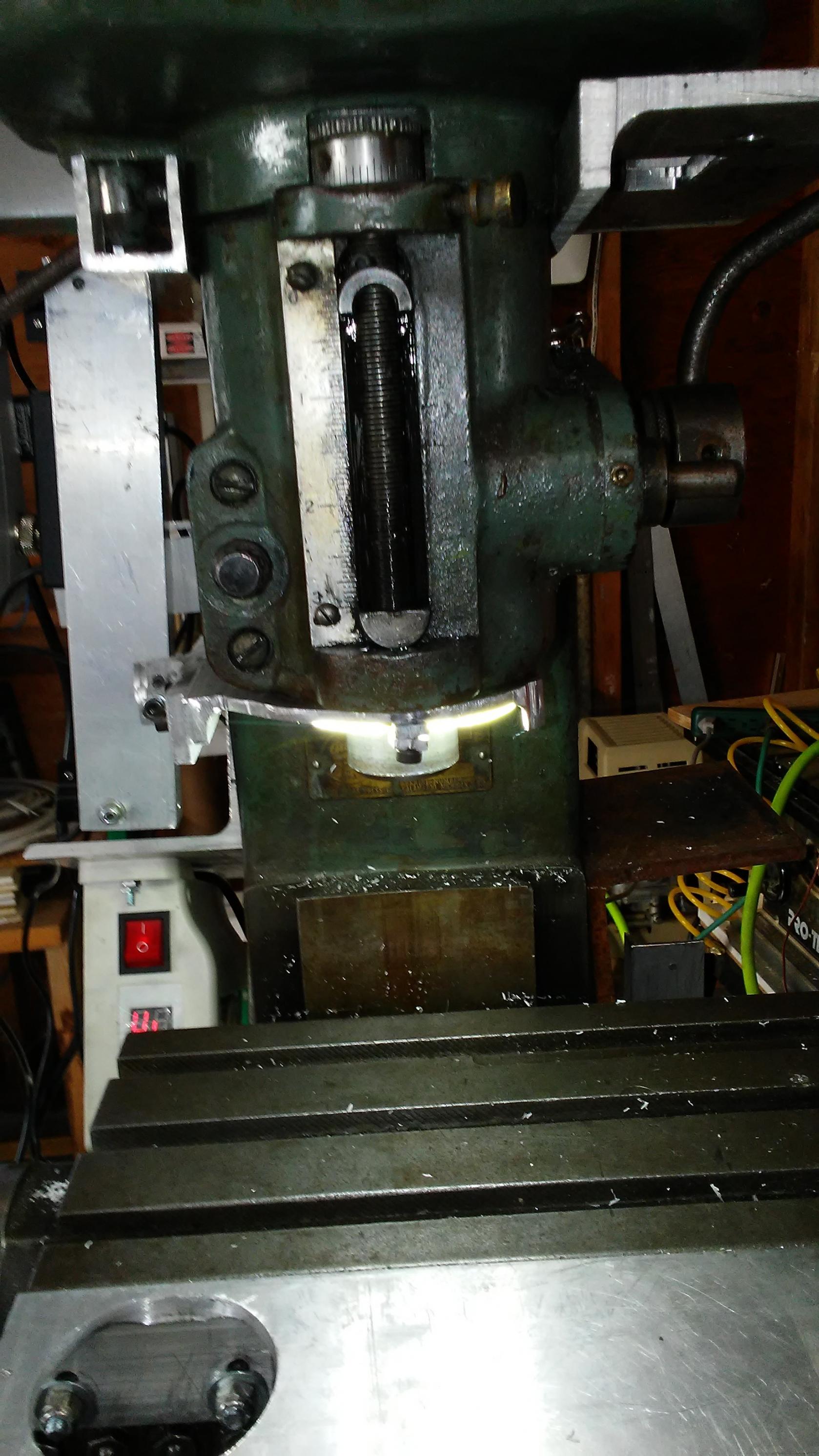

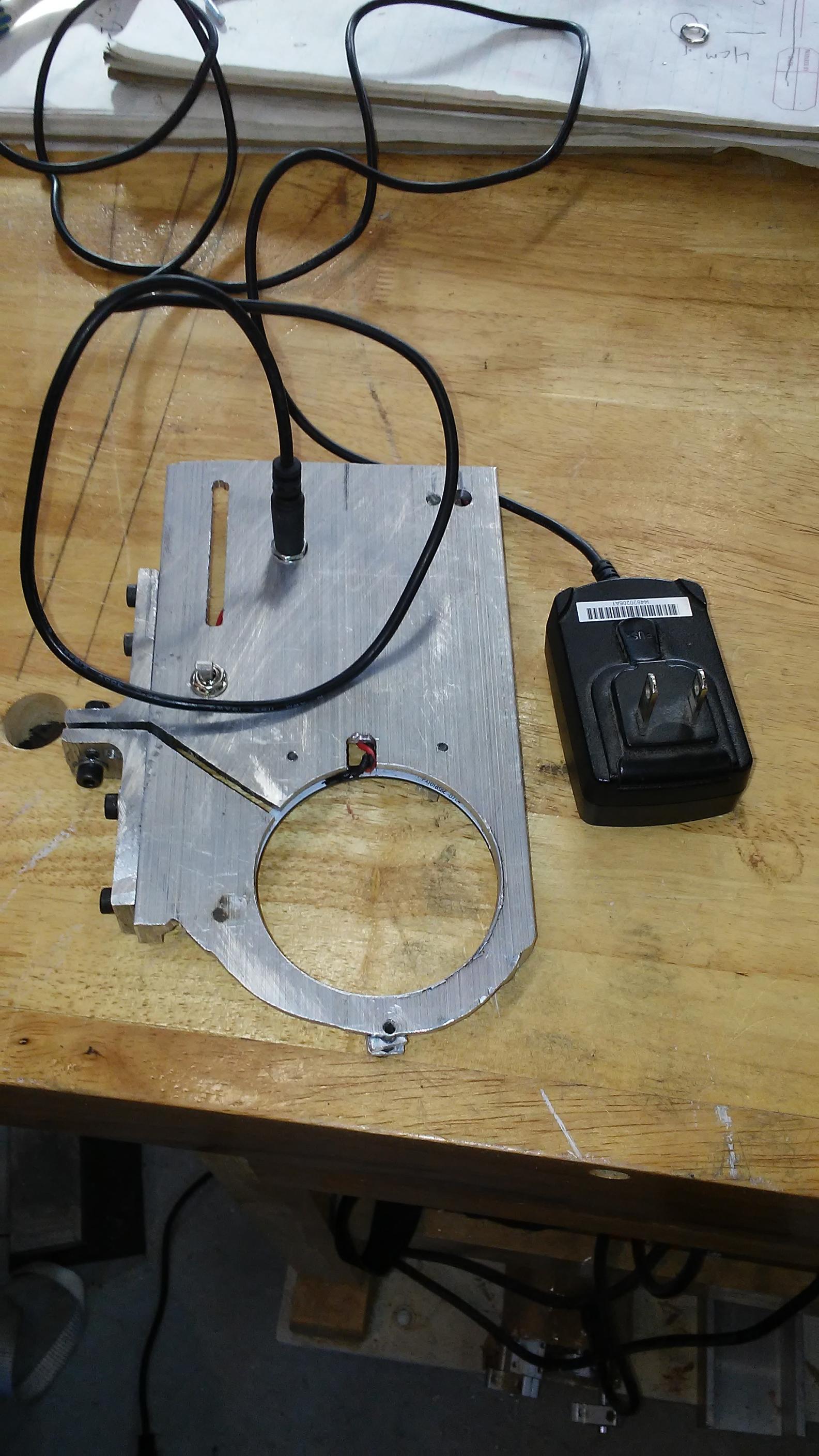

I made a bracket to mount to my spindle for a DRO.
Attachment 17262
and then decided I should add a LED which I got off superbrightleds
These leds do not require a heat sink, I ordered a 70mm I could have gone for a larger (80mm-90mm) that would have given me more leds in the ring. The bracket takes up 1/4" inch so I lose 1/4" from spindle travel but it is off the top and I doubt I will miss it.

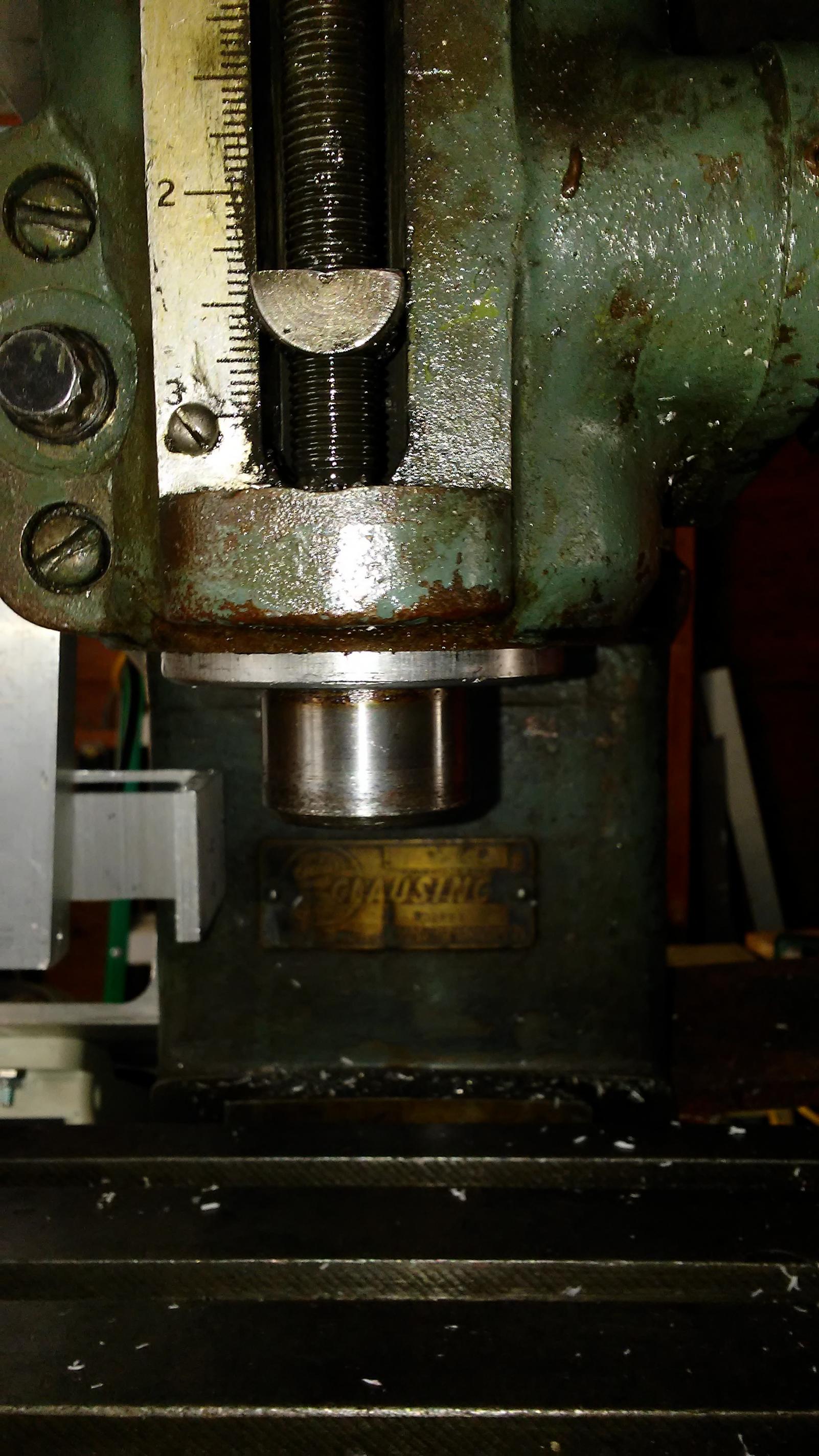

I had to make a travel stop, as if I pushed the spindle all the way up it would pop off the bracket.
The travel stop is not perfect as if the travel rod is rotated the spindle could still push the bracket off, I will have to keep my eye on it.
I do not know how often I might rotate the travel rod to set a Z spindle max travel, we will see.

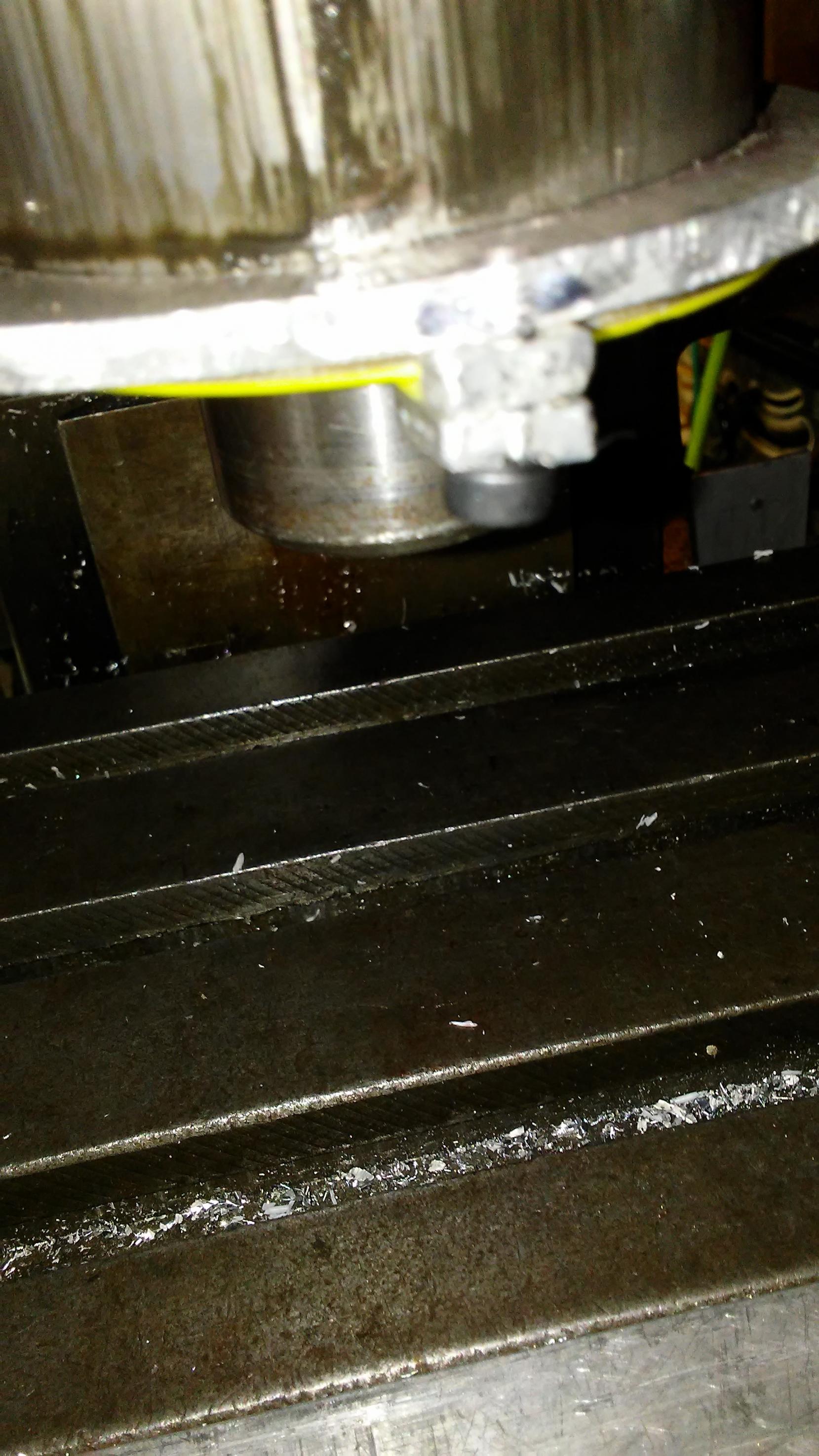

Attachment 17264
Here you see how well the table is lit!
Attachment 17265
And this is without the LED, of course my camera flashed so it is lit but you should see the difference.

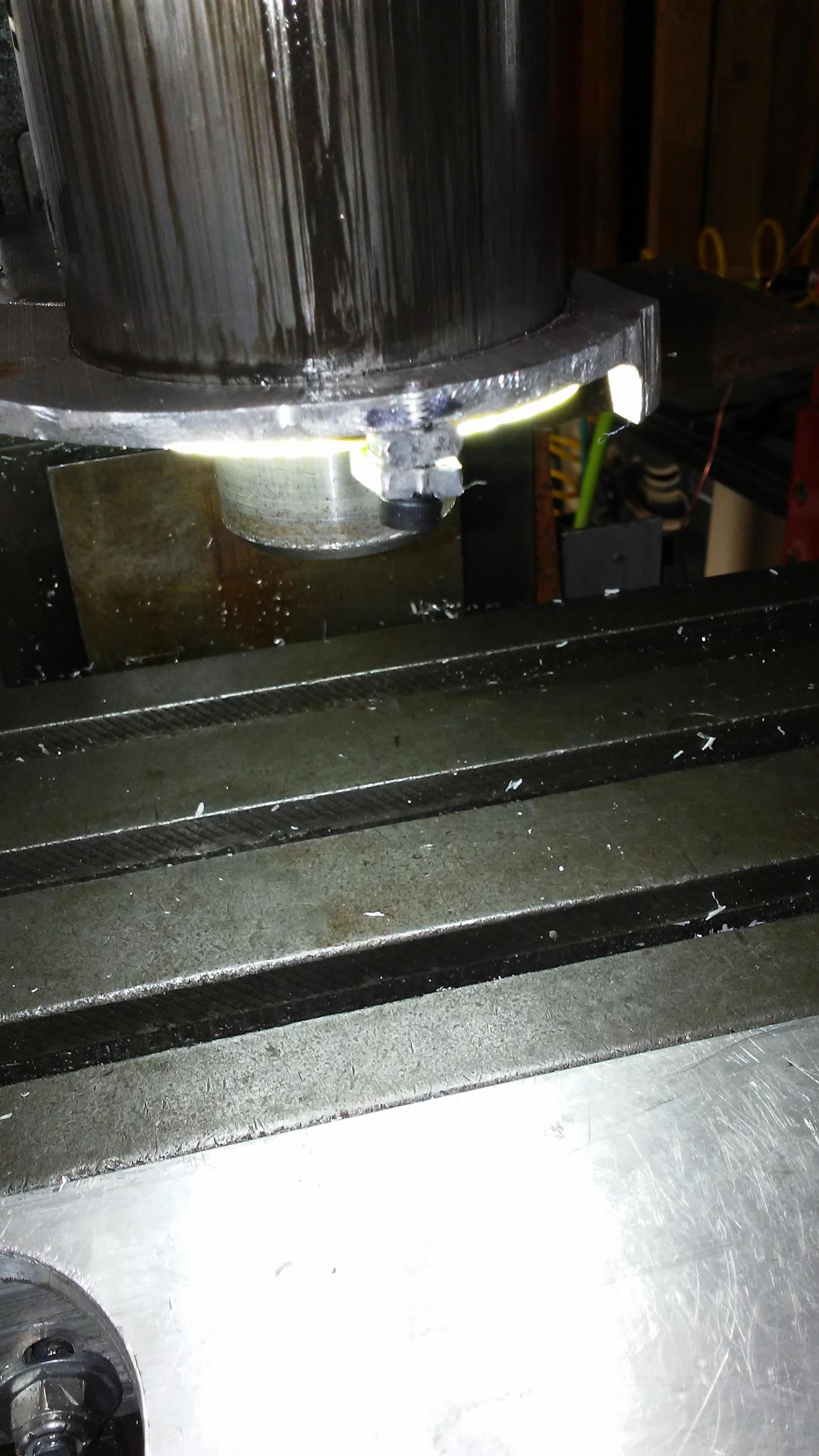

Attachment 17266
Now you see the lit table.

Well I was doing some quick knock out milling on some plastic and had not thought about turning on the light.
When I did WOW, what a difference!!
Oh for those of you wondering, NO there is no shadow!!
Ralph
