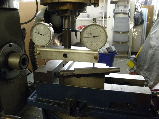

Mill Tram

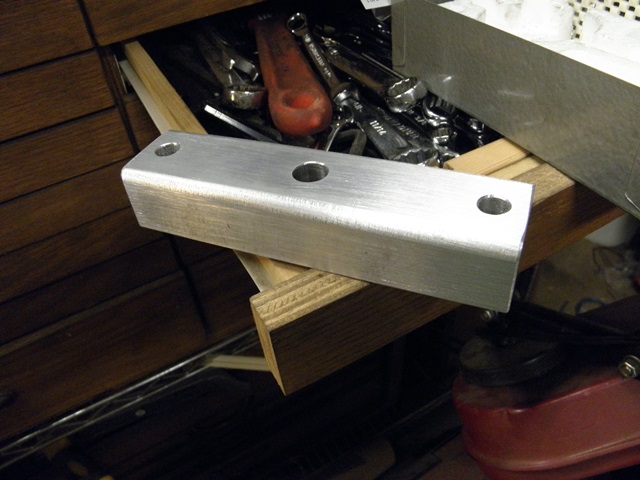

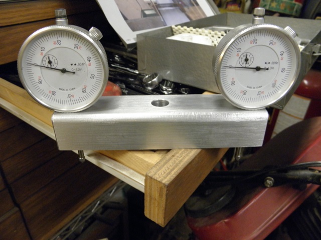

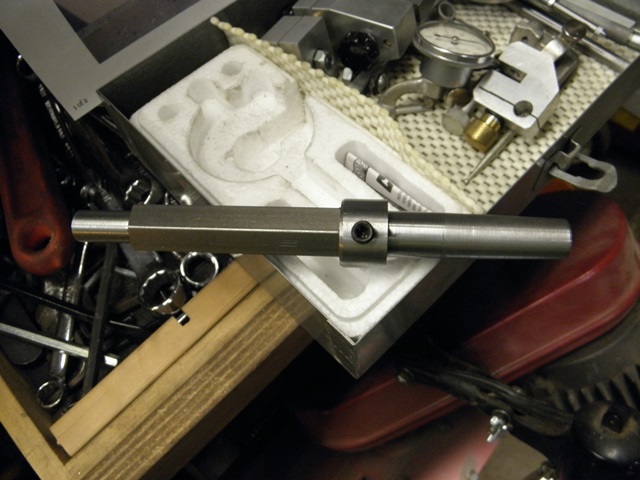

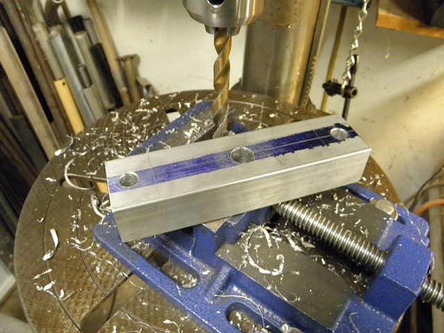

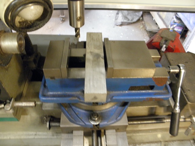

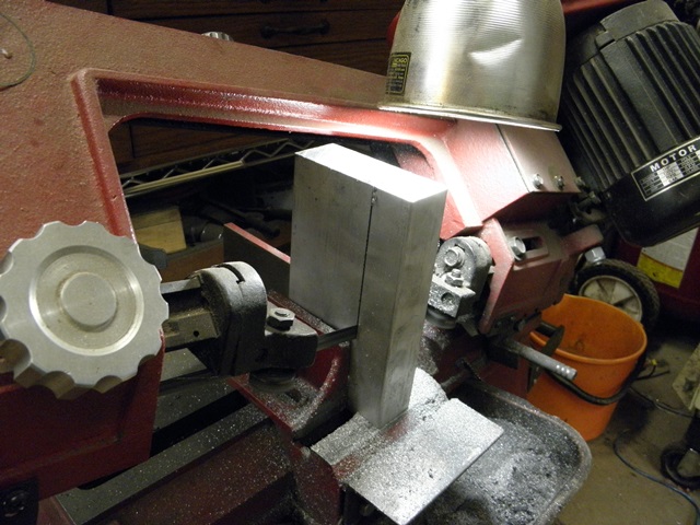

Mill Tram, made from aluminum bar, steel rod and two indicator dials. There are two arbors one for the vise and one for the table top.

Very nice work. That project is way down on my list of must make.
One day maybe
Well ncollar, it will be here waiting for you when you are ready. cheers.
Thanks Captainleeward! We've added your Mill Tram to our Measuring and Marking category,
