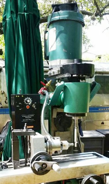

    I finished my motor upgrade to my little mill and it's working pretty darn good. I removed the puny ½HP DC motor and replaced it with a ¾HP 3 phase AC motor using a Variable Frequency Drive. The new motor is about 5 times heavier than the original so I beefed up the motor mount casting with stiffeners and added a support leg because I didn't trust the casting to take the weight.

    Well I've finally finished my mill motor upgrade (the previous completion announcement was premature because as I used it I found it not completely performing to my satisfaction). I made another timing pulley to further reduce the spindle rotation speed and changed the drive:driven ratio to 4:3 and that seems to be about what I want. I have 300-1150 rpms on the low range and 584-2350 rpms on the high range (after I added a switch to put the VFD into freq. doubling mode) and I have a much broader operating rpm range now with plenty of torque at the low end, which was the primary objective of this project, and the extra hp is a bonus. Since my head lock tended to slip a bit and let the quill get out of tram, I added a couple of stiff arms with adjustable bracing screws to keep the head positioned where I wanted it and they appear to be working. I'll use it like this for some time to come. Along the way I've become familiar with my rotary table and I've learned how to make XL timing pulleys to boot and those skills will definitely be put to use in the future.

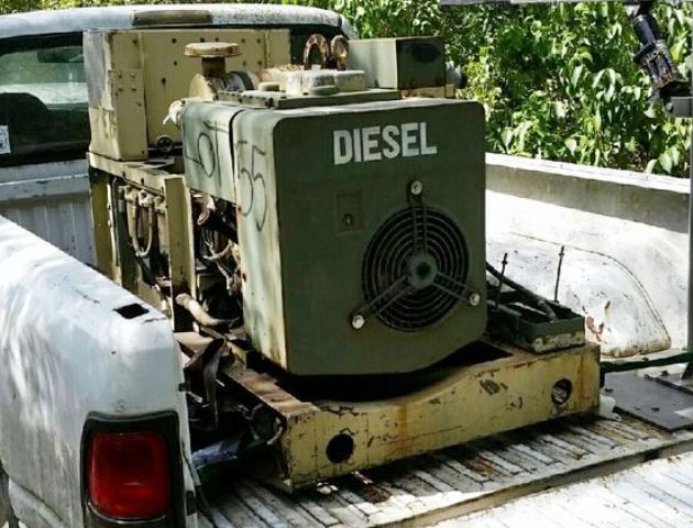

    Now it's time to get started on my next project which promises to be a big one. I bought a MEP-002A ex-military 5kW diesel generator that I intend to restore for backup power when the local electric utility goes down (not often but it's a PITA when it does).
    The first obstacle is getting it out of my pickup since it weighs 1000# and I don't have enough confidence in my bed mounted hoist at its rated maximum weight. I've been shopping for a chainfall hoist this morning and I've already eyeballed a suitable tree limb that with an additional support ought to work for hanging it.
