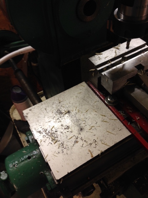

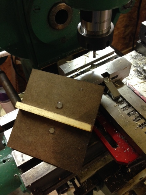

Never want to drop or damage your milling machine table if at all possible. I made these simple covers from melamine and attached a short alignment wood (sit in the t-slots) on the bottom. I also mounted small magnets on the bottom to help hold them in place. (This has proven to be a double edge sword as they also attract swarf on the top).
Attachment 7594Attachment 7595
