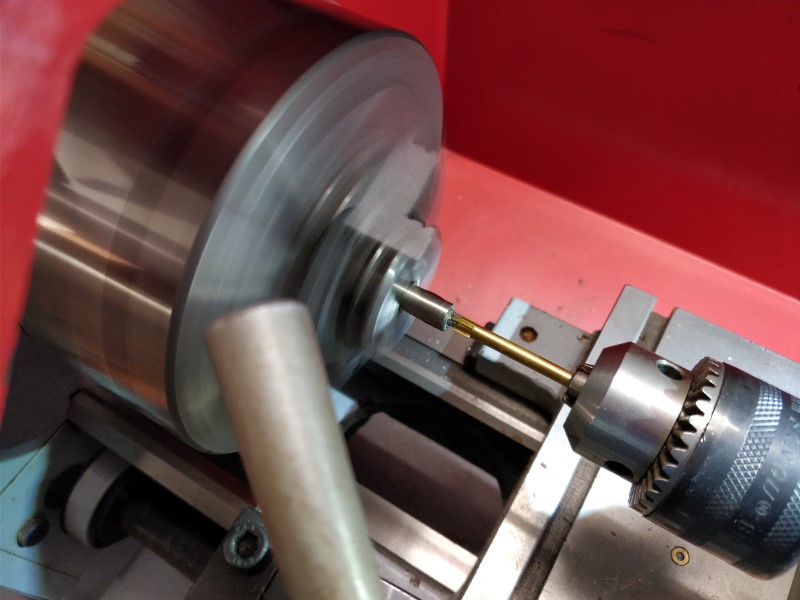

The tool is very simple, it's formed with an HSS bar drilled with a hole at the end.
Here are the photos :
Drilling the HSS bar with a carbide glass drill bit. Works like a charm !
http://www.labellenote.fr/file/homem...Boule_0001.jpg
http://www.labellenote.fr/file/homem...Boule_0002.jpg
http://www.labellenote.fr/file/homem...Boule_0003.jpg

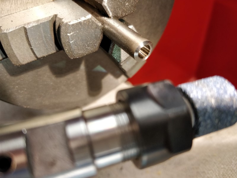

Beveling, making a cutting edge with my high speed motor on the tool post.
http://www.labellenote.fr/file/homem...Boule_0004.jpg
http://www.labellenote.fr/file/homem...Boule_0005.jpg
