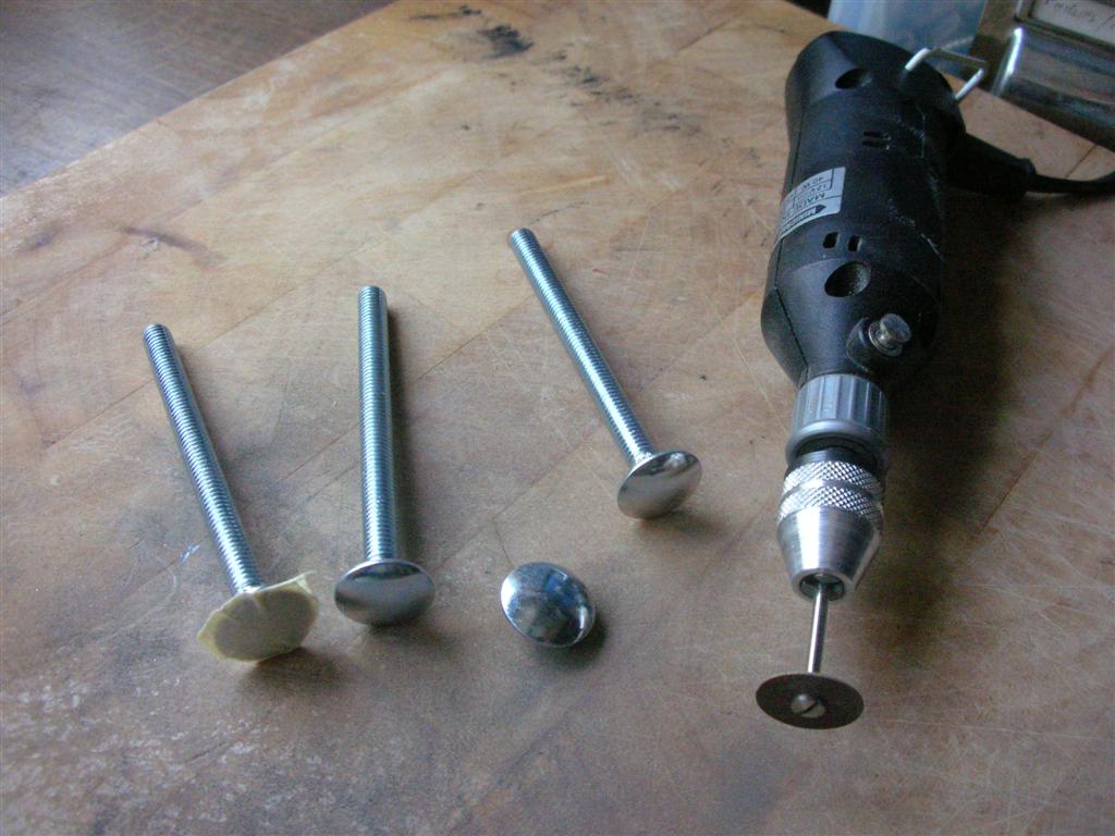

Attachment 7326
In the process of looking for a picture I found these
