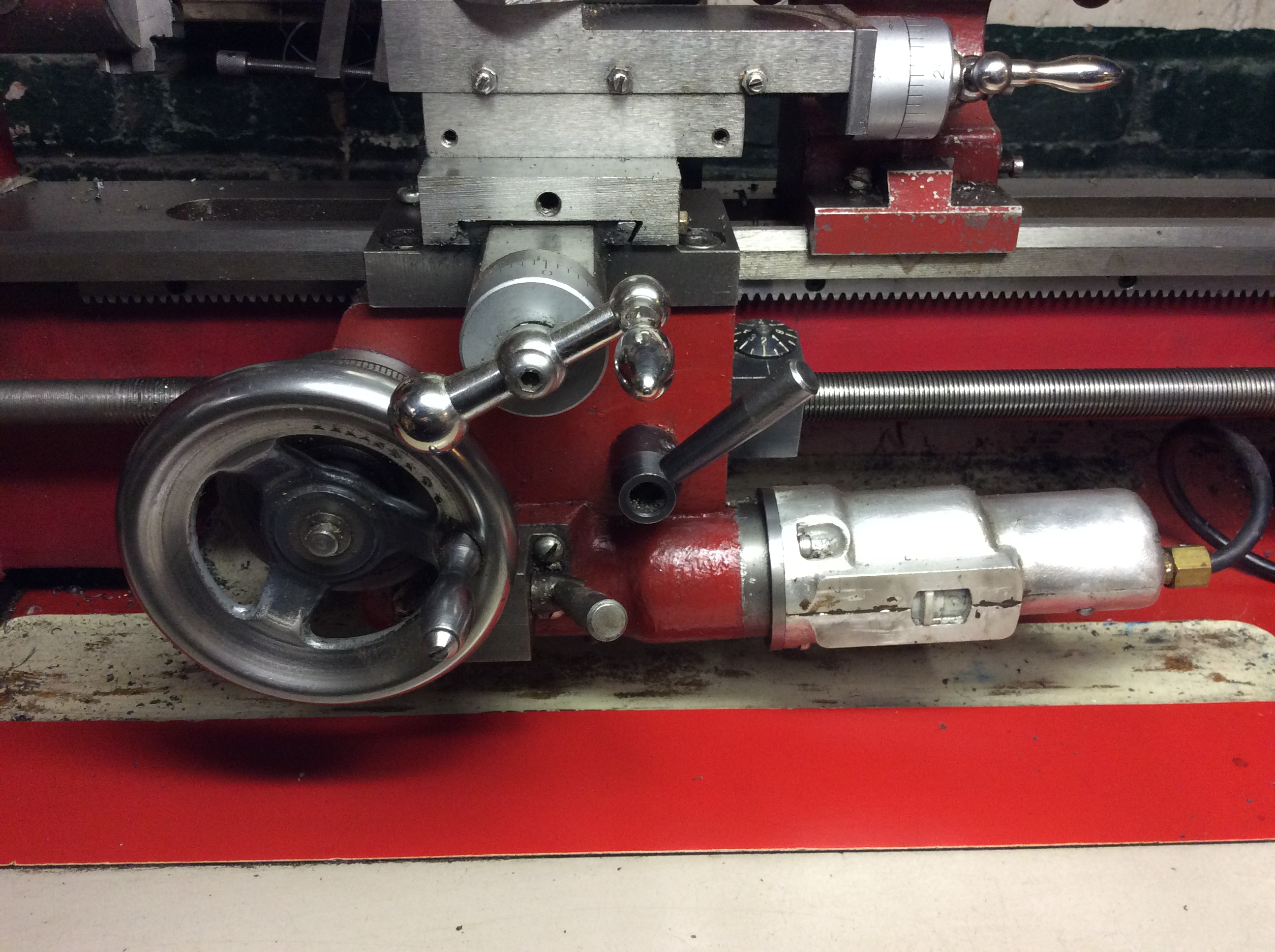

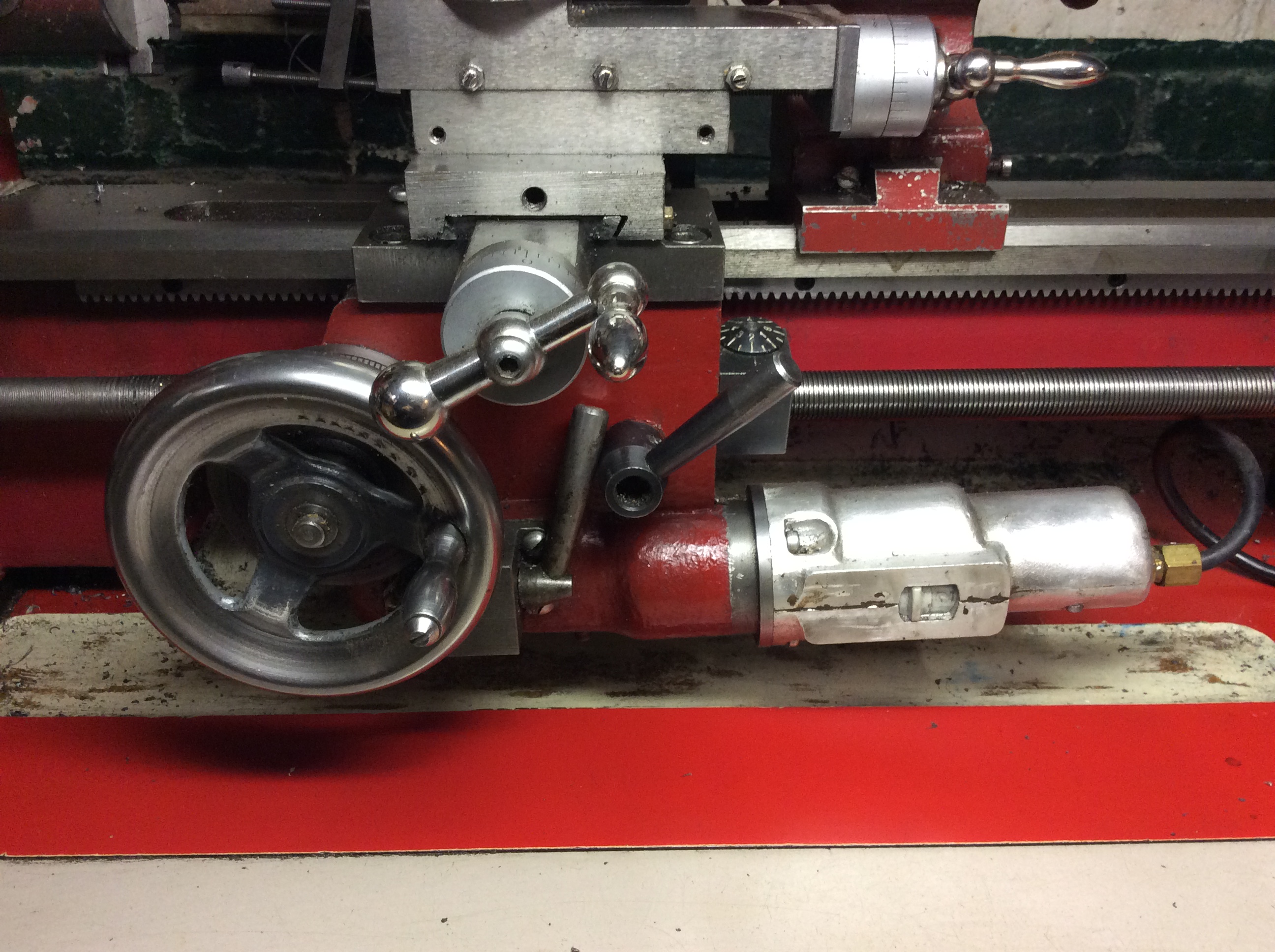

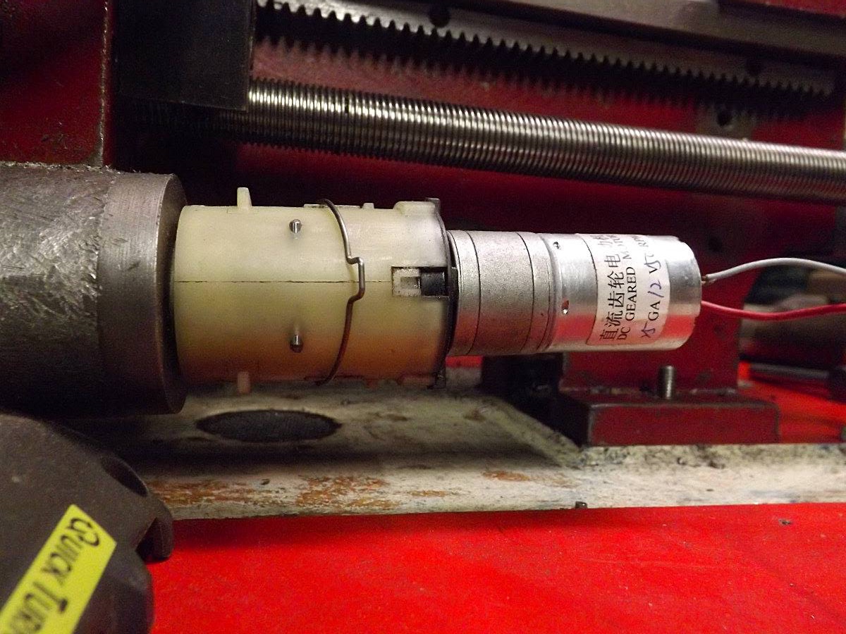

    This is a variable speed feed drive I made for my old 7x10 that’s now on my 7x16. It kind of looks like what’s on some Hardinges but is smaller and cruder and only works in one axis.

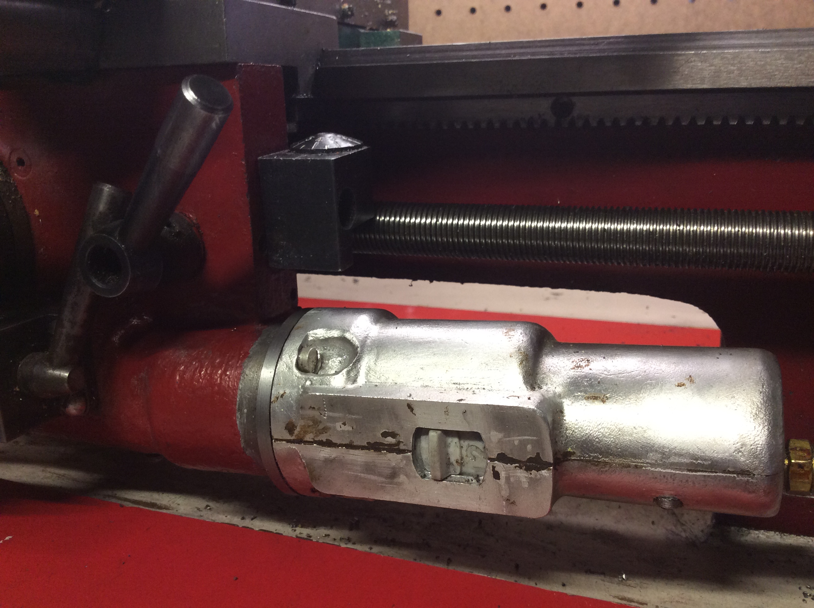

    Like the Hardinge apron feed it’s powered by a dc gearmotor and works using the hand feed rack instead of the lead screw. It has two speed ranges, I think up to only 3 or 4 ipm, I bought a faster motor to improve this but haven’t installed it yet. It engages with a lever operated cone clutch which I can set to slip when the carriage hits a bed stop.
    It works pretty well and is strong and easy to use but without cross feed isn’t very practical compared with straight forward lead screw drives like Varmint Al’s ultra-fine power feed and jjr2001’s slow speed feed for the mini lathe, or even some kind of stand-alone stepper or servo-driven synchronized system like John Dammeyer’s “Electronic Lead Screw”, and different similarly named, mostly Arduino controlled projects based on the same principles. The modified apron probably has twice as many bearings and gears as the rest of the lathe.

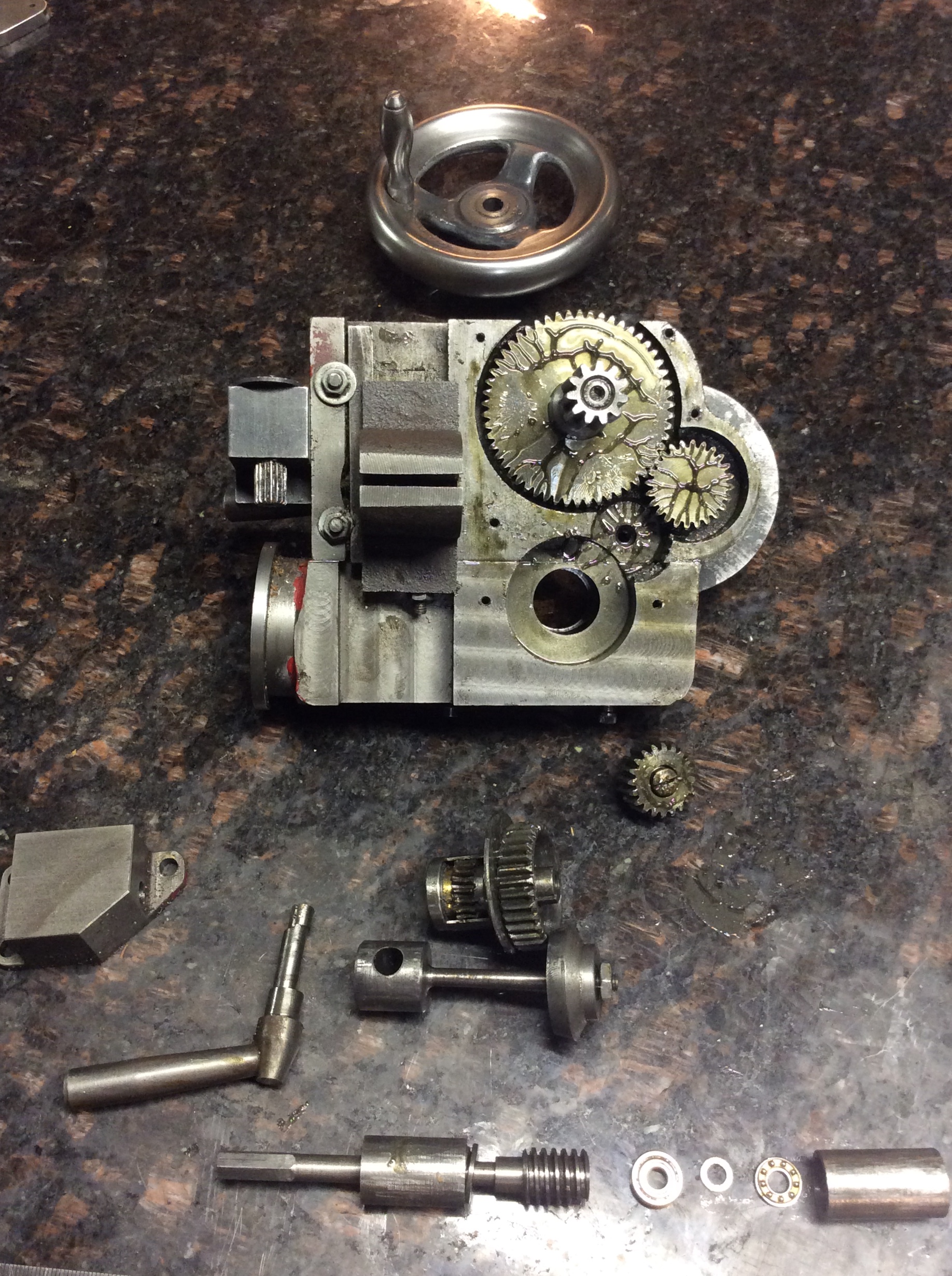

    I used a 500 rpm gearmotor, a 2-speed planetary transmission from an electric screwdriver and a 20:1 worm gear, with a couple of gears to mesh with the regular handwheel drive.

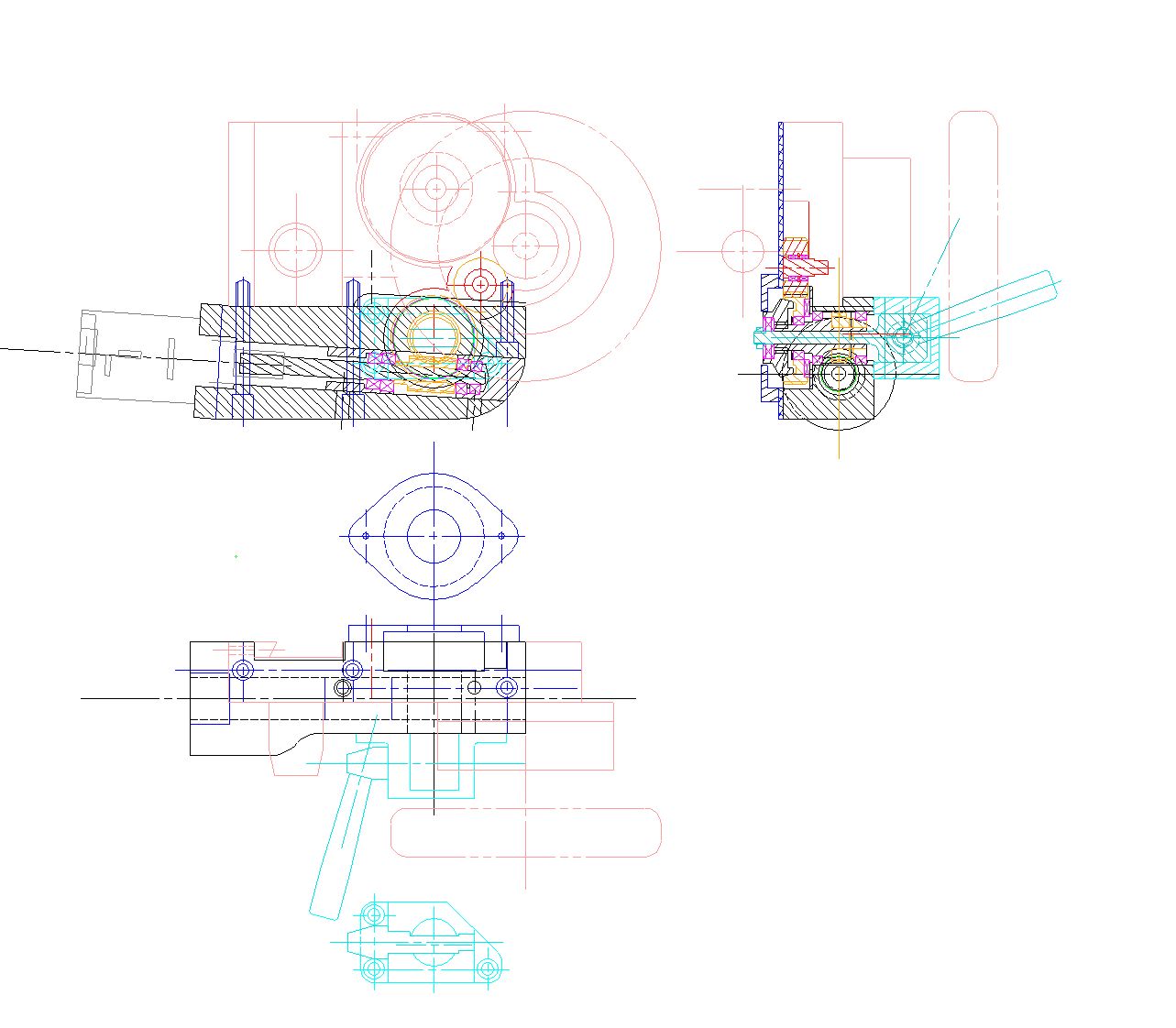

    Quite the build Threesixesinarow! The complexity and spacing of the gearing is terrific and by the video relatively quiet. Also liked you took the Hardinge approach and being closer coupled. Particularly interested in the add on to the apron, as it looks like cast material? Did you weld or bolt it then machine the recesses? The CAD drawing is a bit complex to read but get the picture of fit up and the long shaft on the motor is similar to a motor I pulled out of a coffee grinder. Are the gears off the shelf?

    The noise is mostly from the cheap gear motor I wanted to try first before buying something less familiar like a small stepper. The home made extra gears are about the same size as mini lathe change gears but with some extra details - the bigger one is part of the clutch.
    I made the bottom extension from a left over rectangular piece of cast iron bar stock. The working parts are packed in tight but drilling and boring the interior was pretty simple, and the outside texture that seems to help with painting is just from a carbide burr in a moto-tool with a loose front bearing. It’s attached with three bolts, which you should be able to see in blue on the side view if you click on the drawing when it’s displayed in the lightbox.

    I can see the bolts now and still think it's a bit tough to get all the gear centers correct for proper mesh. Have considered bushing the wheel/rack gear and the other to reduce the lash mine has. Nice hand wheel you have! Shimming the rack and apron gets pretty decent mesh with the rack and a rework of the half nuts does wonders for engagement.

    I wonder if they’re purposefully made so gears can’t ever bind despite loose tolerances - in any case, I did a lot more to tighten up backlash in the gears than any of the feed screws on my 7xes.
    For making only one it just takes careful measuring and planning to get the right center distances.

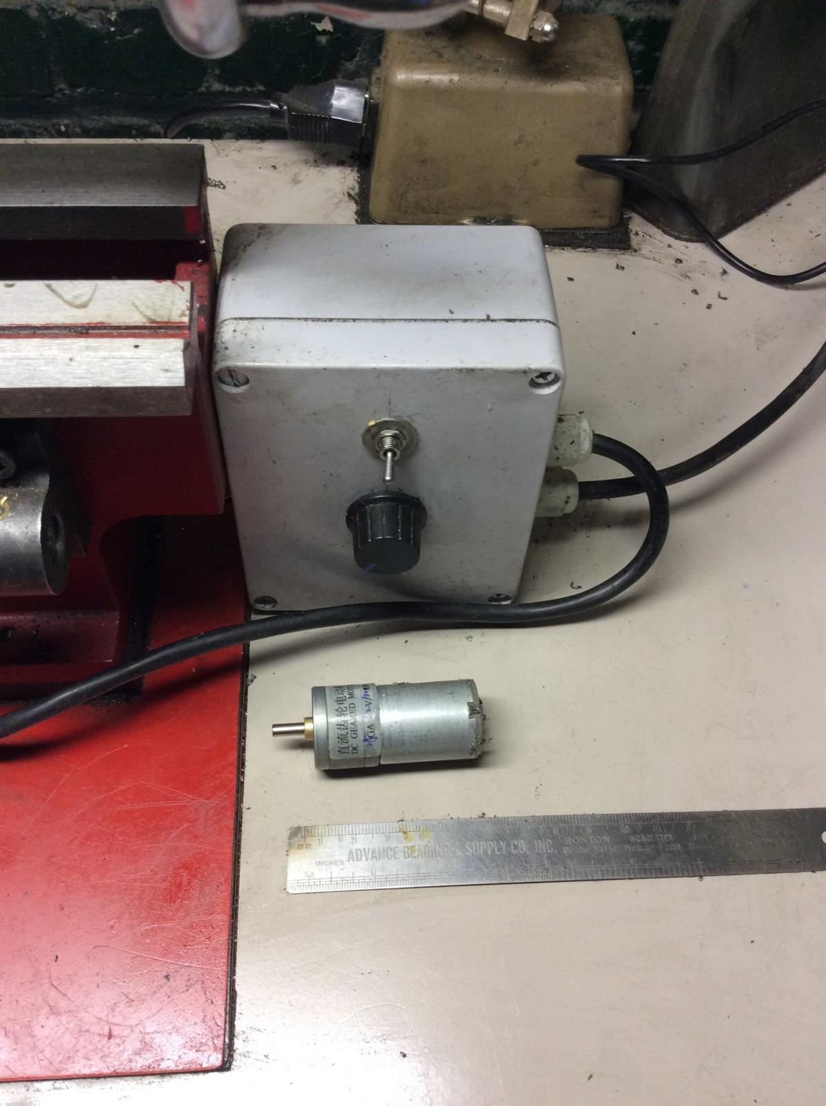

    Speed control and new motor:
