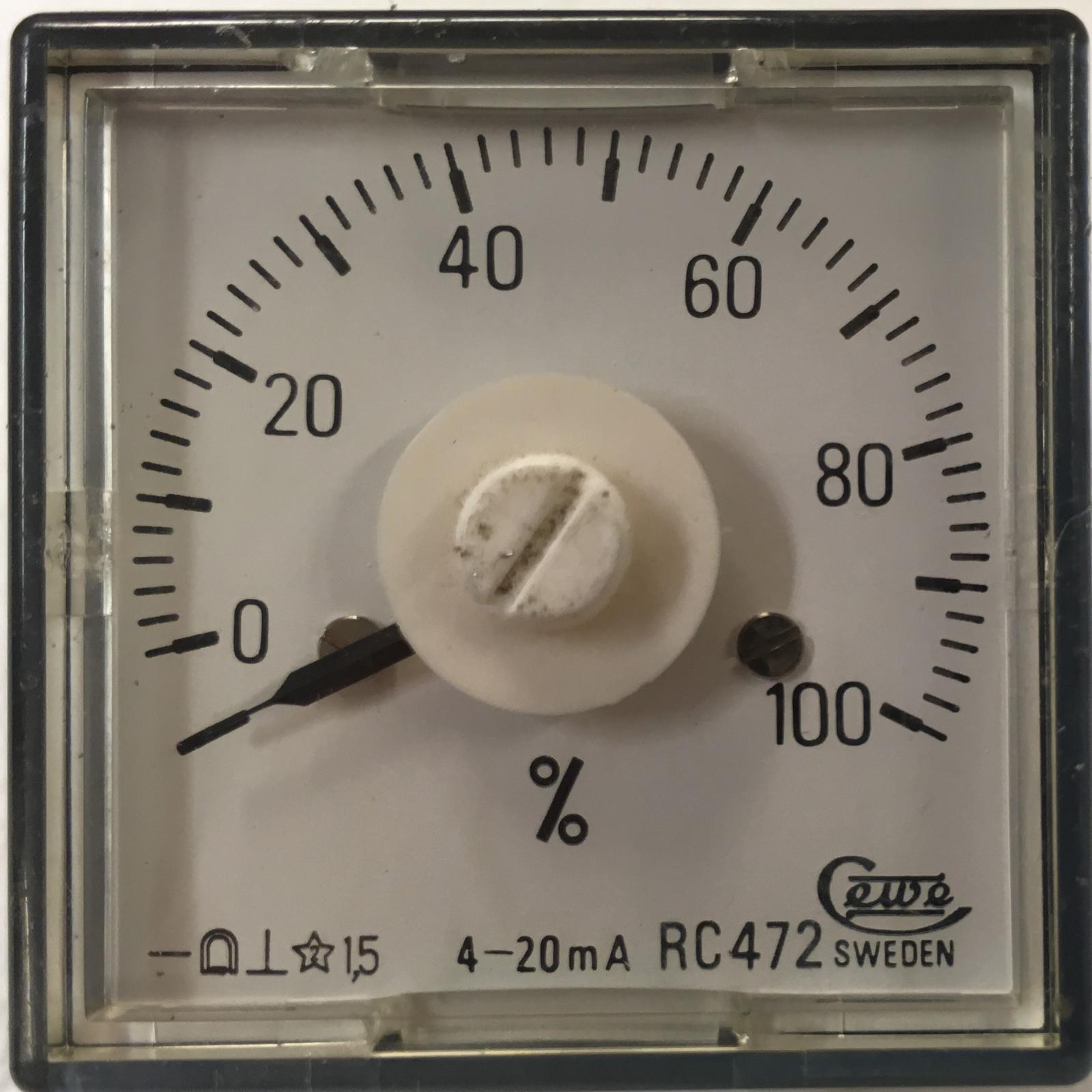

At the same time I had some luck in finding two of these in the electronics recycling dumpster at work:
Attachment 29792
As you see: a 1,5% 4-20 mA industry standard panel ammeter from the seventies with a 49 x 49 mm front.
Great brand, still around and used in power plants over here and a 5% one could even be had today for some 125 bucks.
Sheer luck got me two for free, with better tolerances than store-bought ones.
Thinking it would be great to also be able to have a "quick visual" (apart from just hearing) of the motor's loading when turning.

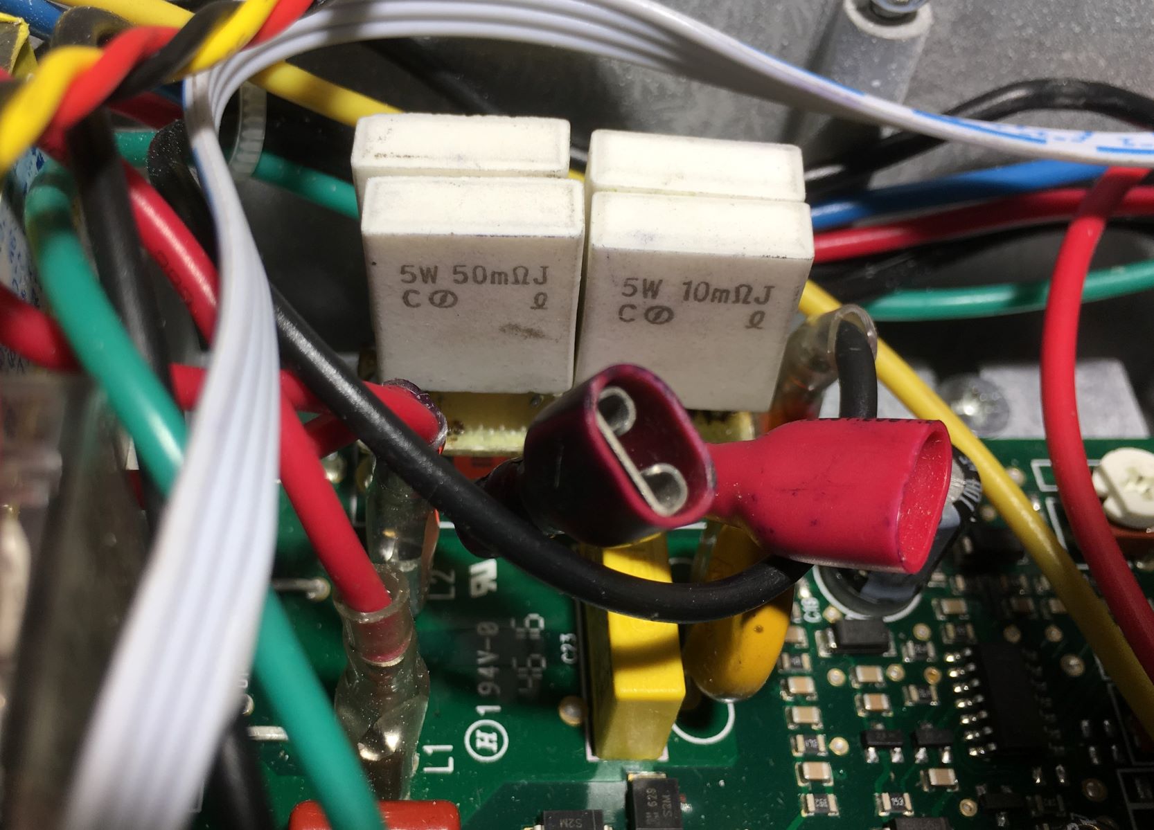

Board manual* instead states (for a ¾ hp/ 550W motor) a resistor of 0.035 and a 150% CL trimmer level,
where 100% is the nominal 3.3 Amps @ 180 V armature voltage.
Not having such a resistor – I checked my electronics stash and found a coupla used 50 & 10 milli-ohm 5W ones:
Attachment 29973
When soldered in series-parallel (on the board, instead of the original 0.1 one) they got me the right resistance of 0.030 ohms.
The open connectors will be explained below

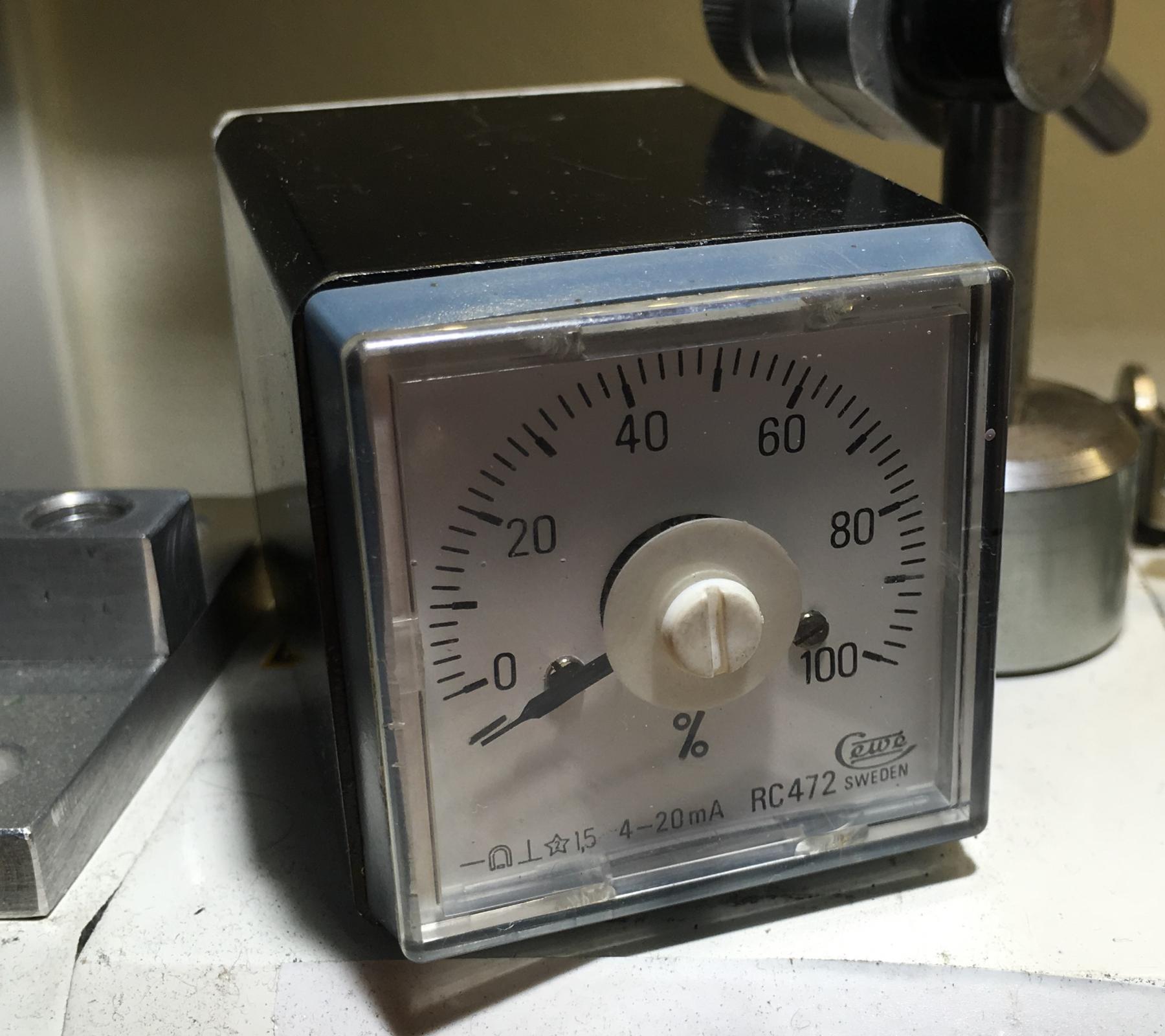

So this is what it looks like today, sitting on top of the headstock:
Attachment 29793
Meter put in a piece of 50 x 50 mm hot rolled box tubing, sprayed black with two magnets glued at the bottom,
and fitted with a plastic rear end with a cutout for the cable.

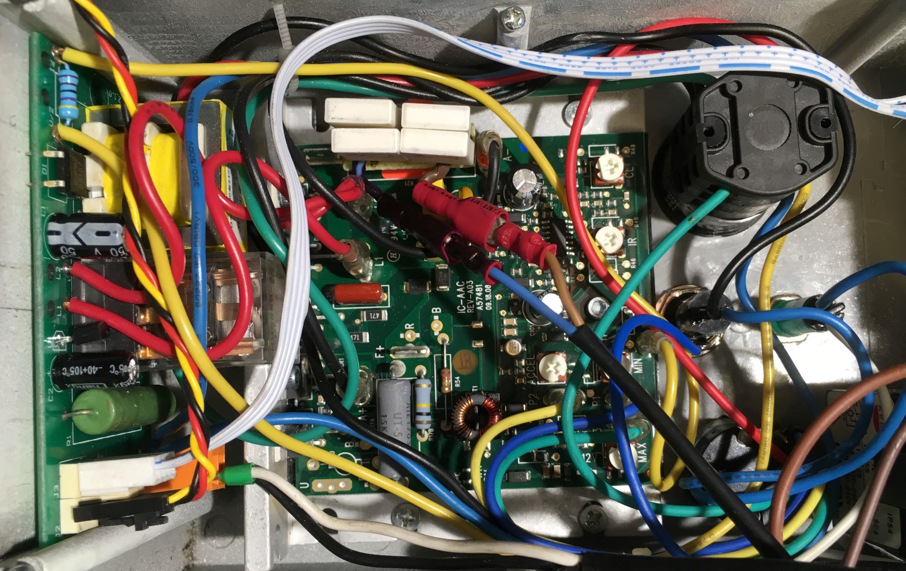

The internals of the control box: HP resistors top centre, then Ammeter cable (max 400VAC) via extra connectors:
Attachment 29972
Caution: -Though this cable doesn't conduct high current, it is at live voltage, and should thus be properly insulated and installed
(tip: nicely fitted under the cable shield running up to the Chuck guard breaker).
