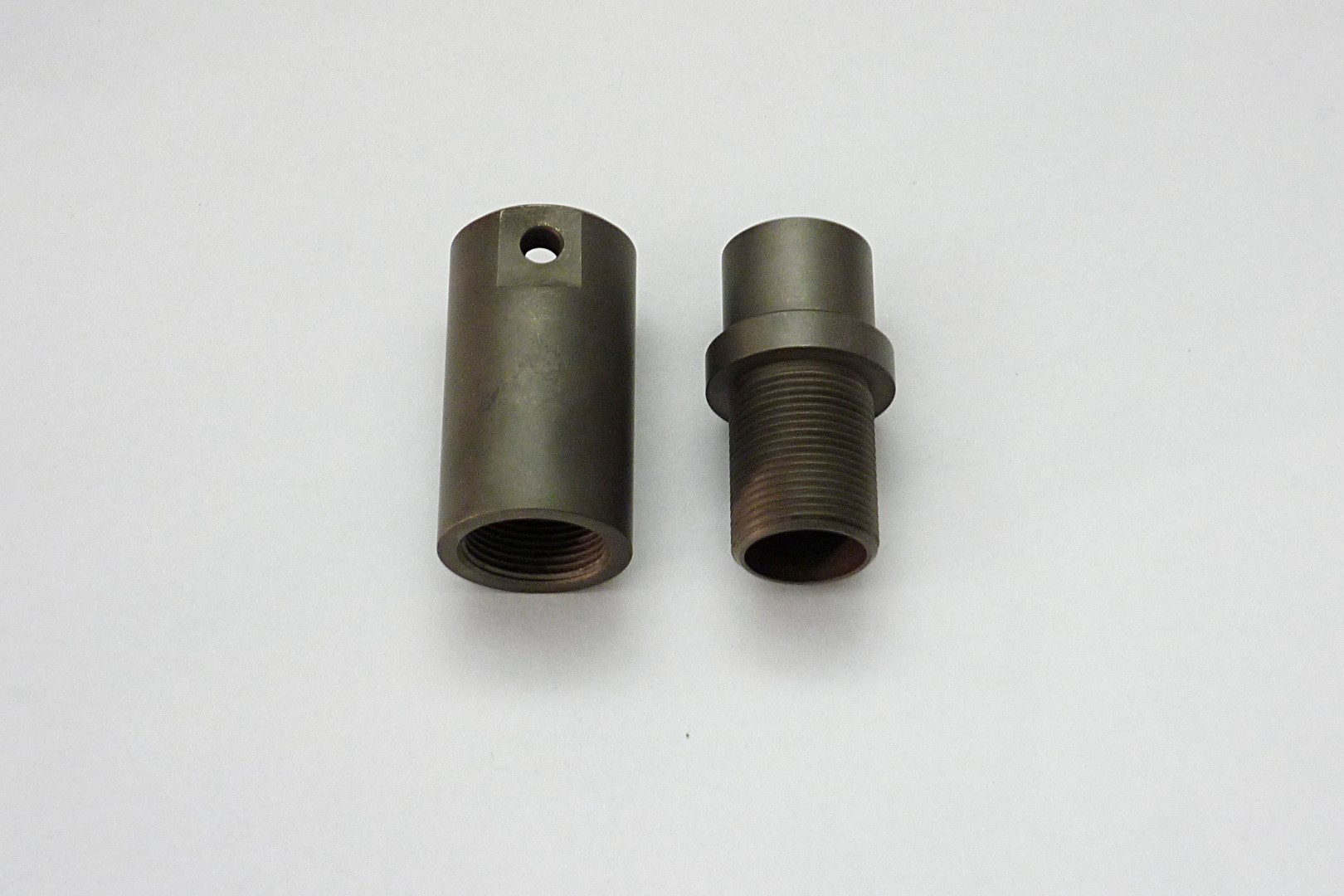

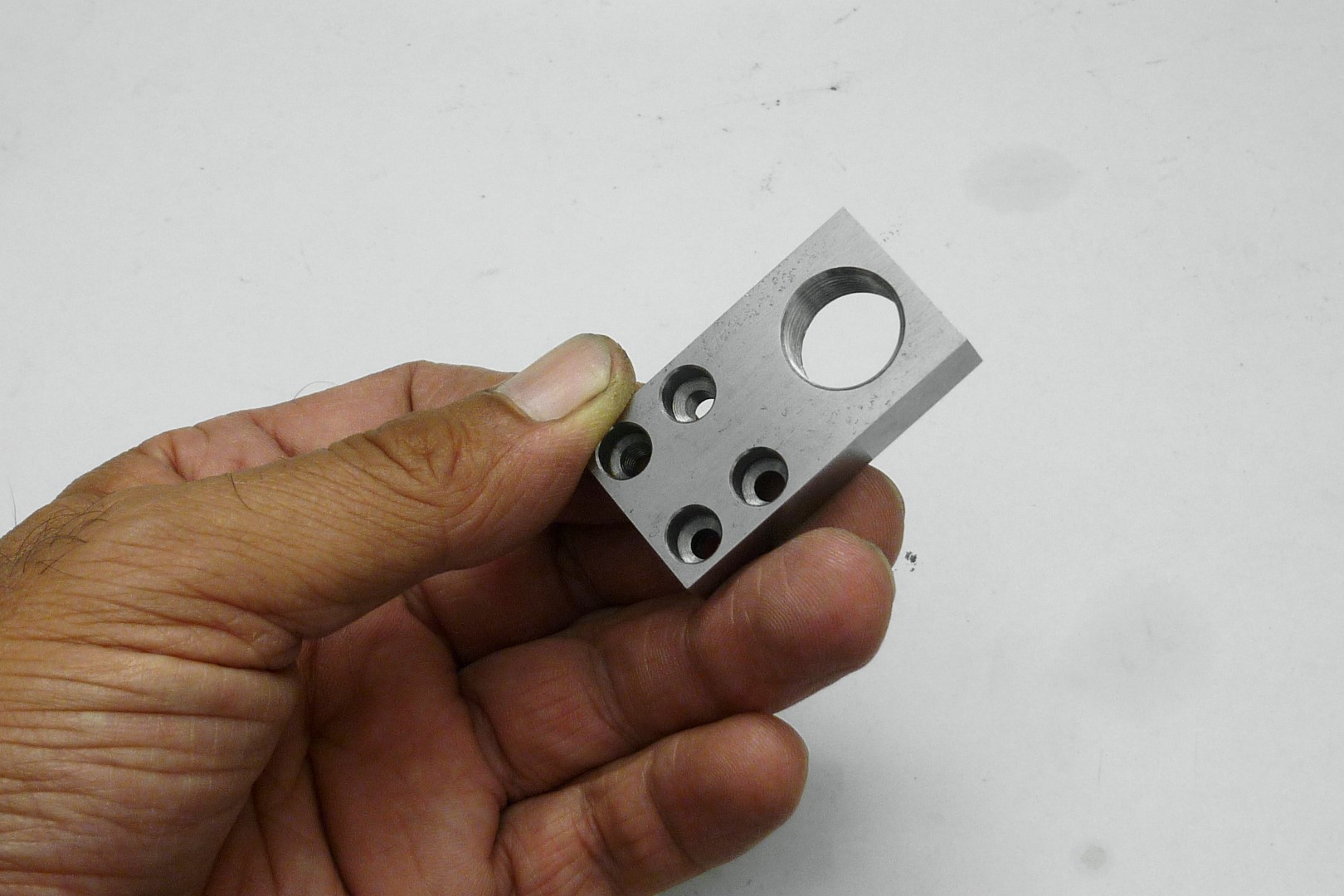

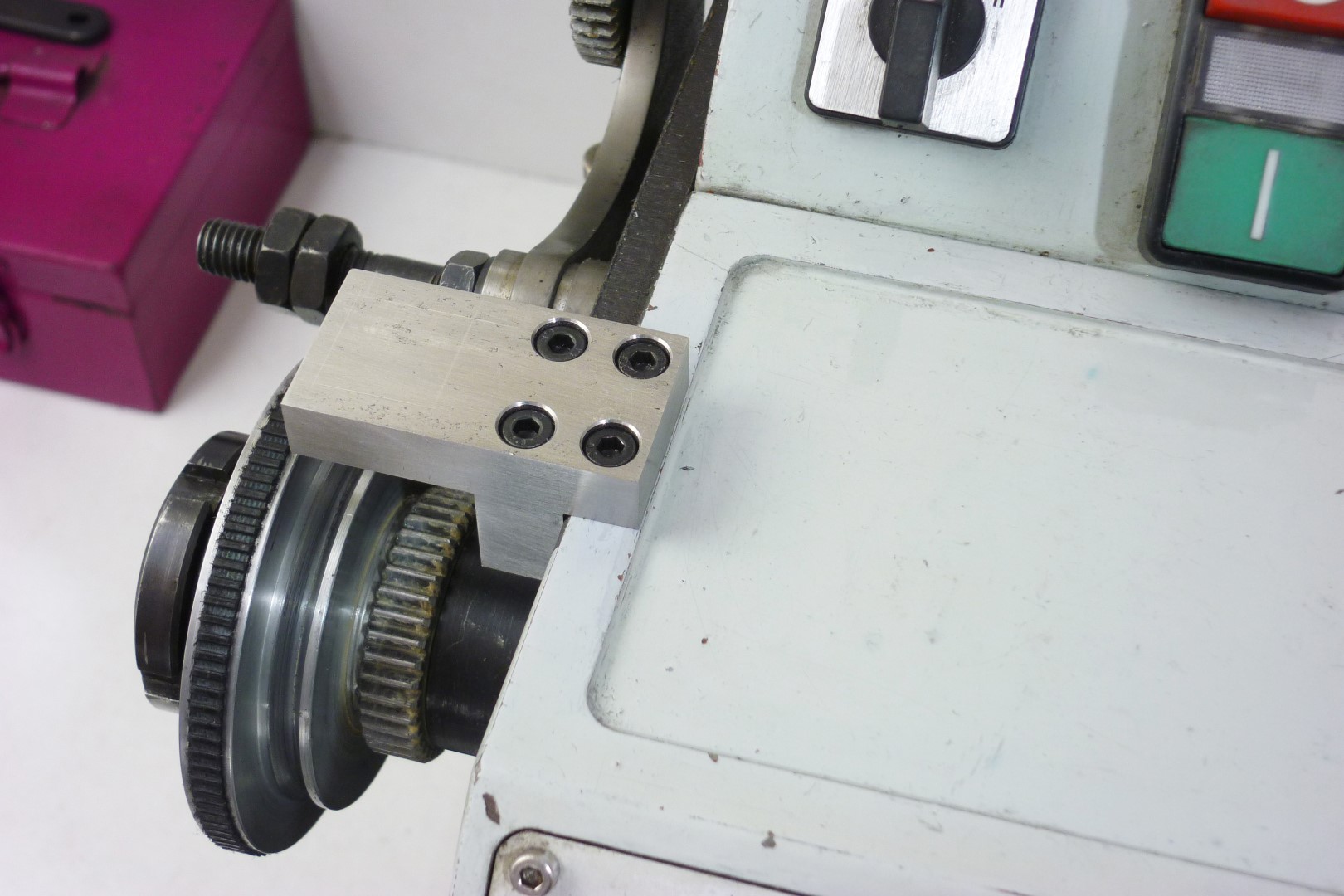

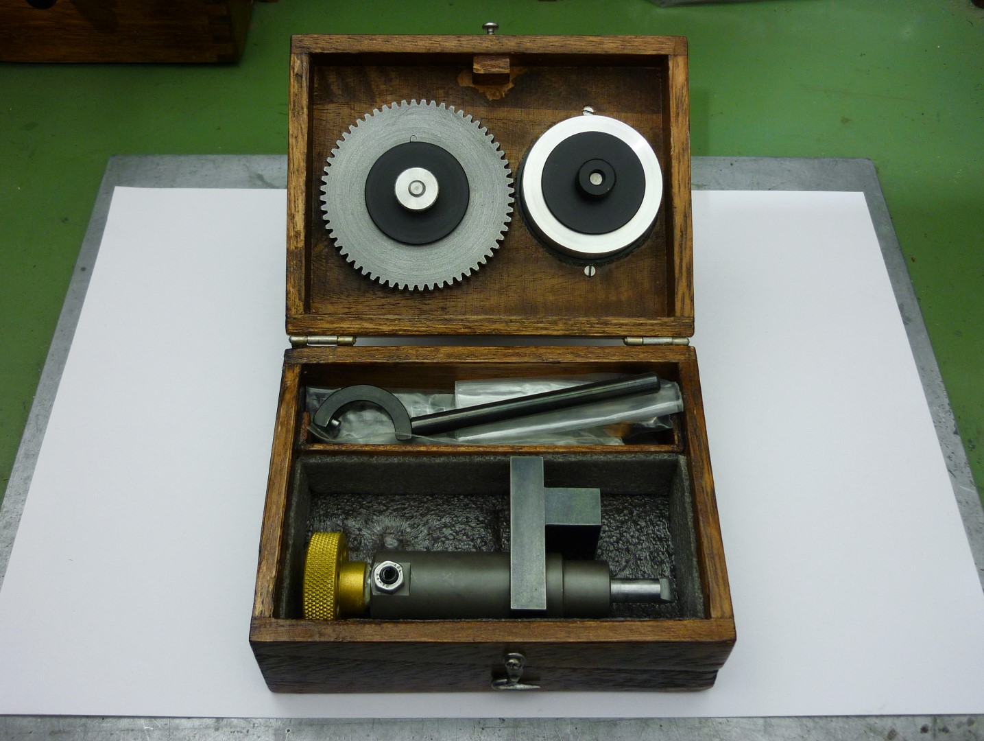

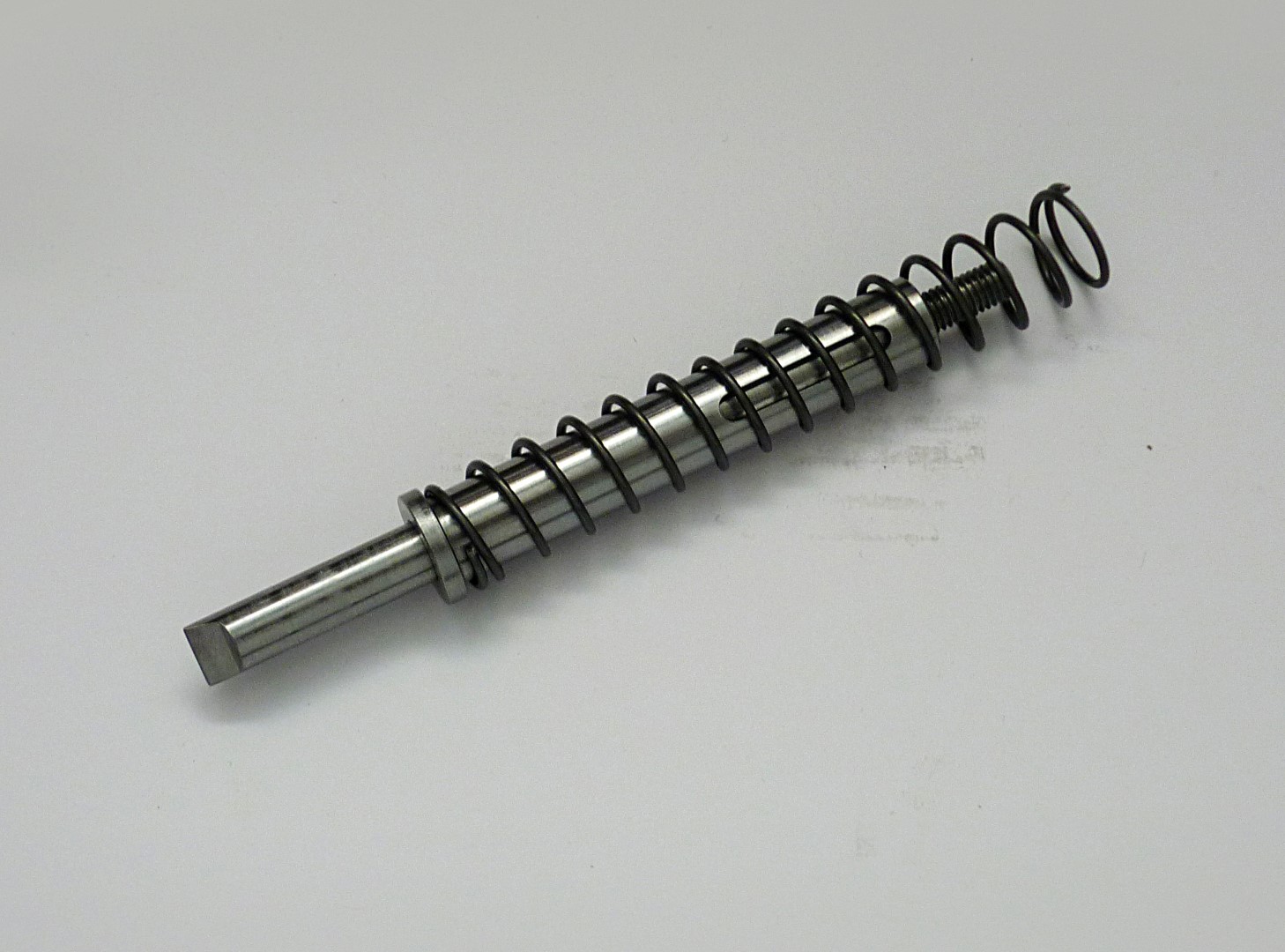

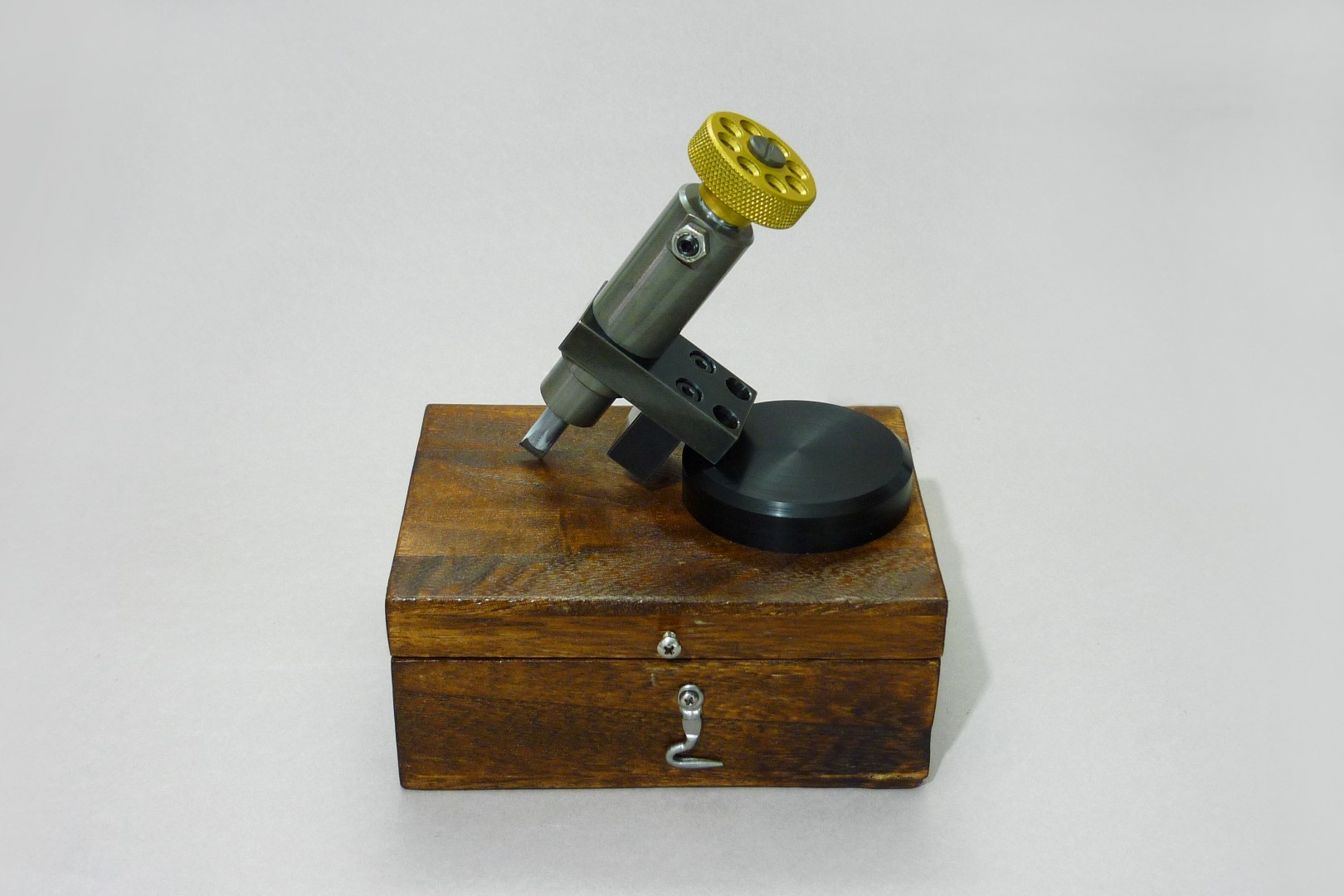

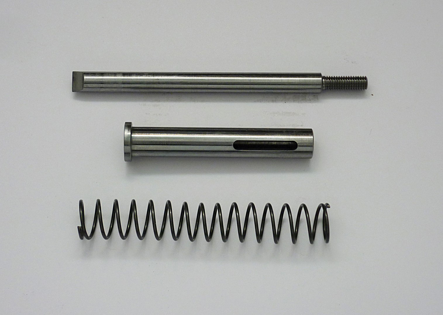

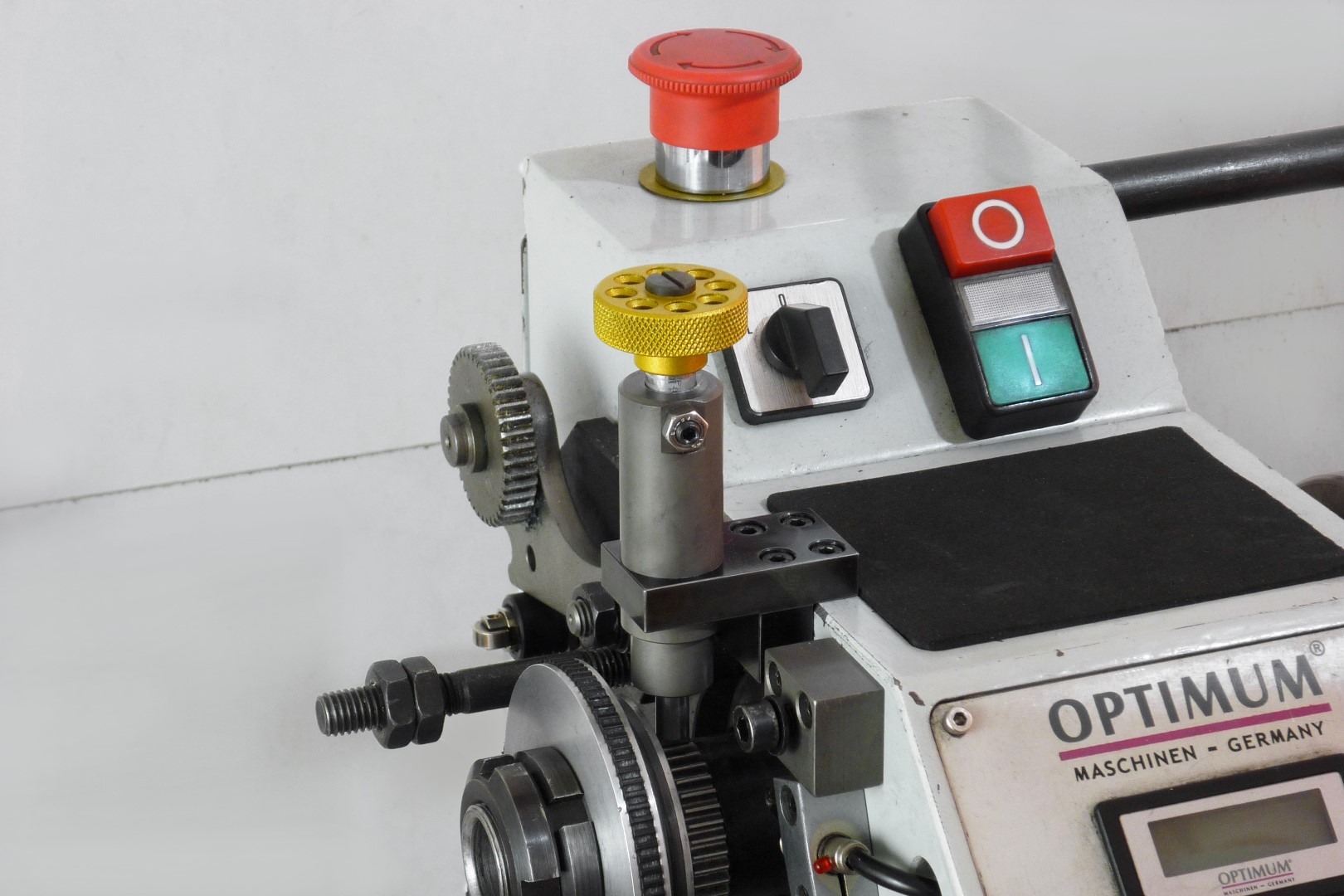

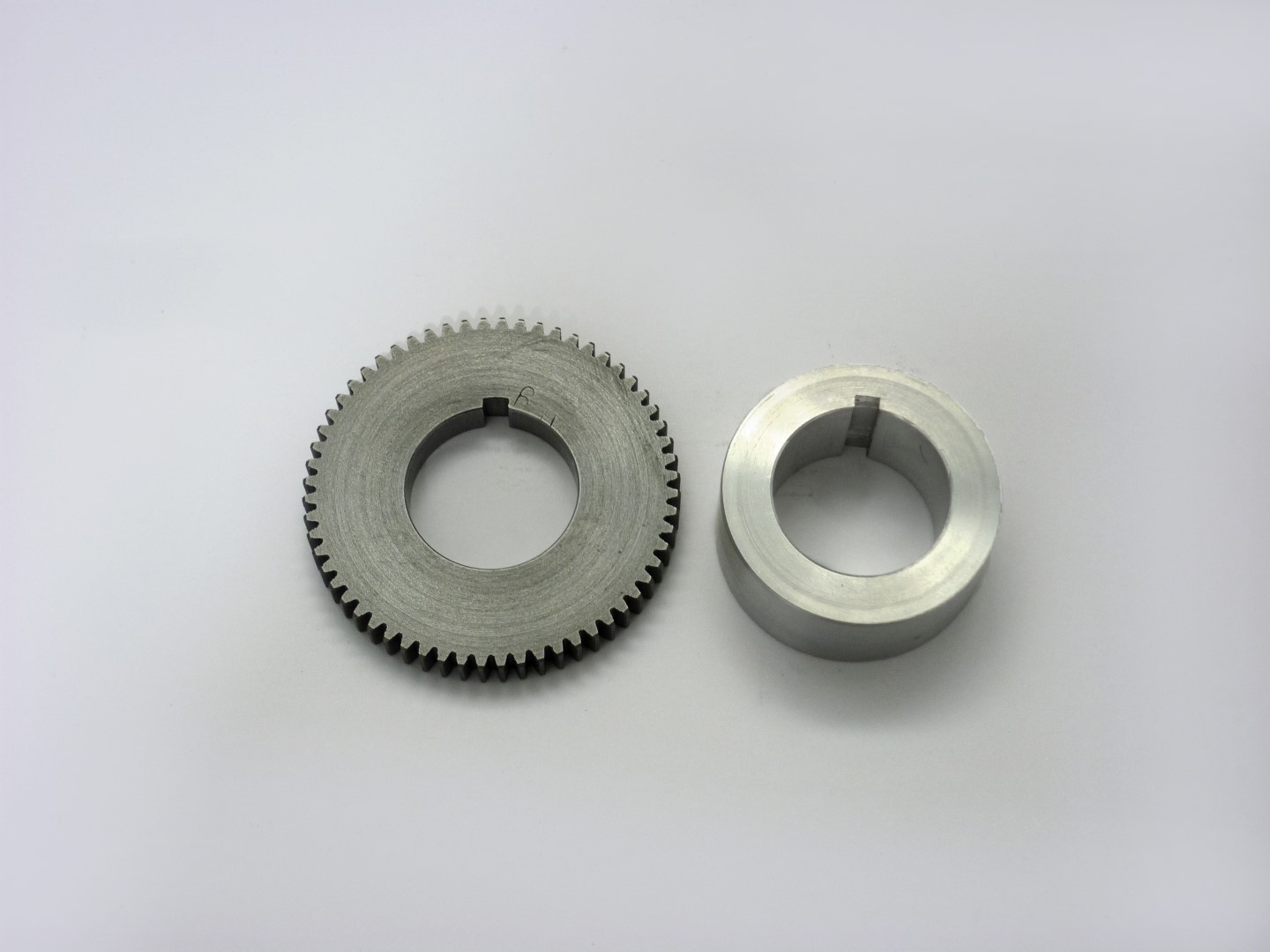

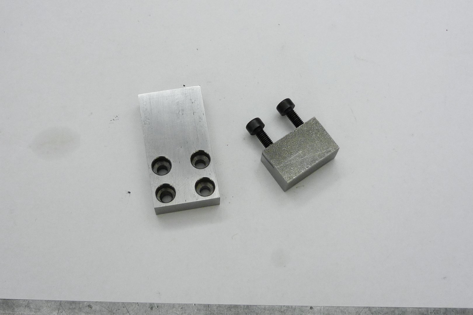

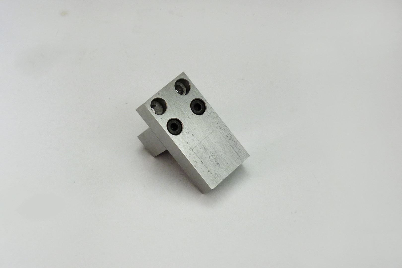

Hello all,
I would like to share with you one more of my favorite projects, the spindle indexer; it was on the project’s wanted list for quite some time now, I managed to finish it a few months ago and I’ve be using it in every given chance.
The tool is simple in design; it consists of an L shape base, a cylinder and a spring loaded moving plunger.
Attachment 28495 Attachment 28496 Attachment 28497 Attachment 28498 Attachment 28499 Attachment 28500 Attachment 28501 Attachment 28502 Attachment 28503 Attachment 28504 Attachment 28505
In the video you will find more information about the design and how the indexer works.
Cheers
Dimitris
