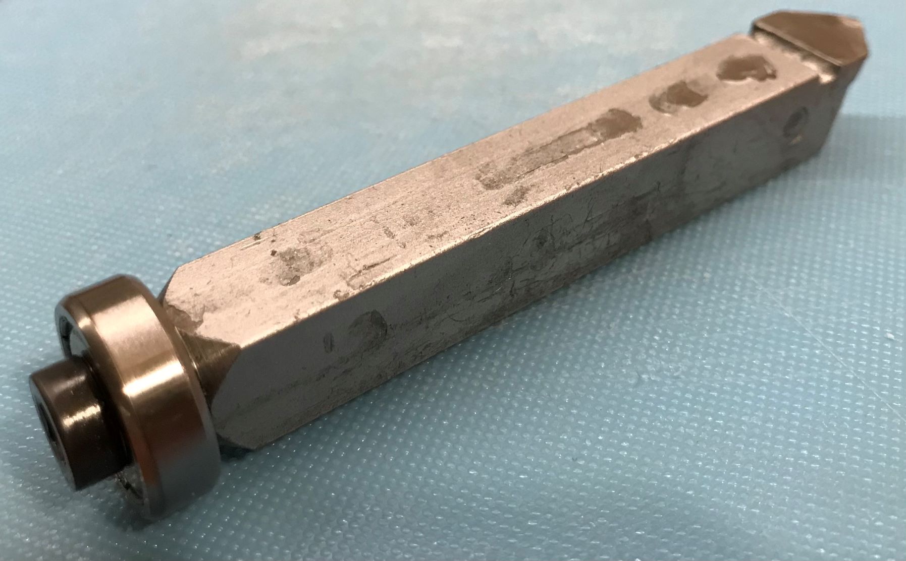

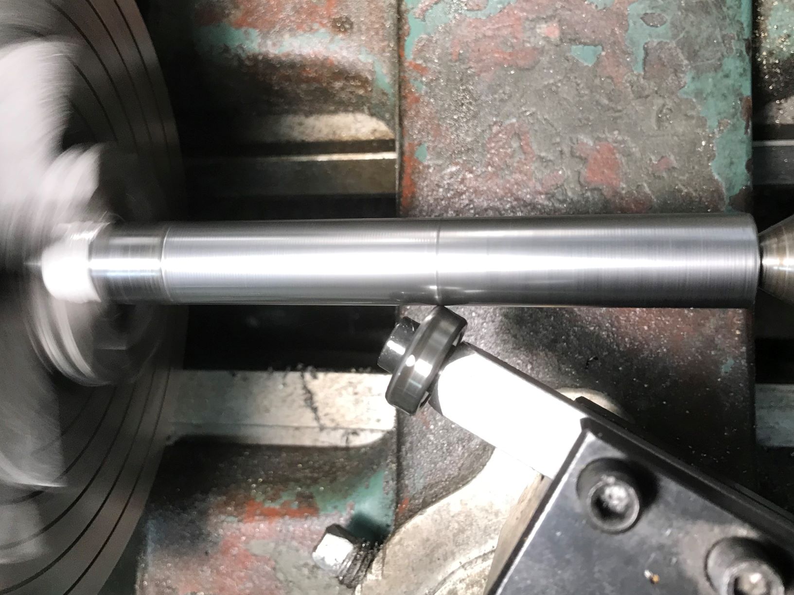

Today, for a really nice finish on coarse turned hot rolled, I first use a shear tool (a ground 8 mm masonry drill bit slanted 20 degs in a square holder), and then finish off by "cold rolling"/ burnishing the last 1/1000 of a mm, with a cheapo ball bearing mounted like so:
Attachment 41276 Attachment 41277
Über-fine feed & 1 krpm, infeed 2-3 thou for MY setup. Rust seems to not set as easily on it either (as it does on merely turned).
Originally "pimped" this odd-looking brazed carbide tool for truing pieces in the 3-jaw.
YMMV.
