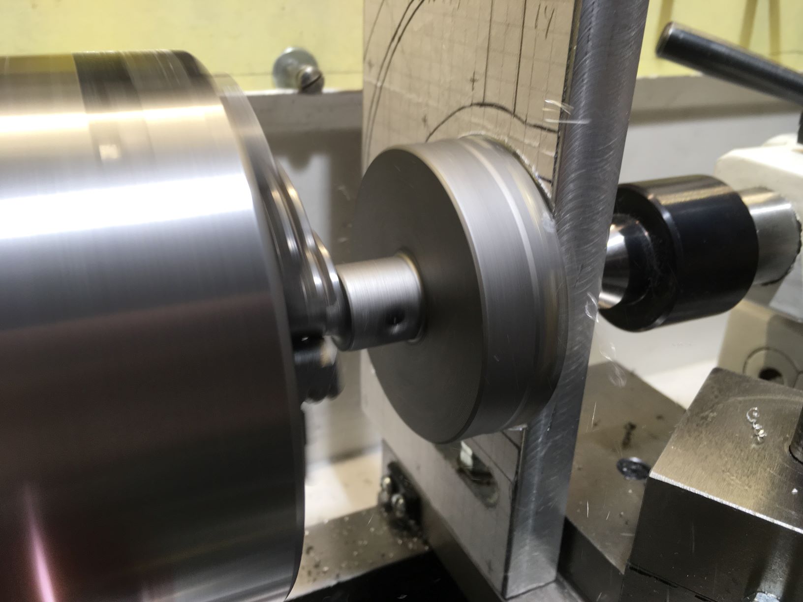

Center drilled, and mounted a 50 mm carbide hole cutter in the 4-jaw, and revved it to about 250 rpm, whilst spraying some methylated spirits on.
The lathe grunted at the load, and my installed ammeter flickered towards its top end, as I fed the plate by the tailstock quill:
Attachment 29769
Finished up the hole by chucking an adjustable fly cutter in steps to 60 mm, rinse and repeat.

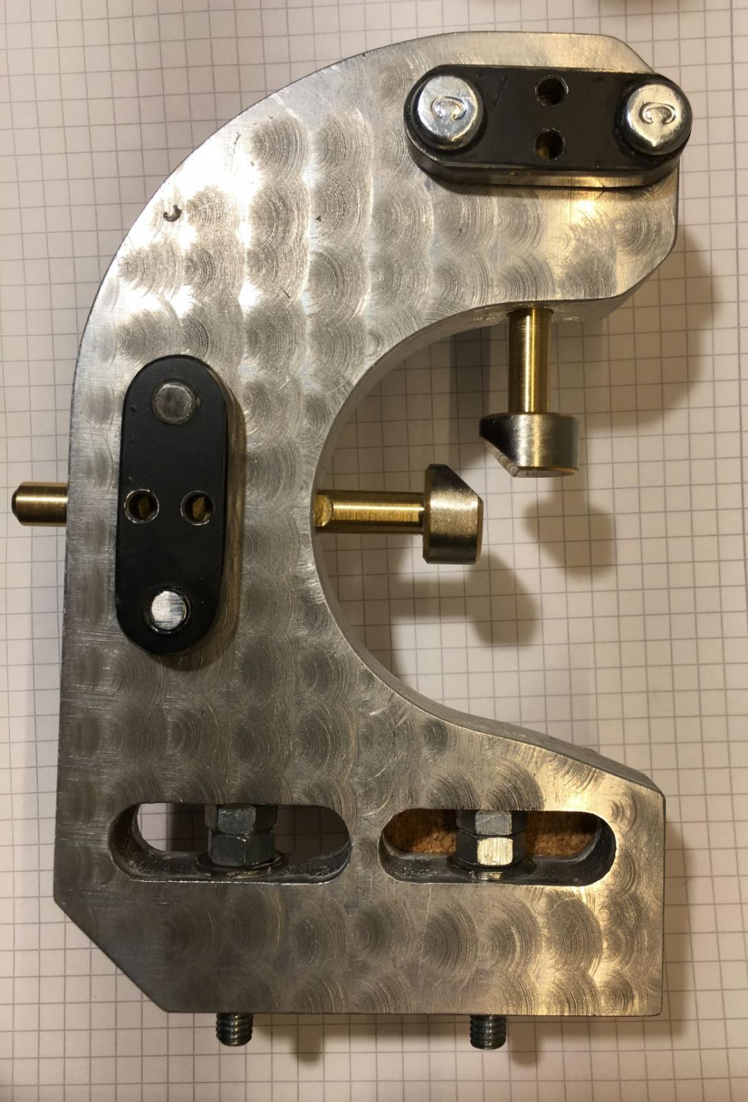

Attachment 29770 [Here a turned-over pic of same should've been, showing off the fancy-pants handles]

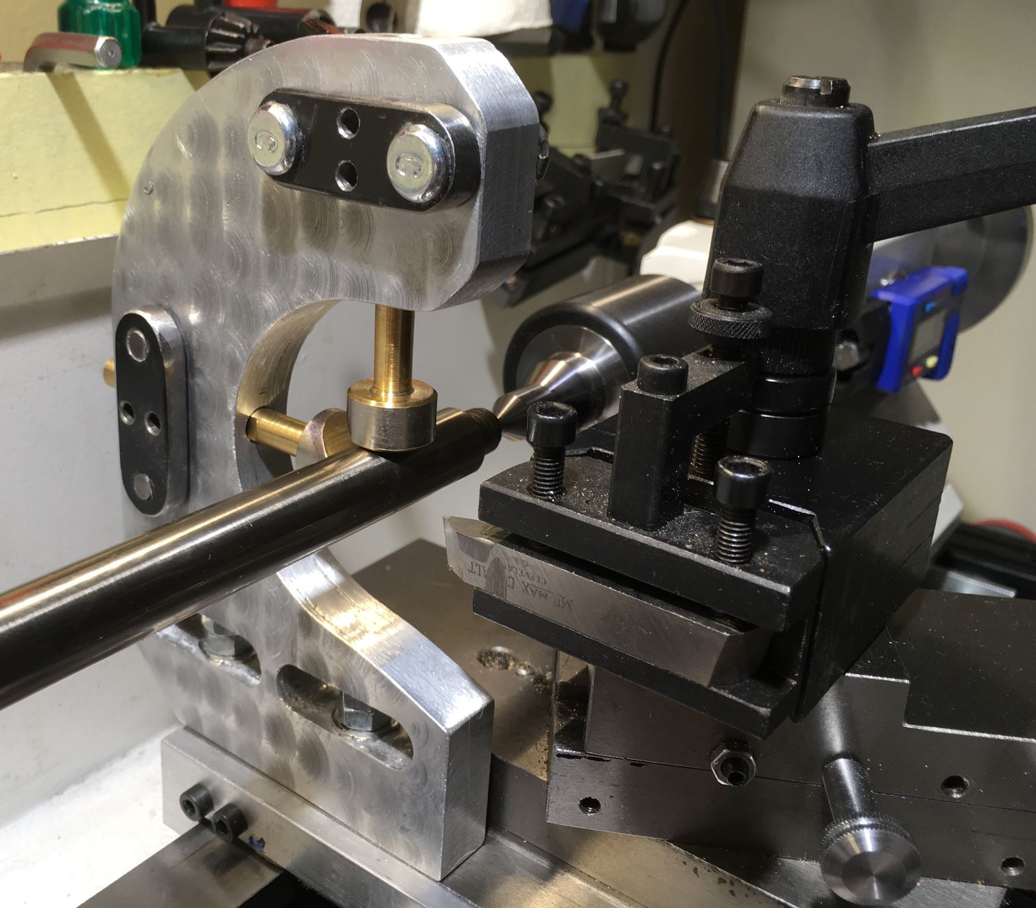

Simple to attach instead of my PC glass chip guard (good to have), easy to align,
and non-problematic in use - not even interfering with the lathe's real tight chip guard.
The wide brass fingers hold up well against chips/ swarf over time.

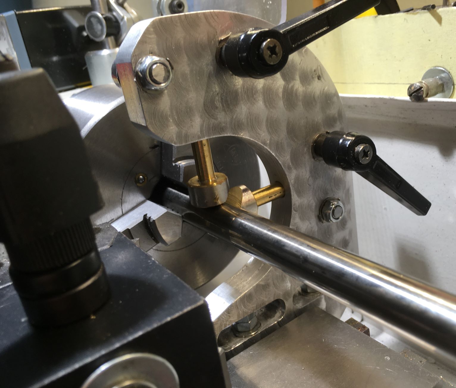

Setting the cutting tool before or after the fingers is easily done thru the compound:
Attachment 29771 Attachment 29772
At bottom of left pic you also can glimpse DIYSwede's WideWayWipers: extruded Al channel, cut, ground and drilled to hold a piece of well-oiled felt, instead of the chinese rubber squeeges seen in top pic.
