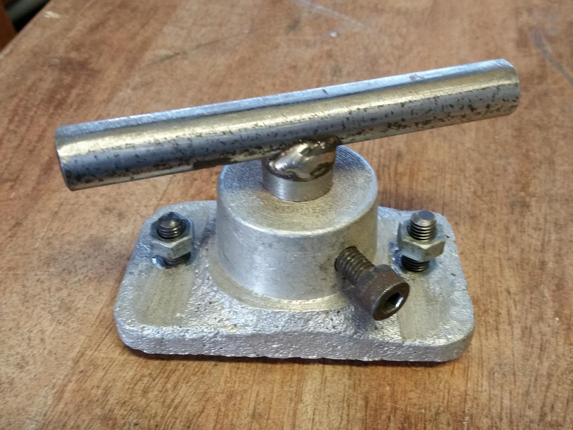

I just purchased a used Clarke 7x14 mini metal lathe. It appears to be one made by the same company that makes the Grizzly and/or Harbor Freight.
I'm going to take some training from a Machinist on it ... have zero experience! Just finished reading O'Brien's "How to run a lathe ..."
I do woodturning ... therefore I would like to have a tool post for it to allow me to be set up - when not doing metal -- as a station to turn pens using my EWT carbide cutters. Has anyone made a tool post for this size lathe?

Yes, it turns nicely, some years ago I turned several intermittent positive pressure valves from acrylic bars, acrylic is not abrasive. Regarding turning wood on a metal lathe, don't avoid doing it. We all use tool post grinders to precision grind round parts, covering the ways and compound with rags. Grinding swarf is much worse than anything found in wood, except, maybe industrial diamonds. I have been grinding on my South Bend 9" lathe occasionally for the past 67 years, with no harmful effects.
Since you are not generating red hot sparks, slightly oiled rags will do a great job of trapping particles, while lubricating the ways and compound. Just don't store oiled rags
bunched up, indoors, Hang them over something preferably outside, to avoid heat building up heat leading to spontaneous combustion. In the shop, oily rags are stored in a steel drum with a tight lid.
