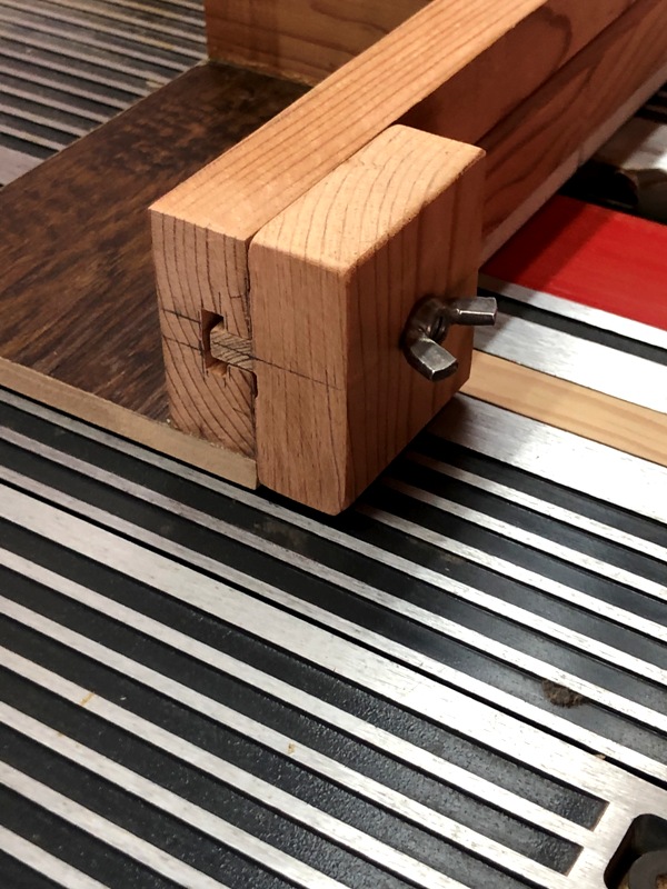

Table saw sleds are one of the most common and useful jigs in woodworking as they allow you to make precise and safe crosscuts or some other cuts on the table saw.
With the mini table saw sled it is possible to cut small pieces. The sled I present was inspired, with modifications, by these projects:

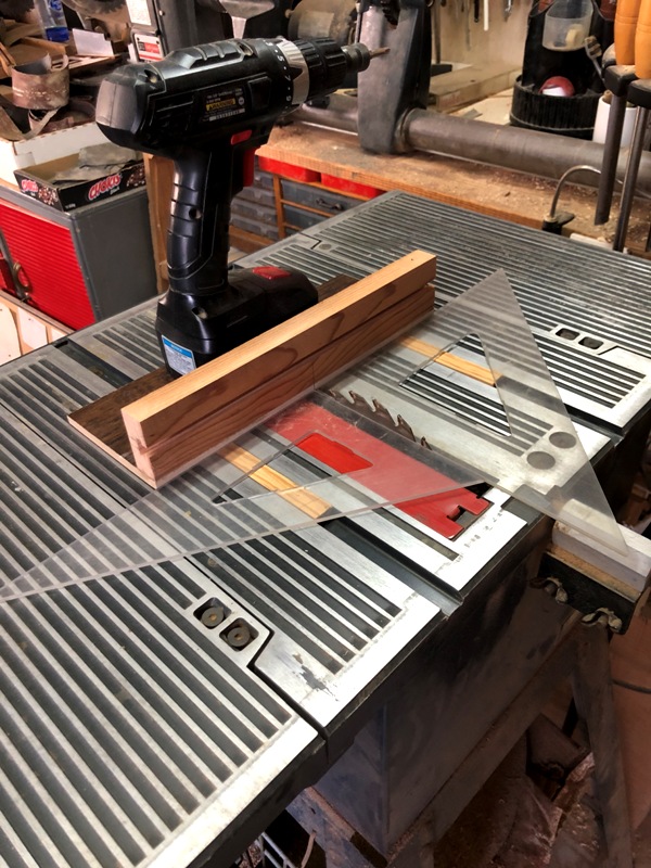

Aligning the sled perpendicular to the saw blade

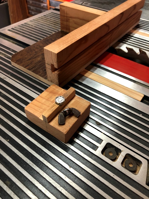

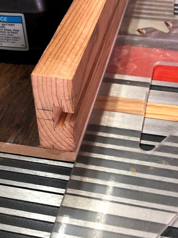

T-track made with T-slot router bit
Attachment 37650
Stop block
Attachment 37651
Stop block guide
Attachment 37652

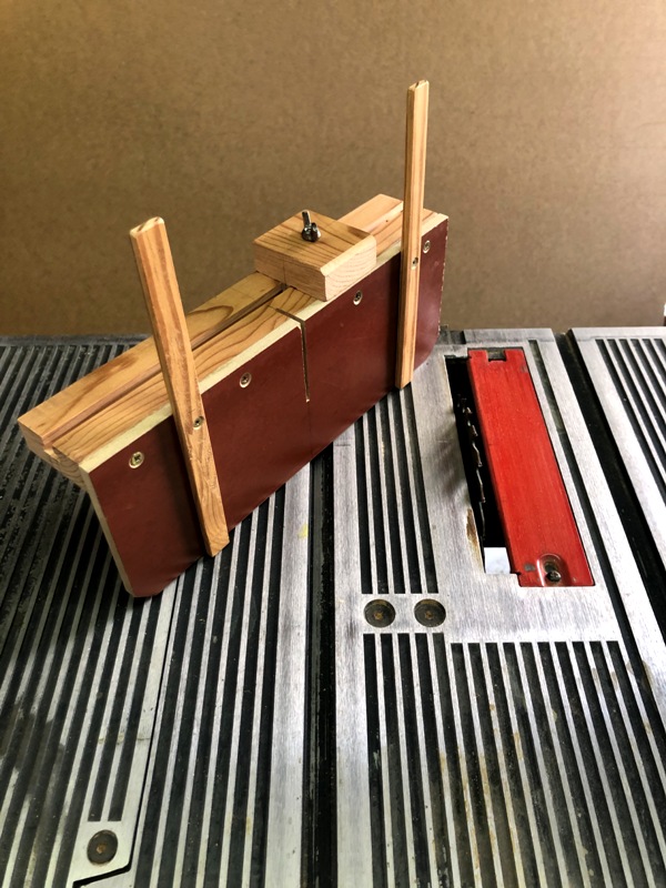

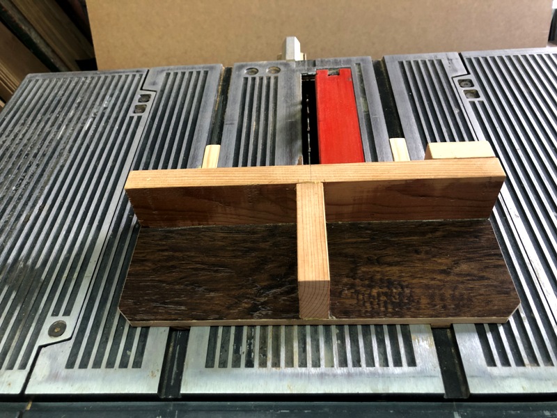

Base and runners
Attachment 37653
Blade cover
Attachment 37654

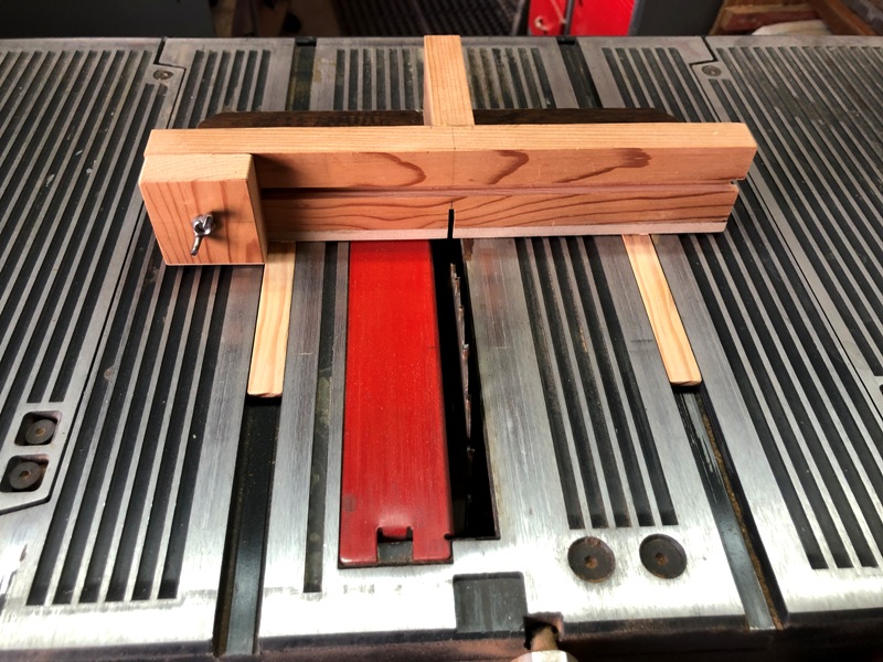

Front view of fence, runners and stop block
Regards.
