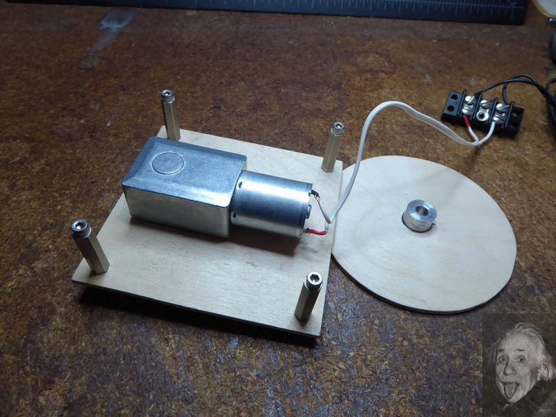

    I finally got around to building a miniature turntable which I intend to use for a number of applications (see below). This project was prompted by my discovery of this motor-gearbox combination...
    https://www.amazon.com/gp/product/B0...?ie=UTF8&psc=1
    which consists of a 1" diameter DC motor geared down via a tiny gear box to 2 rpm. The motor draws about 25 ma and, given the gear reduction, has lots and lots of torque. Being 12 VDC, I can run it indoors on a wall wart or outdoors on a 12 volt SLA.
    I built a small table to support the motor and a circular turntable with a fitting to attach it to the 6 mm gearbox output shaft...

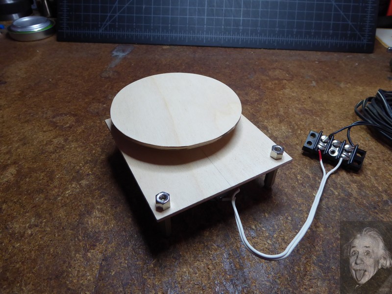

    Assembled the unit looks like this...
