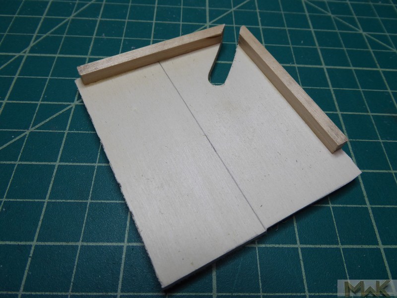

All of these conditions led to this design for a jig...
Attachment 49305
Two guide strips were glued to a scrap of thin 5 mm plywood. A machinist square kept these strips orthogonal as the glue dried. The area of the plywood where the miter joint will lie (regardless of the size of the mitered wood) was cut away. This guarantees that any joint squeeze out won't contact the plywood.

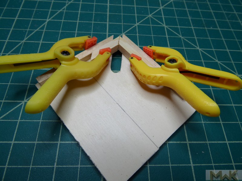

A picture of the jig in use will make things clearer...
Attachment 49306

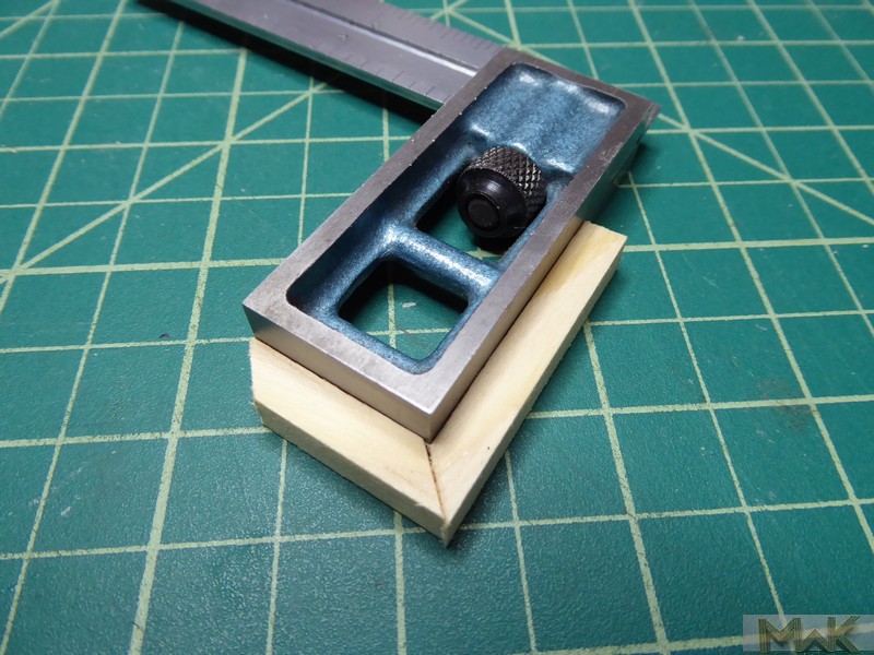

As this picture shows, the resulting joint is very nicely orthogonal...
Attachment 49307
