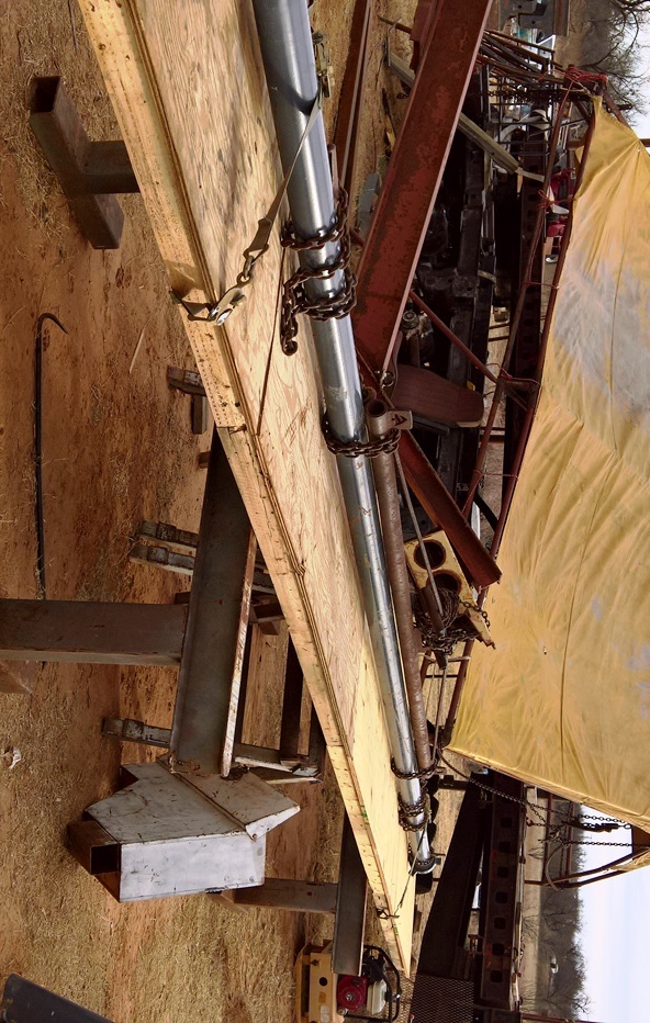

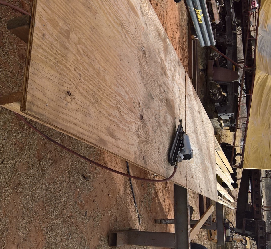

    I've gone as far as I can go on my platform for the school bus scaffold until I go to the lumber yard in the city and pick up a couple sheets of 3/4 plywood
    the platform will be 4 ft by 32 ft and I will lift it up in 1 piece with the backhoe the boom extension and the spreader bar

    Those appear to be 2x6 joists. I'm guessing your using 16', and it looks like your splicing them by pairing with another one in the middle of each splice.
    Are you using the nailer to attach the plywood to these joists? I've always used construction screws to assemble scaffolding.

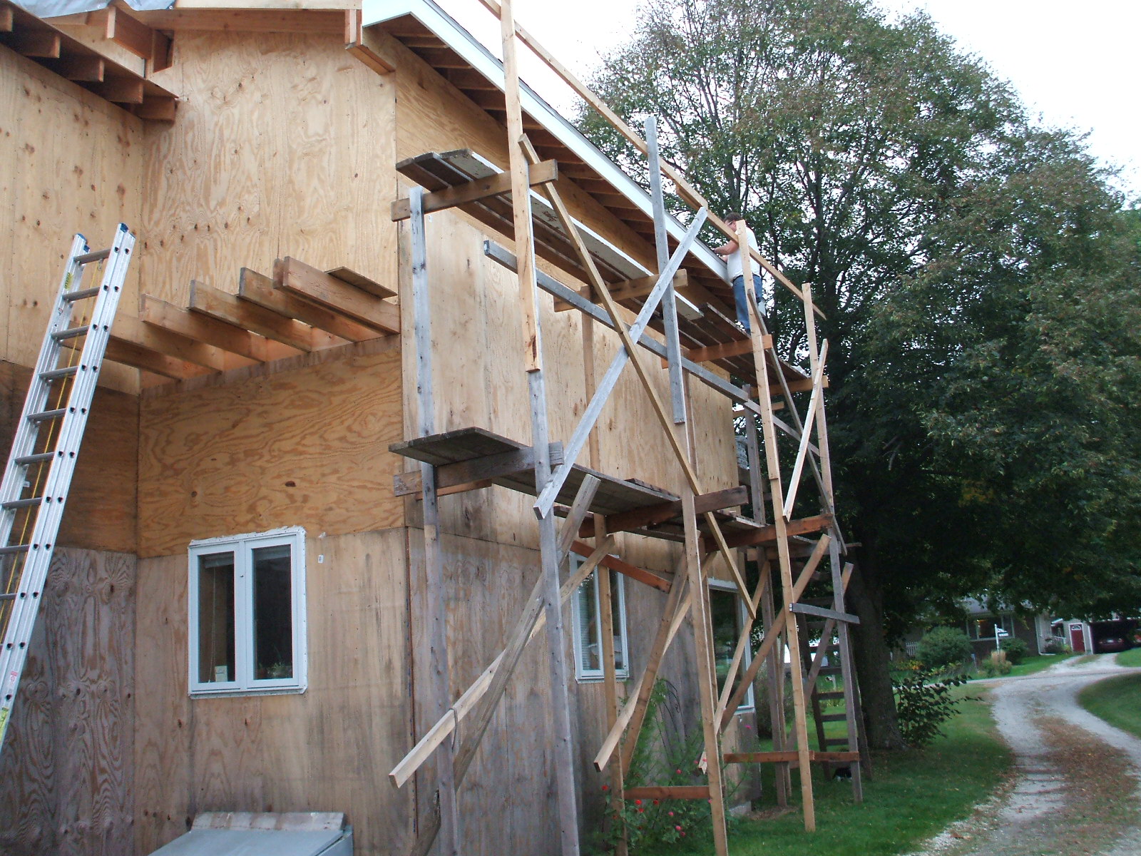

    This photo was my house addition, where I tore the roof off and put a second floor on.

    the stringers are just 2x4 on edge doubled by nailing there are 5 of them under the 3/4" plywood the Brick scaffold I have set up on the bus is only 7' 2" c/c of each frame set the connecting pins are bolted to the bottom and the top frame sets not just slip fitted once the platform is completed and I lift it to the top then it will be secured to the frame sets mostly because our winds could turn it into a sail if it was free to move. I have jumped up and down on the platform while it is laying on the stands there is little to no give so it is plenty strong. I have some 2 x8 planks but not enough to make a full platform.
    Screws would have been nice to attach the plywood to the stringer but I only had either some 1 inch or some 3 1/2" 1 inch would have been too short and the 3 1/2 inch would have been ridiculous to use. The nails are also 3 1/2" and are going to be hard to remove when it is time to reclaim the lumber and plywood but I was out of 2" for my smaller nailer

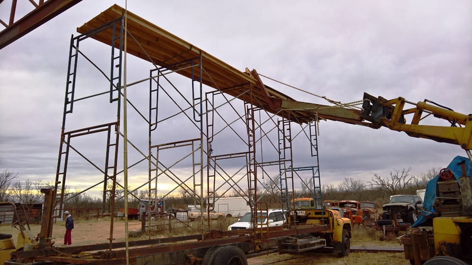

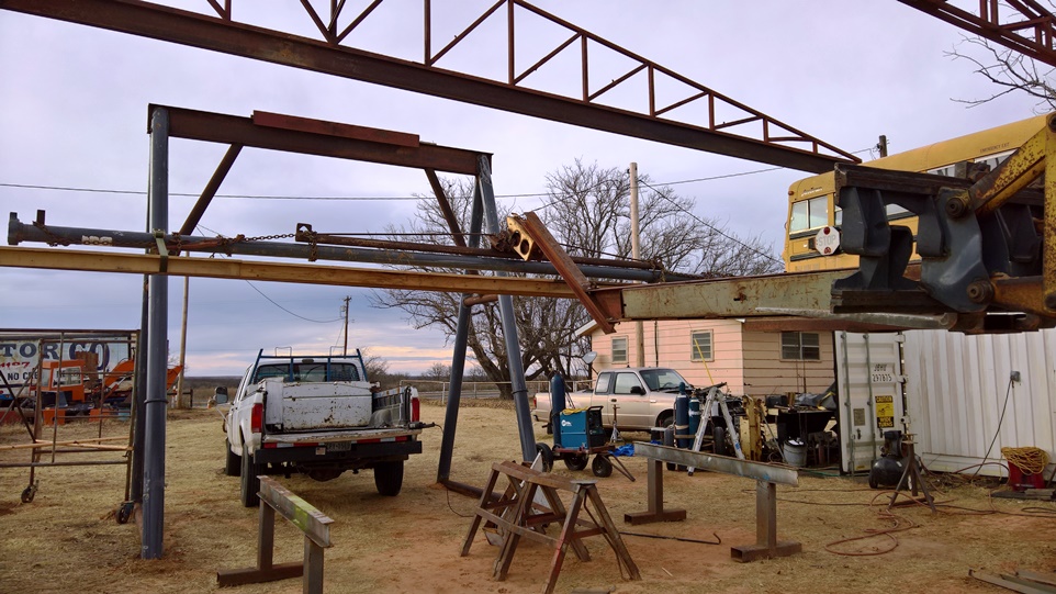

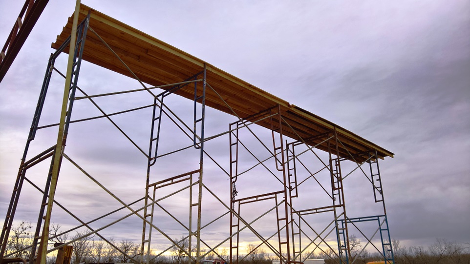

    Went and picked up the remaining 2 required sheets of 3/4 ply today for my platform then used the boom extension and the spreader bar with the spreader bar extension to raise the platform to the top of the mobile scaffold
    From my homemade fork carriage mounted on the loader of the back hoe to the mobile scaffold I could not do without my home made tools.
    4 home made tools on the backhoe alone involved in the lifting
    3 home made tools used to support the platform while building it
    the mobile scaffold itself and the platform
