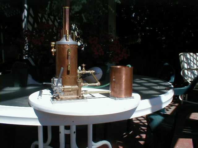

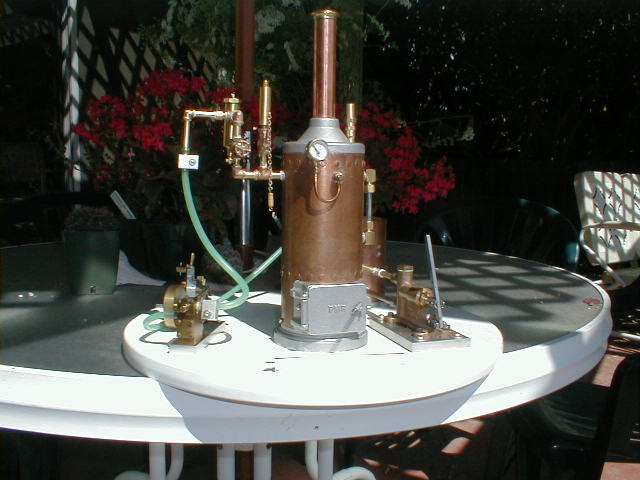

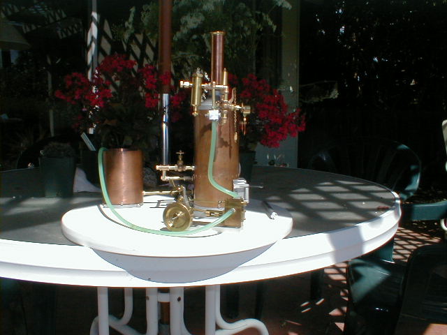

Boilers are very dangerous, especially so in the hands of novices.
When people who want to build boilers ask me for advice, I always recommend that they get a kit so they at least have the right materials and responsible build instructions.
PM Research has two boiler kits, a horizontal model...
https://www.pmmodelengines.com/shop/...-boiler-kit-2/
and a simpler, vertical one....
https://www.pmmodelengines.com/shop/...-boiler-kit-1/
I built the latter and can tell you that, while it's not complex, it will test the skills of even an accomplished metalworker.
Also, count on spending a fair amount of money on the boiler "furniture", valves, gauges, piping, feed pump, water tank, sight glass, safety valves, whistle, etc..
Run on compressed air until you've developed boiler-level skills and a thorough knowledge of the associated safety concerns.
Attachment 25160
Attachment 25161
Attachment 25162
