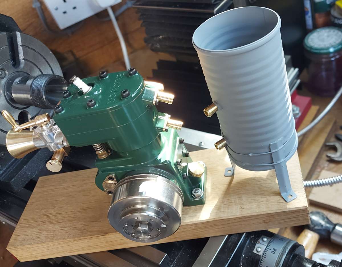

This is a model engine that I've been sent to have a look at, review and have a play with. First of all I'm unpacking and having a look at it:

and a bit more of a look around the engine, exhaust, carburetor and coolant connections

I needed a cooling water tank, trouble was the larger tins had the right look and the smaller tins were the right diameter....
https://youtu.be/LSH_j_gFq78
Someone commented that this doesn't fit the aesthetics of the normal models I make, I think he has a point....

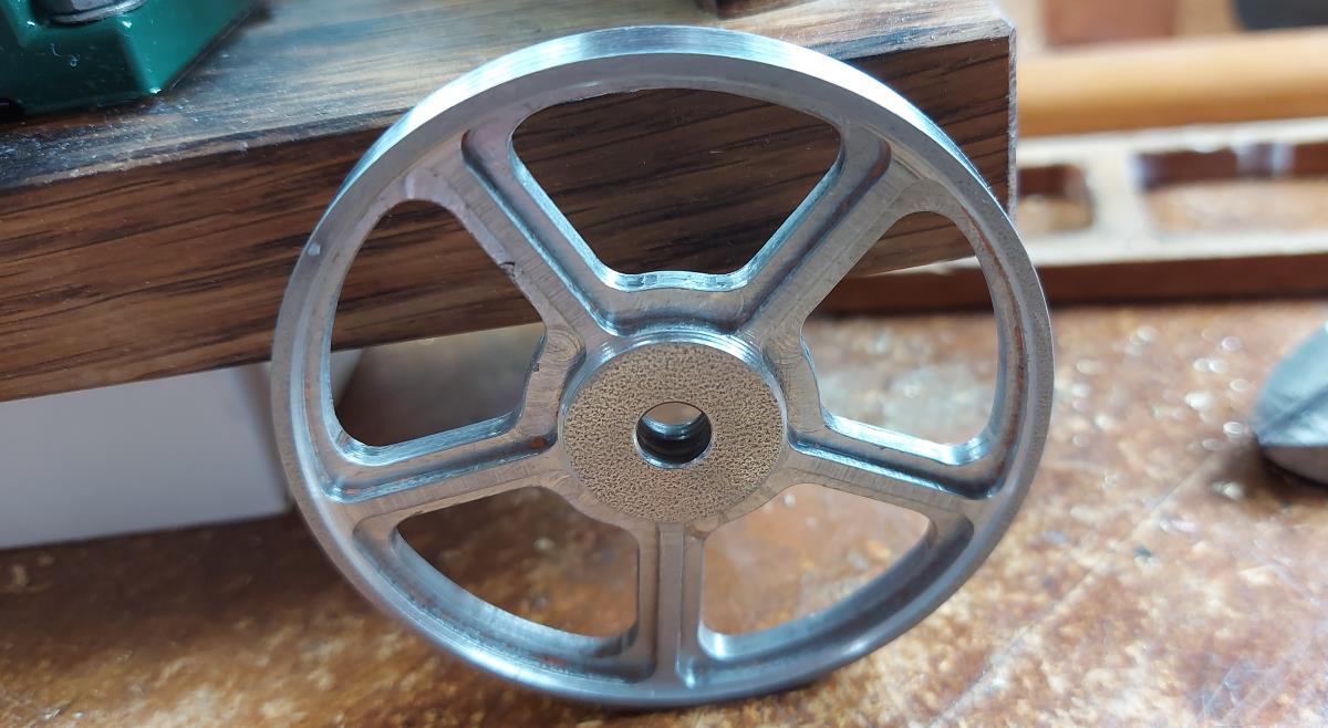

I've been making wheels to create a trolley for the Whippet
Attachment 42791
Made from 1/4" thick mild steel. Hopefully they look like an old cast wheel that you might find on a stationary engine trolley - thoughts?
I've just briefly written up the process I followed for making these wheels, the most important step was making a mandrel so that I could easily and repeatable mount each wheel to the lathe and then the milling machine.

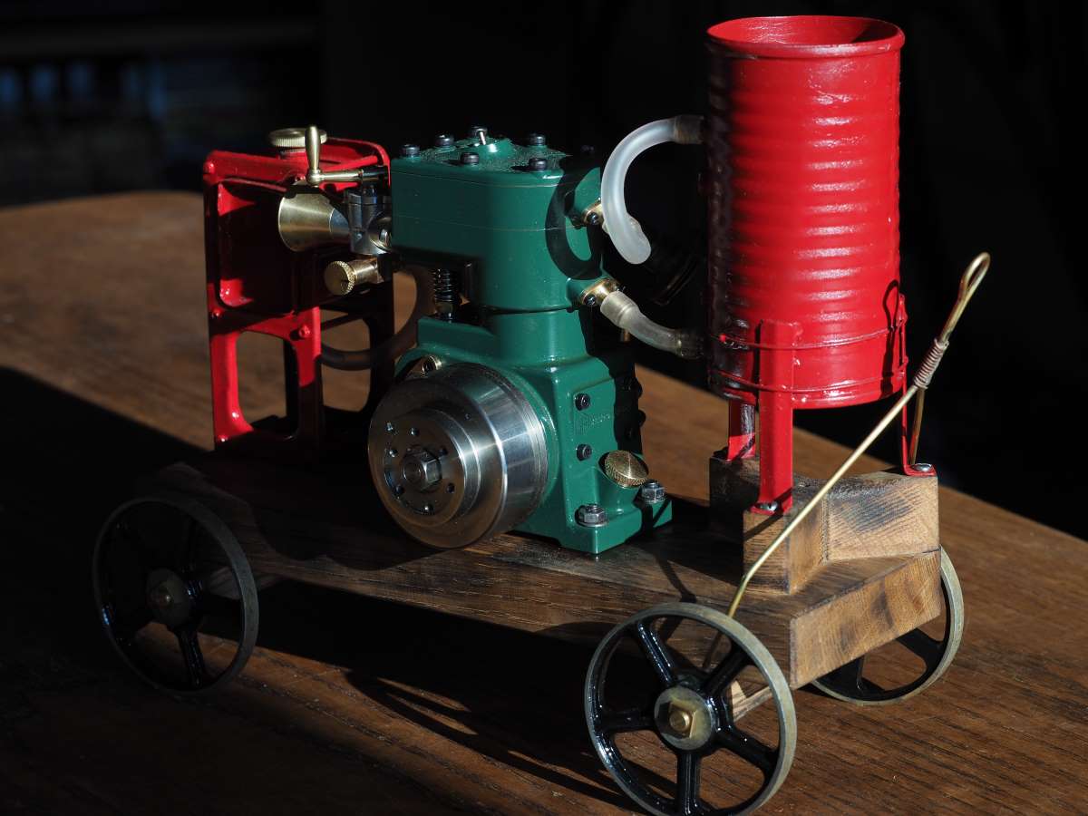

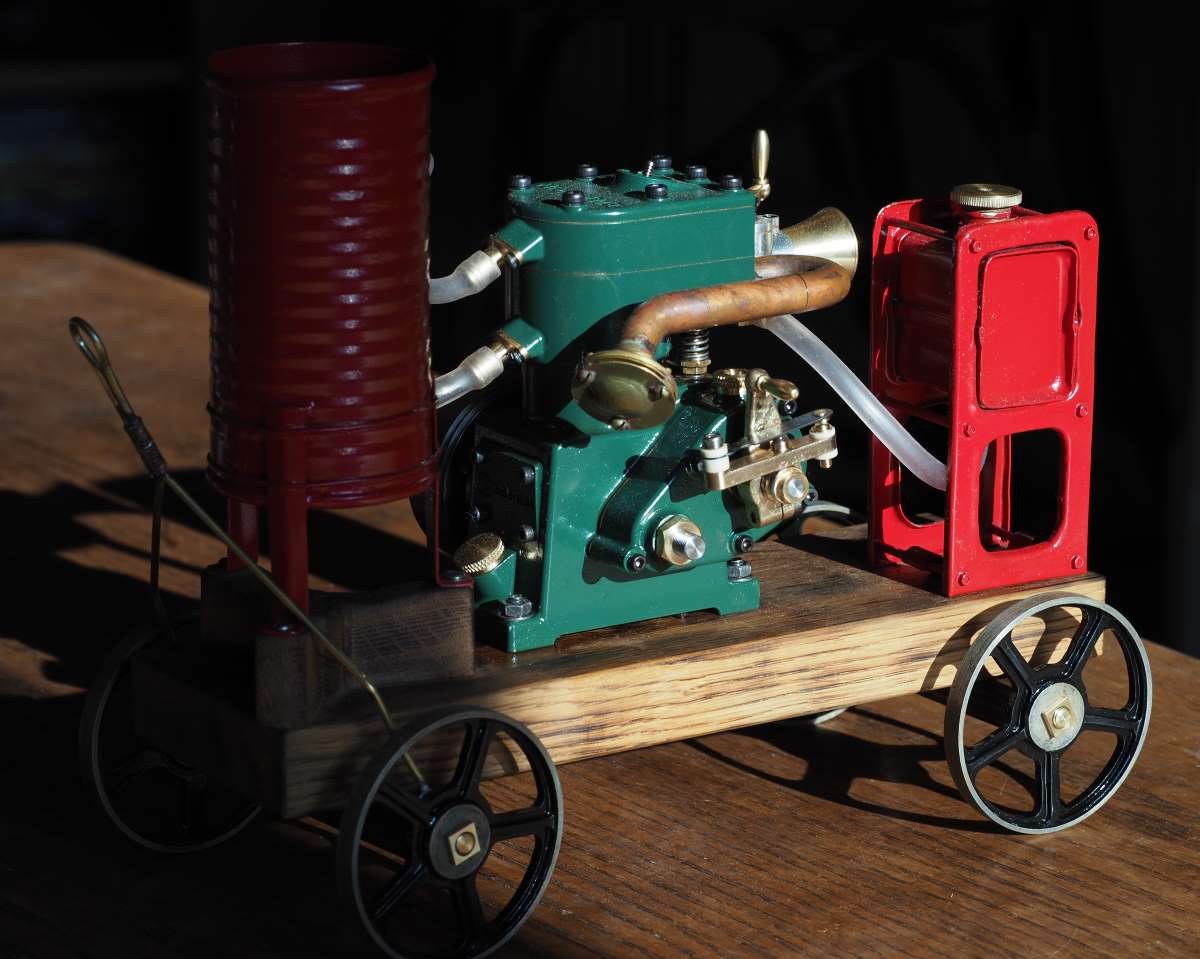

The final design and installation of the Enjomor Whippet engine on a trolley
Attachment 42867
What do you think?
Attachment 42868
I will now run it as installed on the trolley and post the video.
The texture of casting might be imparted by etching or shot blasting. Blast might edge out for appearance, it'll blend every tool mark evenly. There might be a way to texture paint or add a 'contaminant' instead. But they are beautiful raw.
When I needed a super finish on narrow surfaces, the trick was stoning one flute off a two flute end mill, making it a fly cutter, but makes clean corners tedious.
