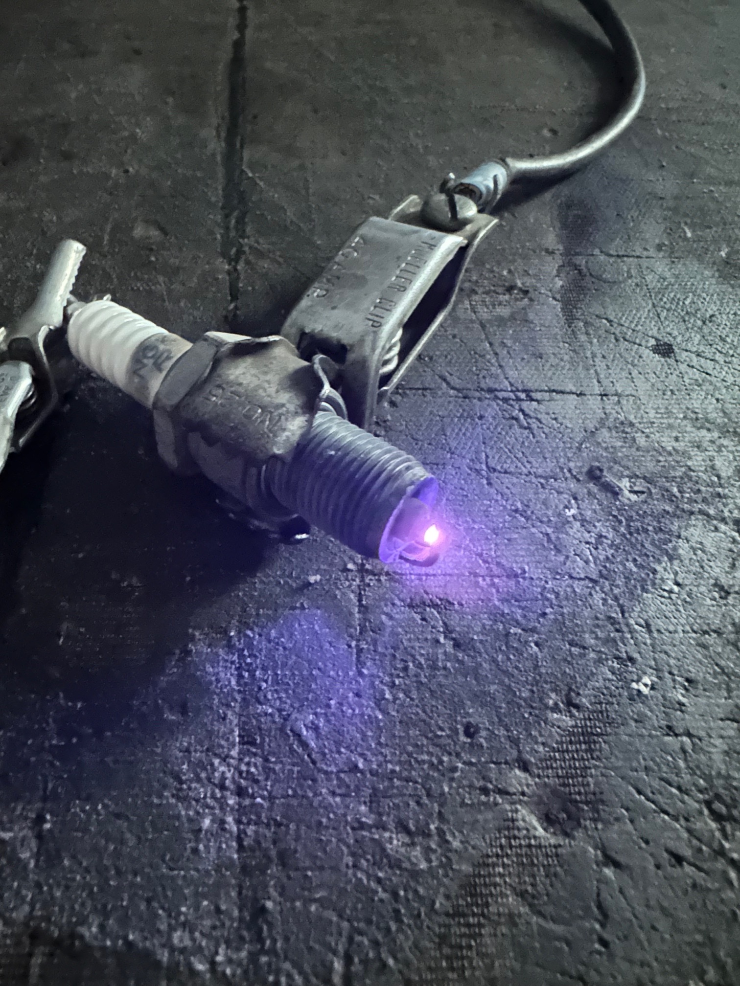

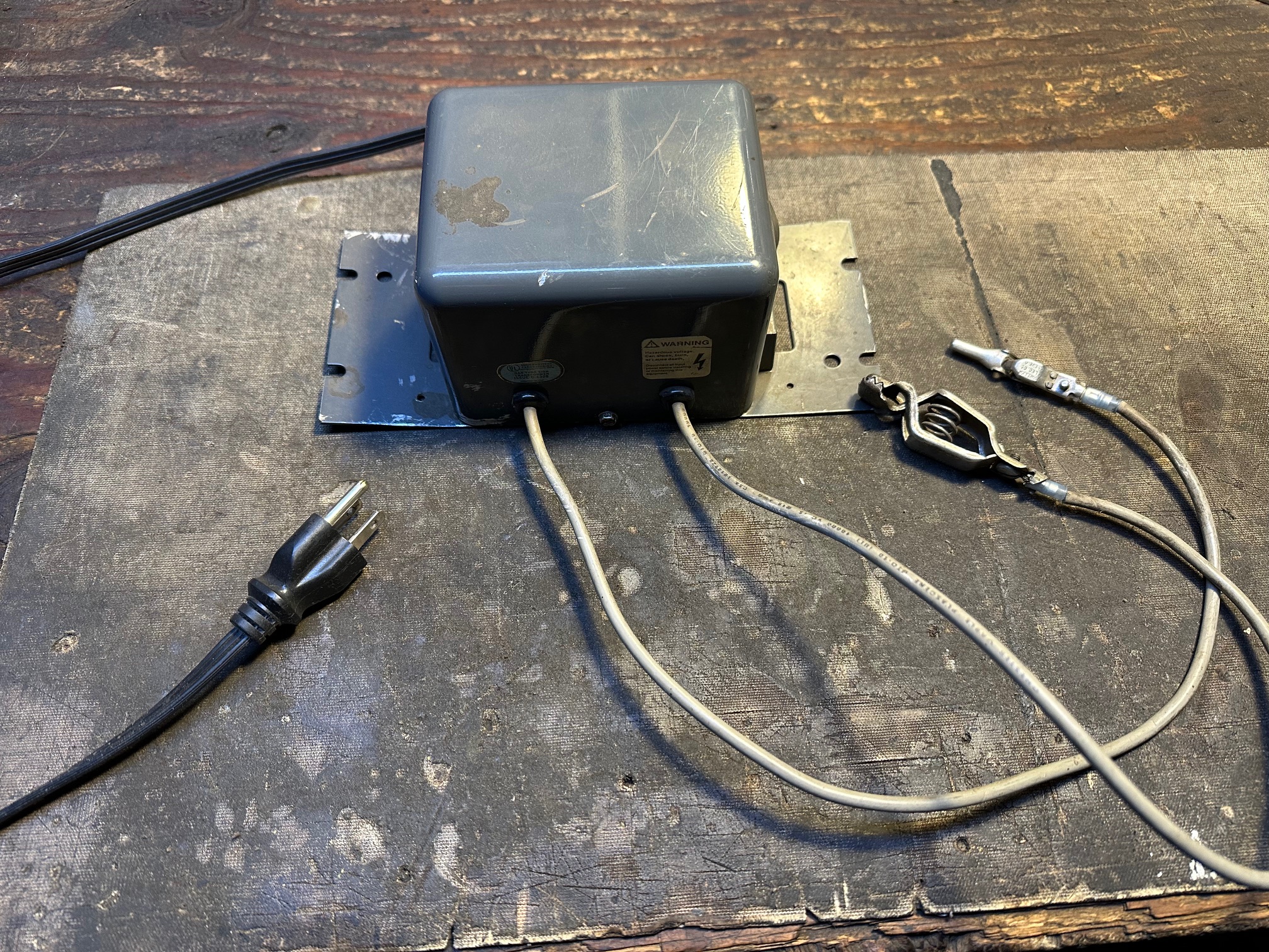

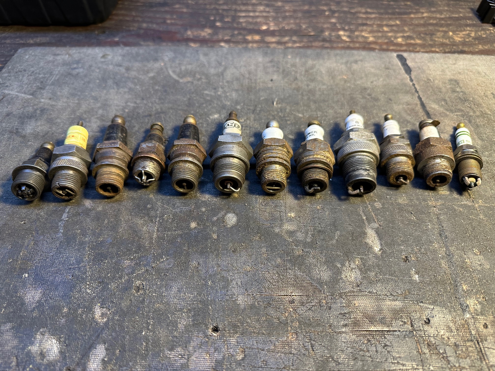

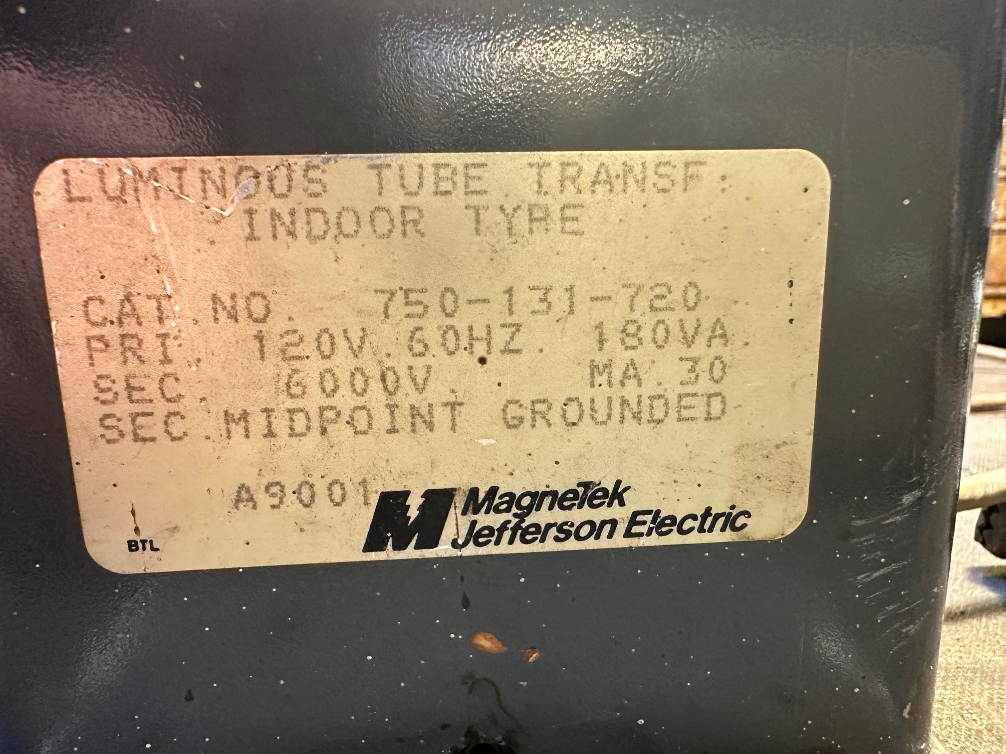

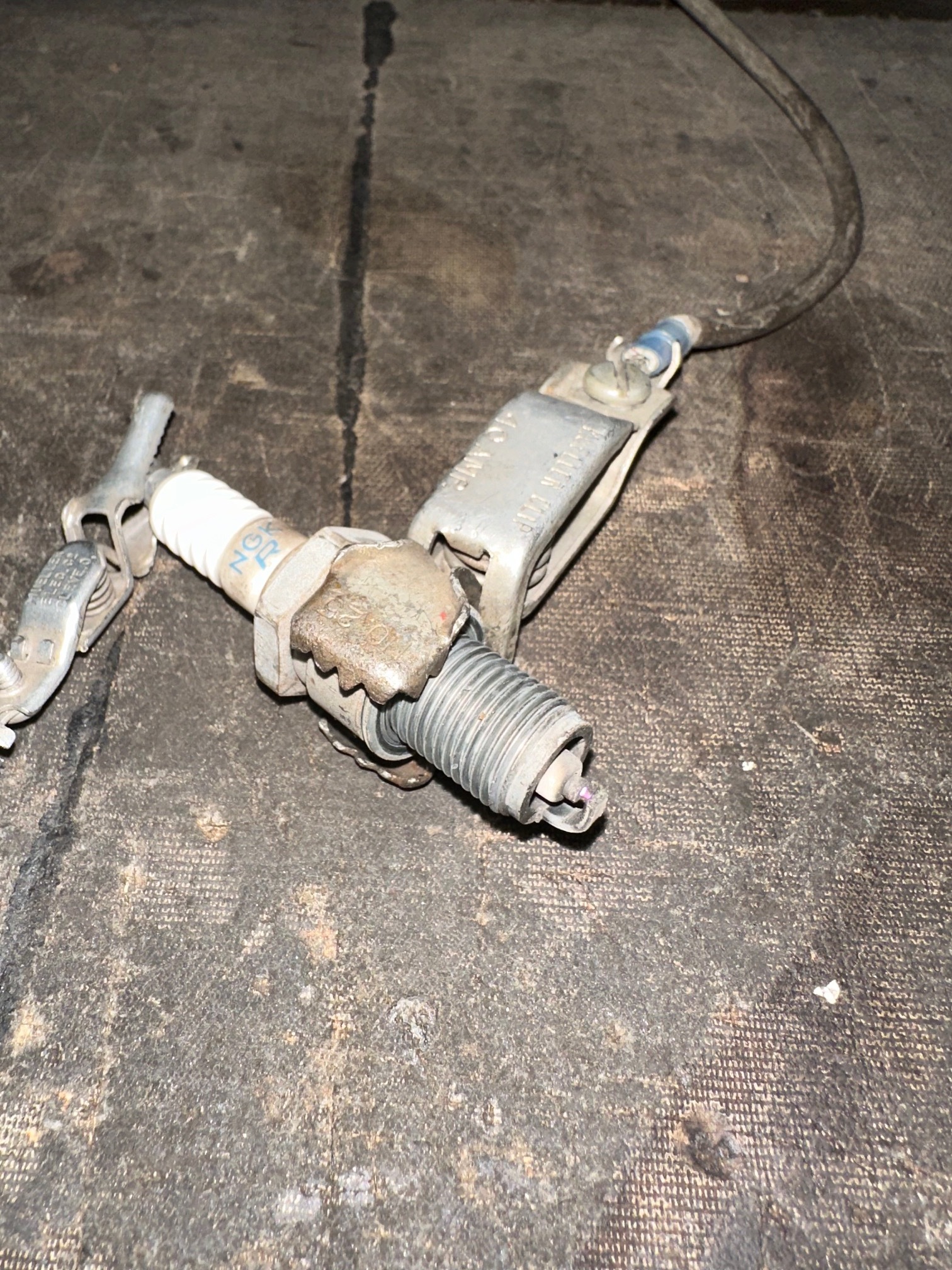

    I'm kind of connoisseur of spark plugs so I made a spark plug tester
    All you need is a neon light transformer
    Add some alligator clips
    and test away

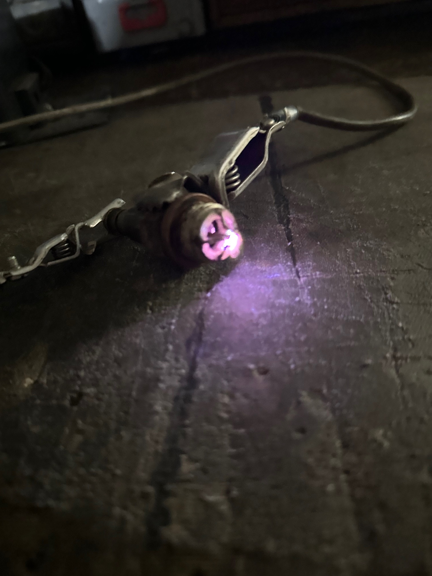

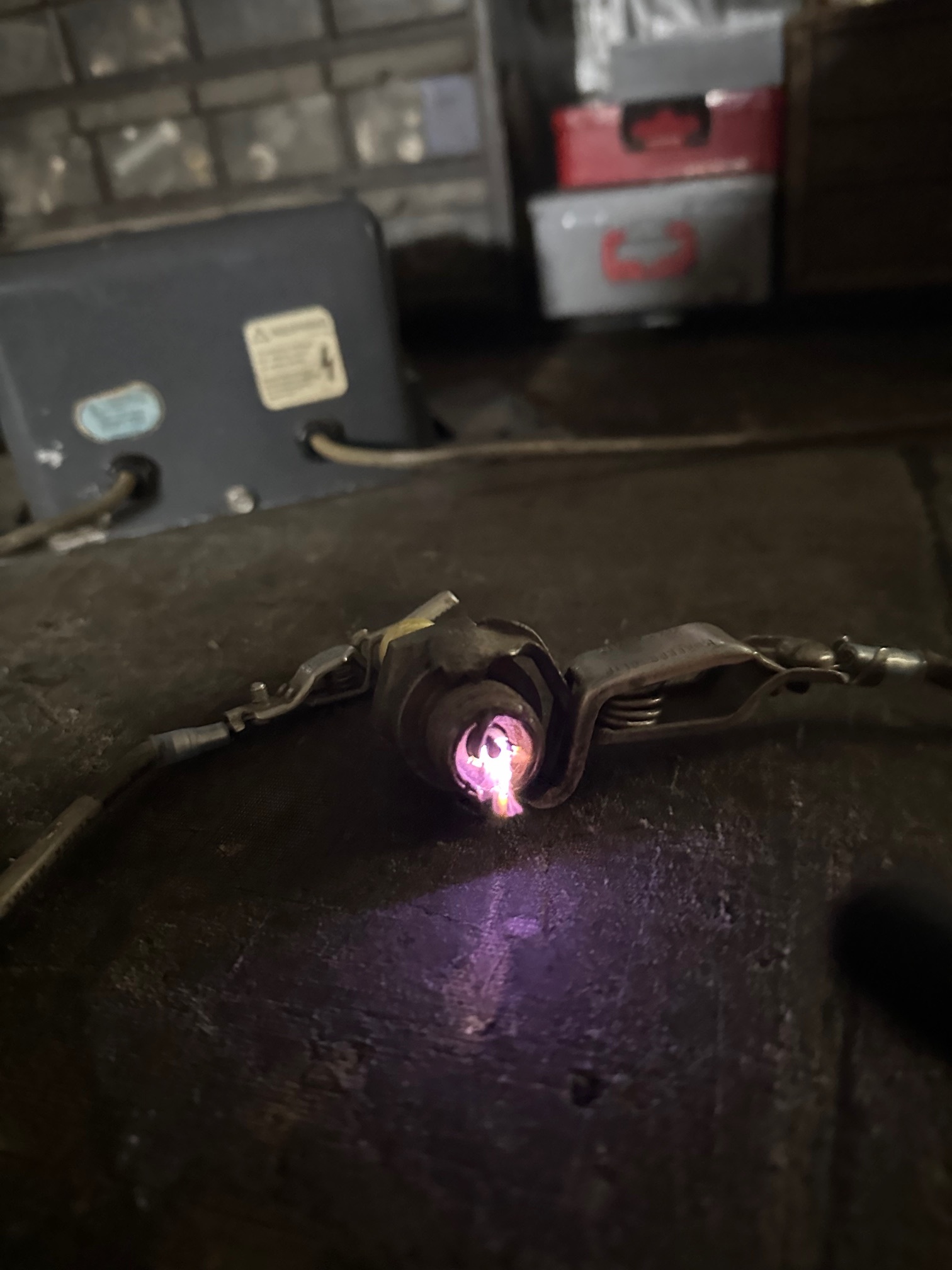

    Works quite well...
    [ATTACH=CONFIG]46423
    [/ATTACH][ATTACH=CONFIG]46424
    46425[/ATTACH]
    Attached Thumbnails Attached Thumbnails Modifying a spark plug - GIF-img_3278.jpg   Modifying a spark plug - GIF-img_3280.jpg   Modifying a spark plug - GIF-img_3283.jpg
