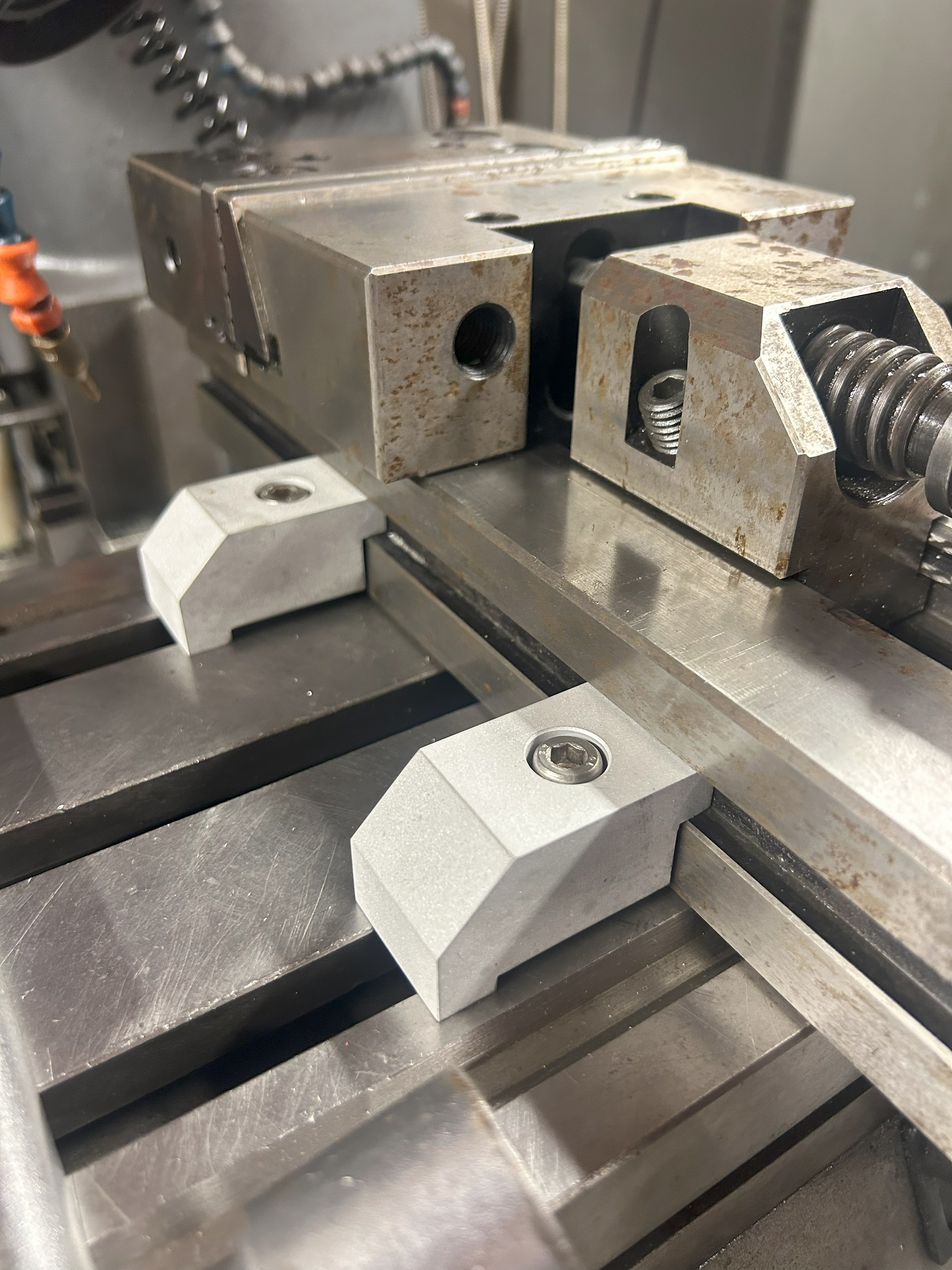

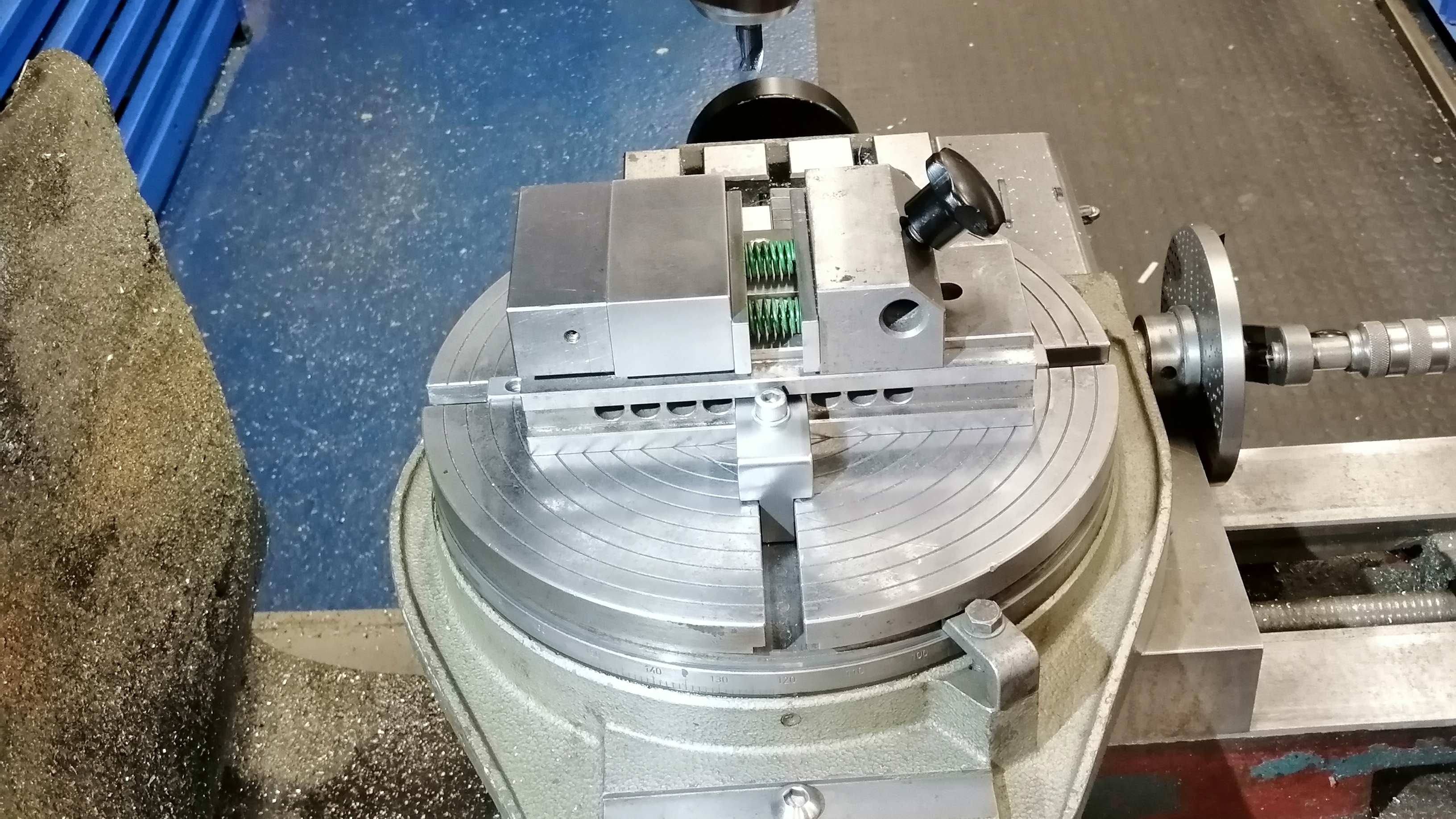

The vice came with the operating handle (after a quick look in the skip) but I was unable to find the hold down clamps for the vice. So the only item I needed to come up with was the clamps.

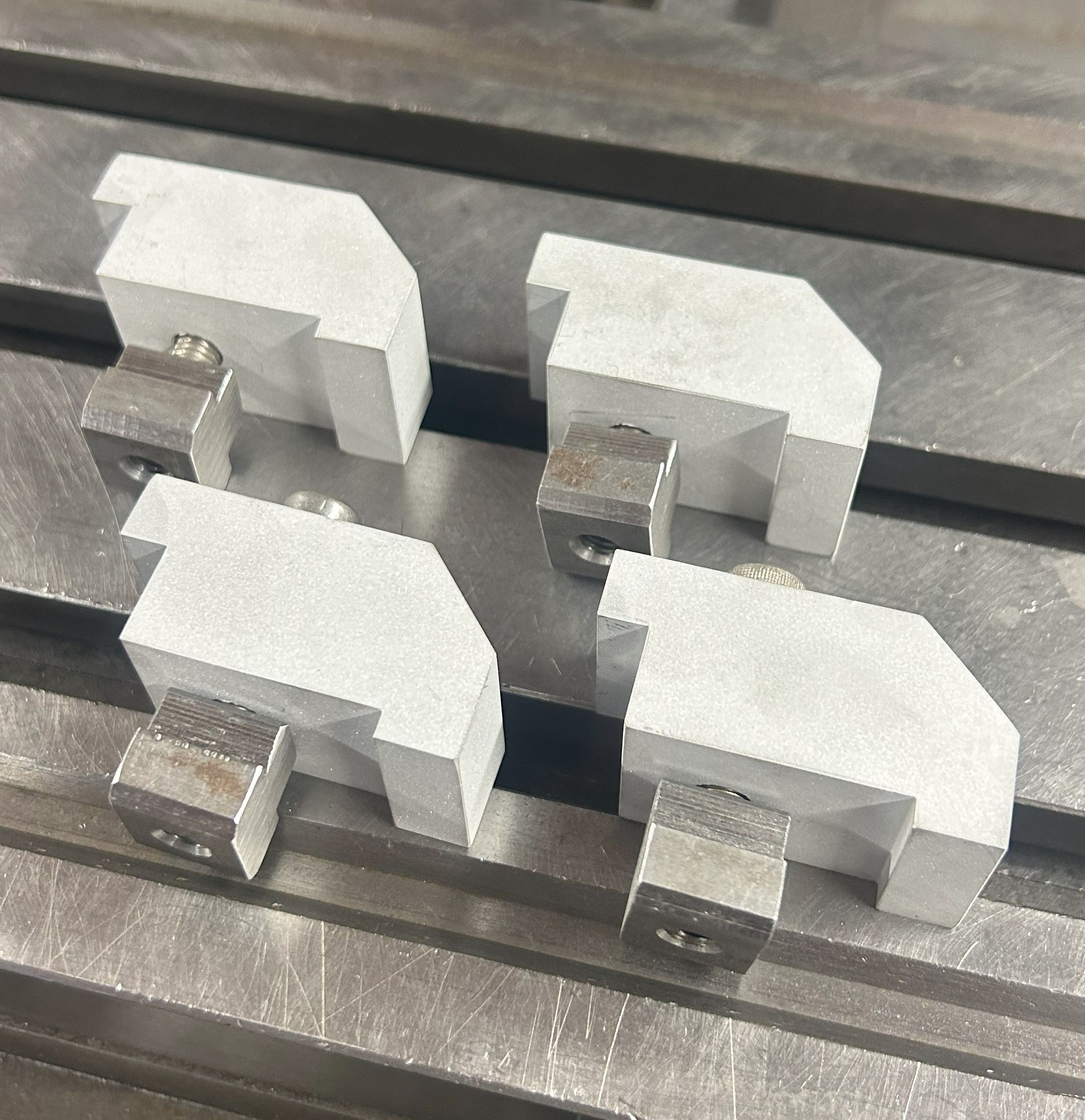

I decided to make them from a old block of aluminium I had laying about and set about cutting up 4 blanks to make the clamps.

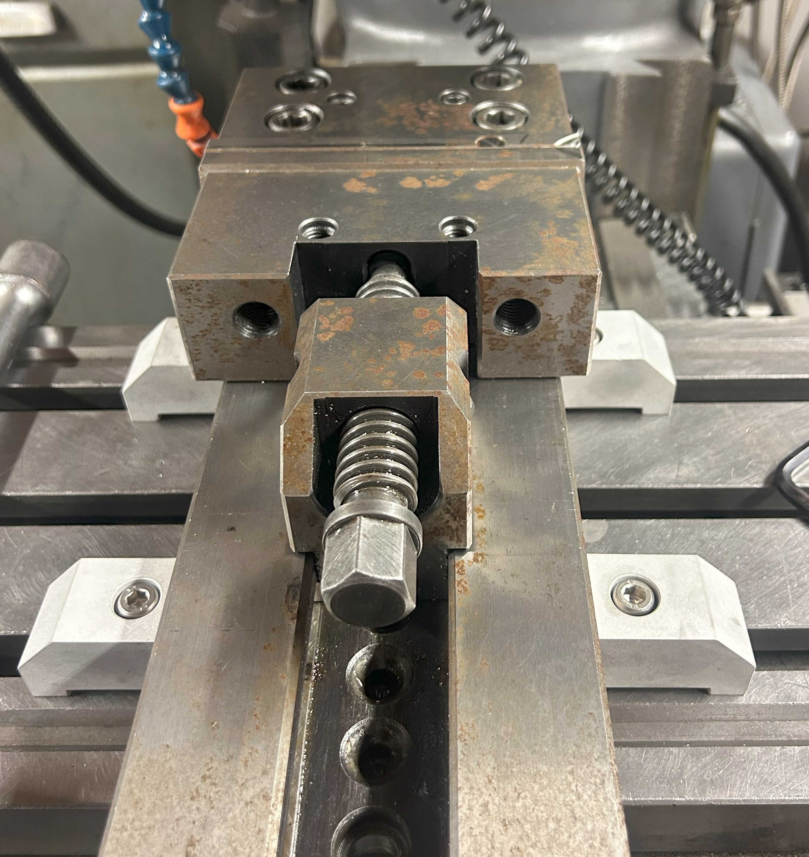

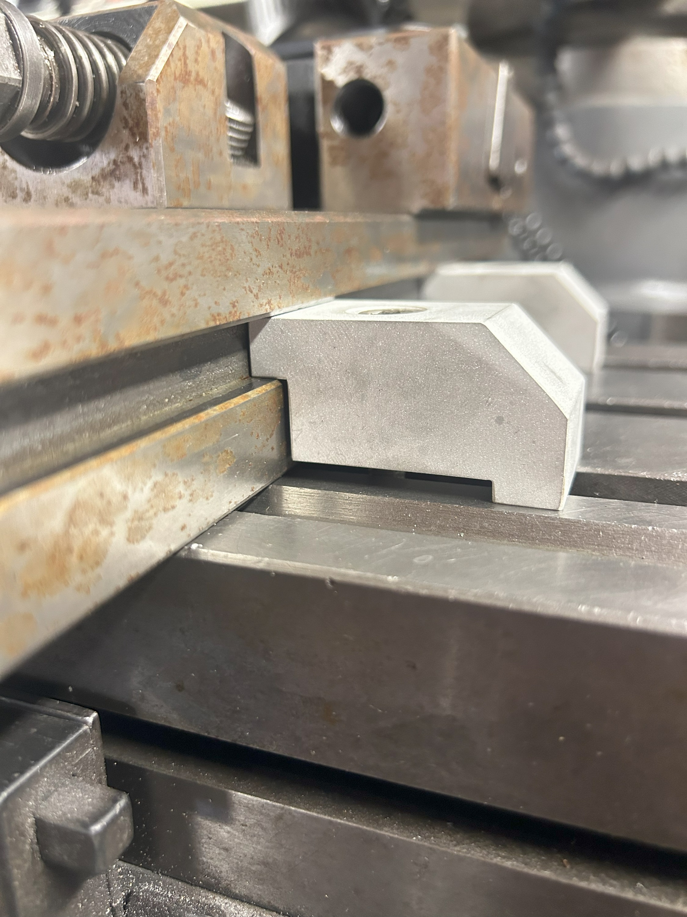

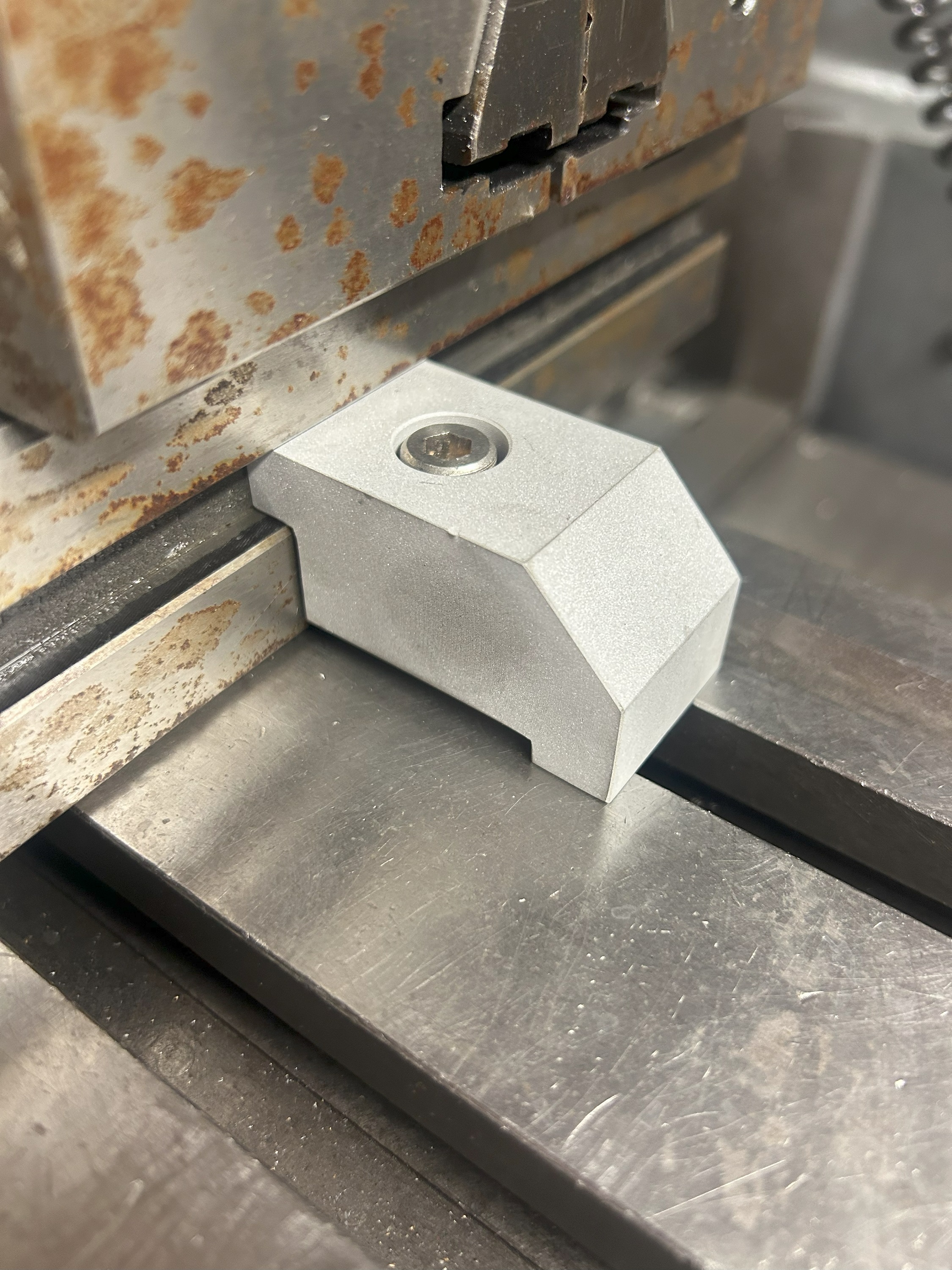

The photos below show the vice being clamped to my mill table using the homemade clamps. I possibly could have got away with 2 clamps as most vices use only two bolts and tee nuts. But the vice is quite long so opted for four. The large chamfer was purely cosmetic as the clamps looked cumbersome without this detail.
I decided to use M8 socket head cap screws as the loose jaw on the vice uses a 6mm Allan key to adjust the leadscrew nut and lock into position along the vice bed. So M8 tee nuts were also made so the clamps are always ready to go.
The only other item I added was two dogs bolted to the underside of the vice to engage in the tee slot to align vice.
Attachment 47460 The four hold down clamps and tee nuts.
Attachment 47462Attachment 47461 Attachment 47464 Clamp in place.
Attachment 47463 All four clamps in place
