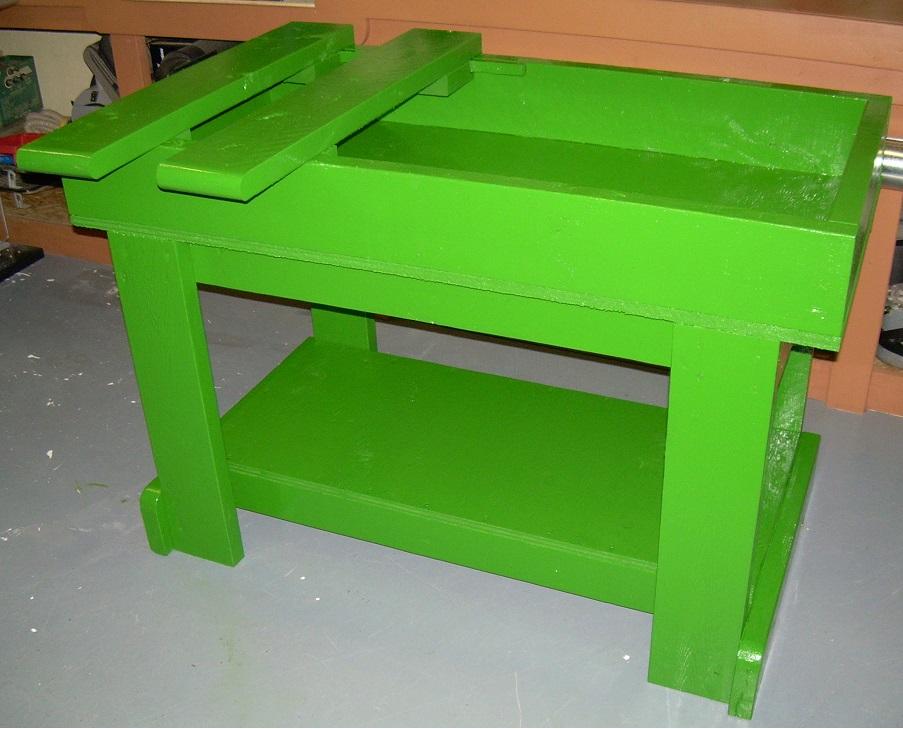

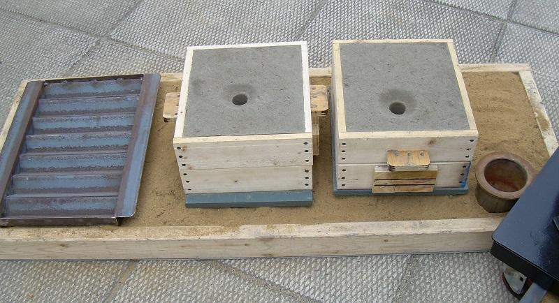

Molding Bench And Casting Set-Up

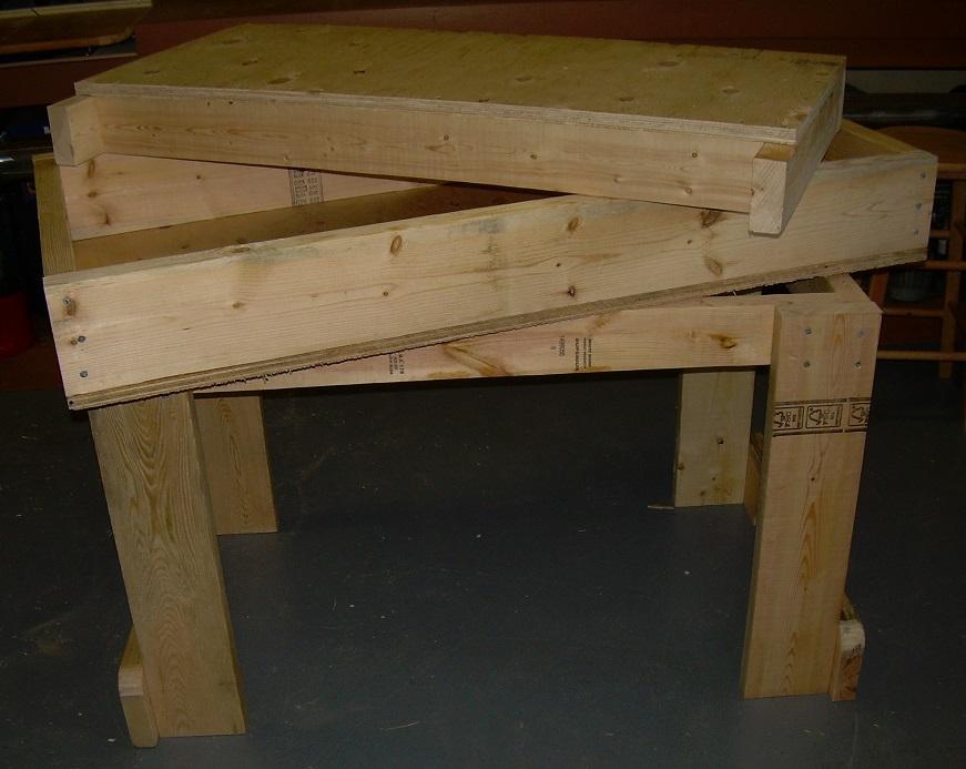

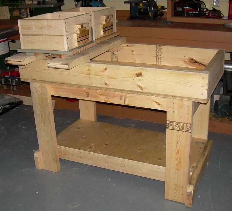

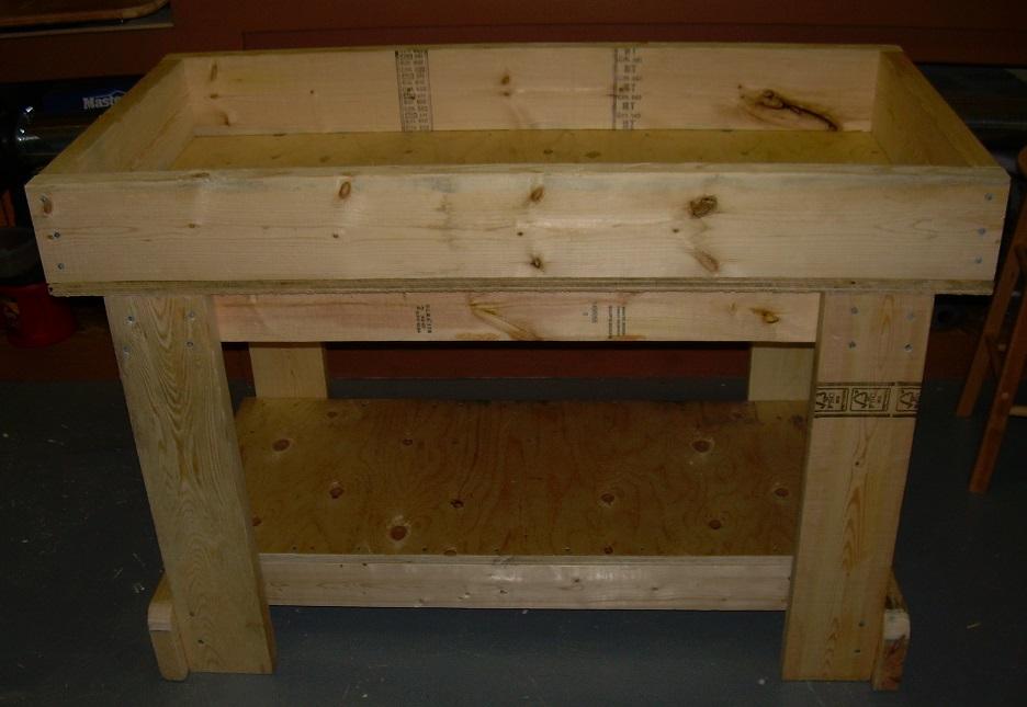

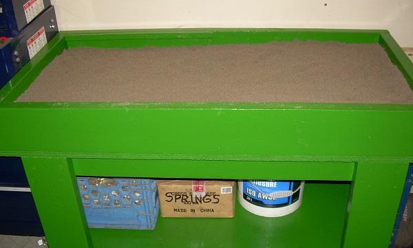

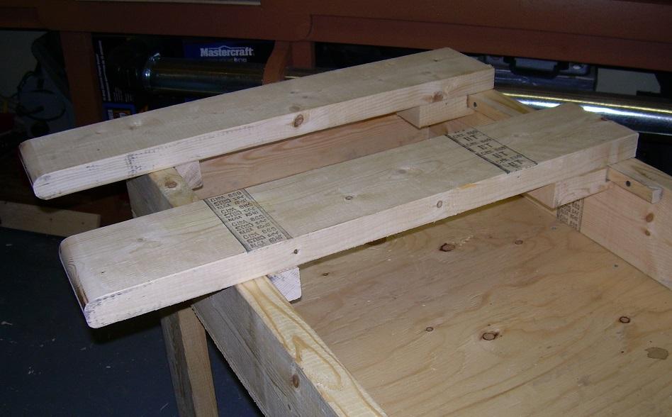

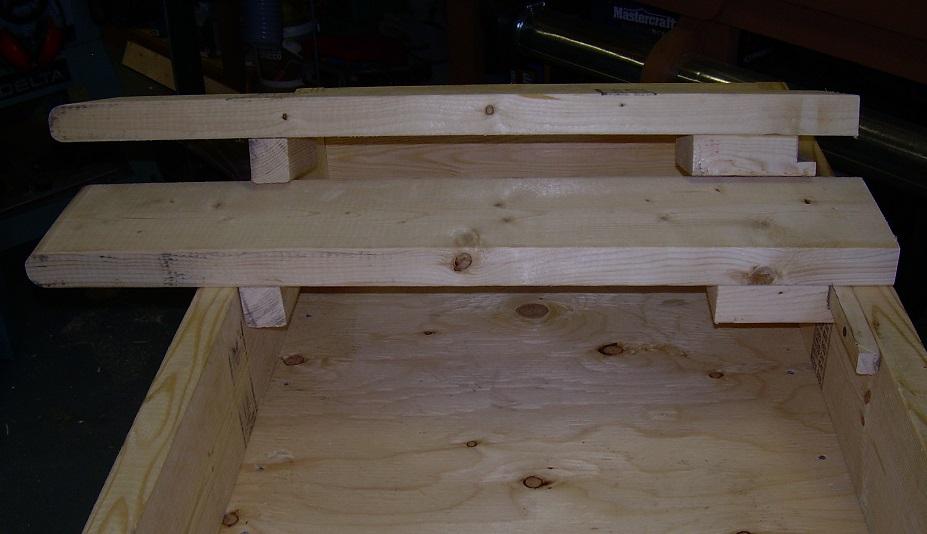

Before you can mold patterns you need a bench to mix, hold and fill your mold flasks with molding sand. To that end I built this molding bench it is 2' X 4' and built very heavy with construction grade lumber and 3/4" plywood. It will hold 200 lbs of molding sand and 300 lbs in 5 gallon pails underneath. The roll over rails easily slide out for access to all the sand when mixing.
Attachment 17007
Attachment 17008
Attachment 17009
Attachment 17010
Attachment 17011
Attachment 17012
Attachment 17013

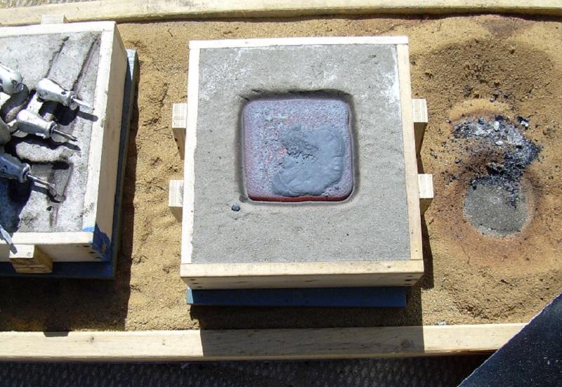

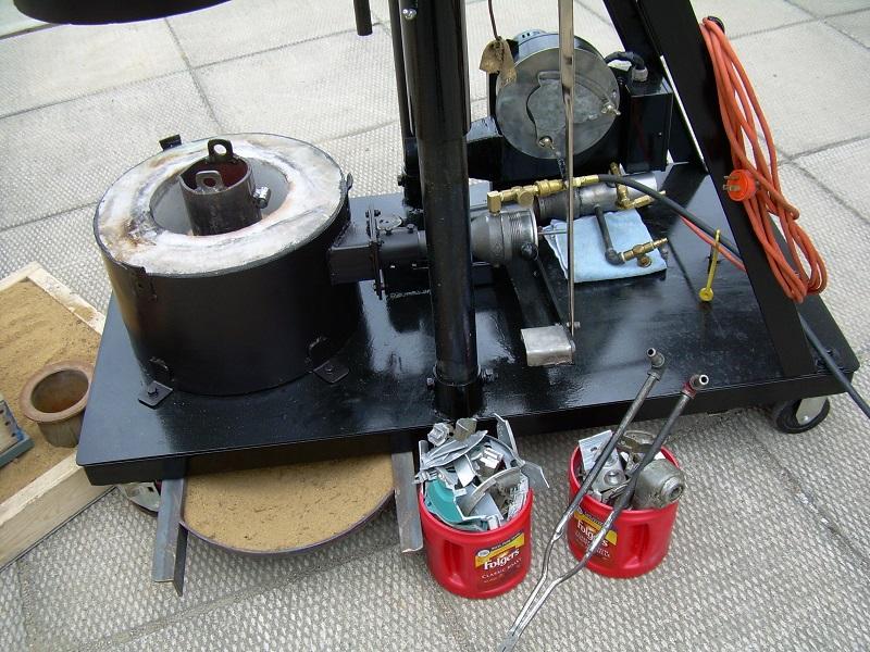

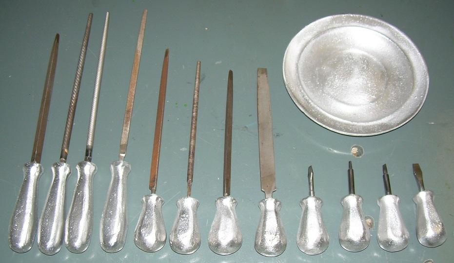

And here are some pictures of my casting setup.
First setting up for aluminum pour.
Attachment 17014

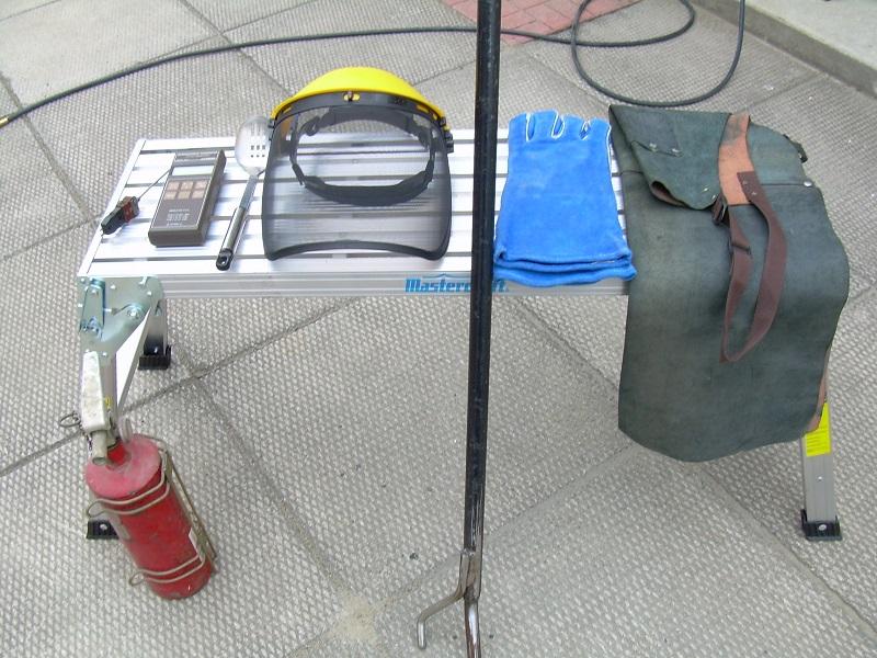

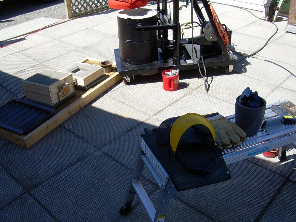

The safety equipment.
Attachment 17015

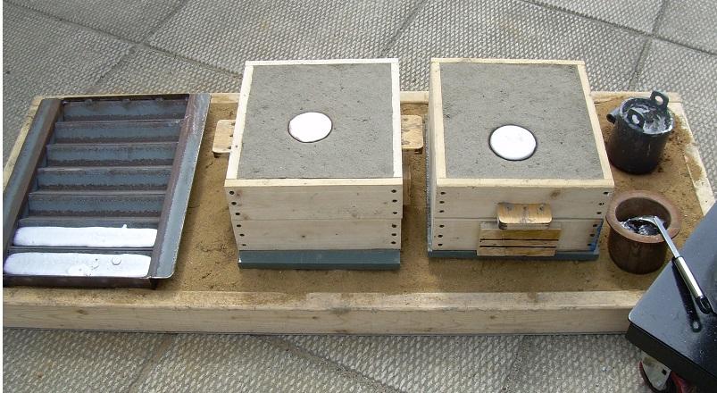

The molds ready to pour.
Attachment 17016
All poured and cooling.
Attachment 17017
Setting up for casting iron.
Attachment 17018
Open face iron pour, still red hot.
Attachment 17019
And here is a pic. of some of the first castings I played with.
Attachment 17020
