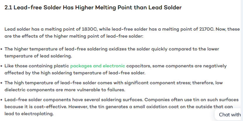

Sorry Tony its the oposite I did not make that very clear, Heres a clip from a supplier,Attachment 43299

That info is way out, solder melts at much lower temps than that clip states. My soldering iron has a maximum setting of 450 deg and I generally use it somewhat less.
The melting point of pure lead is 327.5 ° nowhere near the 1830 quoted in the clip.
Here is link to a useful article albeit somewhat one sided https://www.pcbtoolexpert.com/lead-free-solder/

That is better info, I will go with that thanks.
I always use 63/37 solder for electronics it is 63% tin and 37% lead. It has a melting point of 183°C (361f), slightly lower than the more common 60/40 blend. The primary advantage of this solder is not the lower melting point, but its eutectic property. Non-eutectic solders, like the 60/40 solder, have a semi-solid state between solid and liquid.

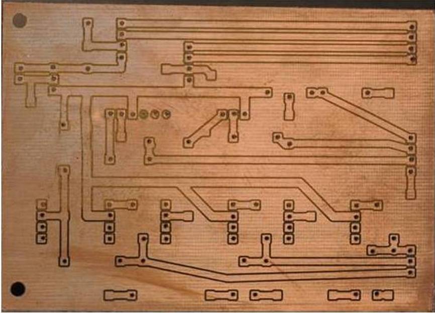

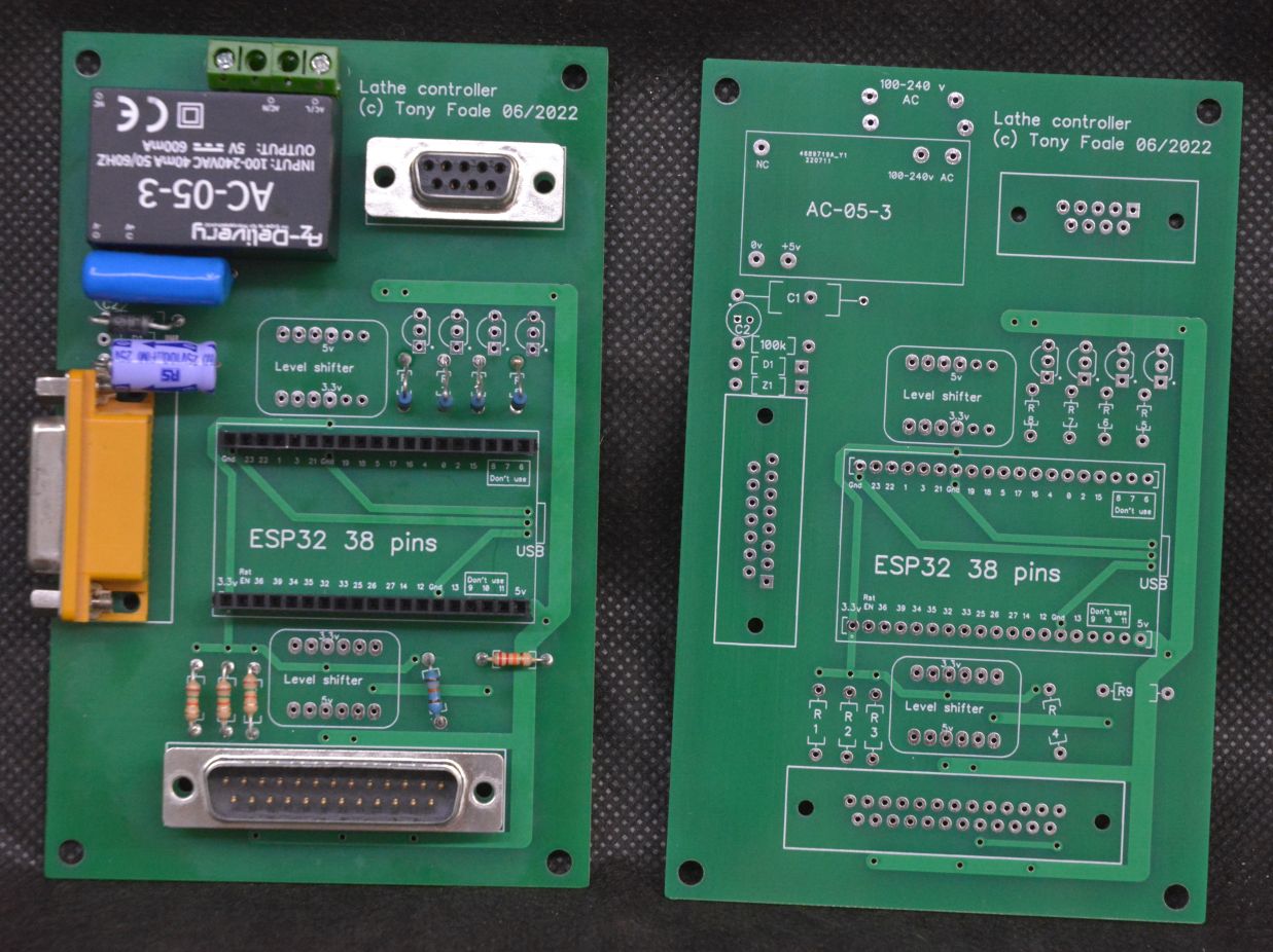

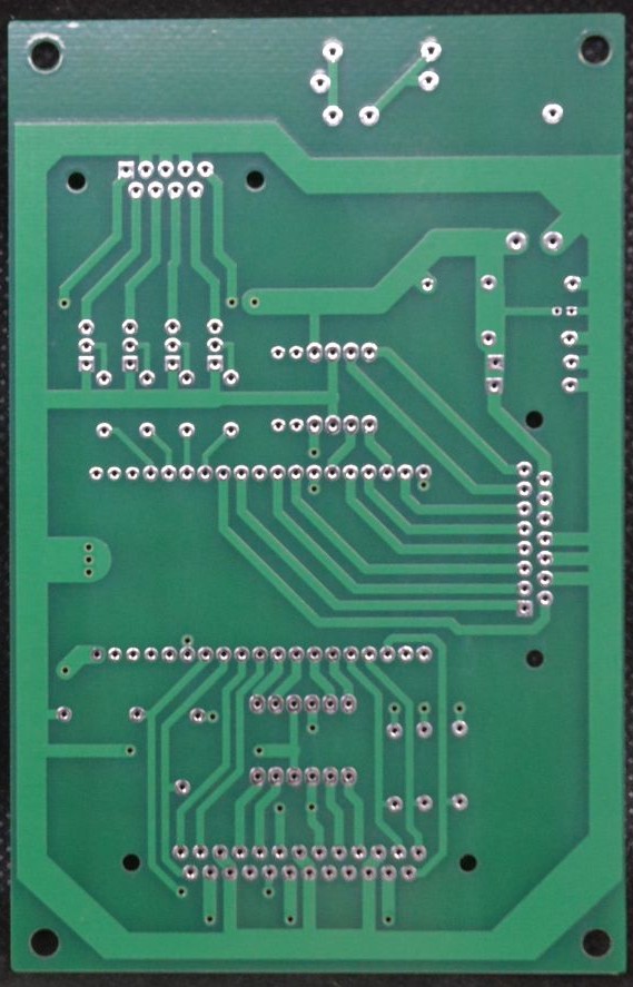

You do not actually need any electronics knowledge to build this. Just some manual soldering skills is enough. I did have some boards made. Before getting any made I did say that I would add on to the order any that were ordered before the order went. I had only a few takers. Since then I have had quite a few others who have indicated a desire to make a similar conversion so I may get some more done. First I need to produce a document explaining things so that I can say "here are the instructions, here is the BOM and here is a PCB, you are on your own now. Maybe you should all start a self support forum" Finding the time to do that is proving difficult. I have no secrets and I am happy to share anything that I do with others, but I just do not seem to have any spare time to prepare stuff to a stage suitable for others to follow. Only this past week I realised that I need a dynamic balancing machine, not a large project but that is on top of a dozen others. I generally work without drawings for mechanical stuff and without schematics for electronic stuff. In the case of the lathe conversion the PCB is the schematic in effect.
Attachment 46362 Attachment 46363 Click for full size
Front and back of the PCB. Constructing it requires no electronics knowledge, just place components and solder. These are the only boards that I have had made professionally. Although I have made my own since the early 1980s. It was all manual wiring from the 50s to the 80s but now things have got much simpler with the advent of micro based circuits. Far less electronics knowledge is needed today in order to make very capable devices.

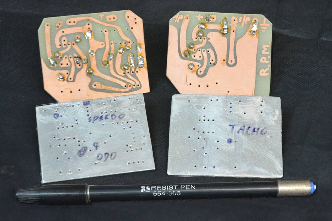

Attachment 46364 Attachment 46365 Evolution.
Left: 1980s, manually drawn with ink resist pen. The aluminium pieces are drill jigs. Right: 21st century, CNC isolation milling.
