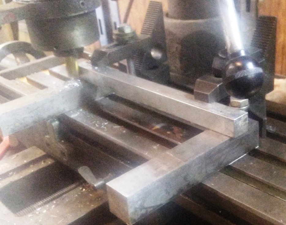

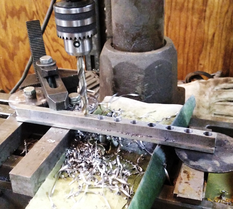

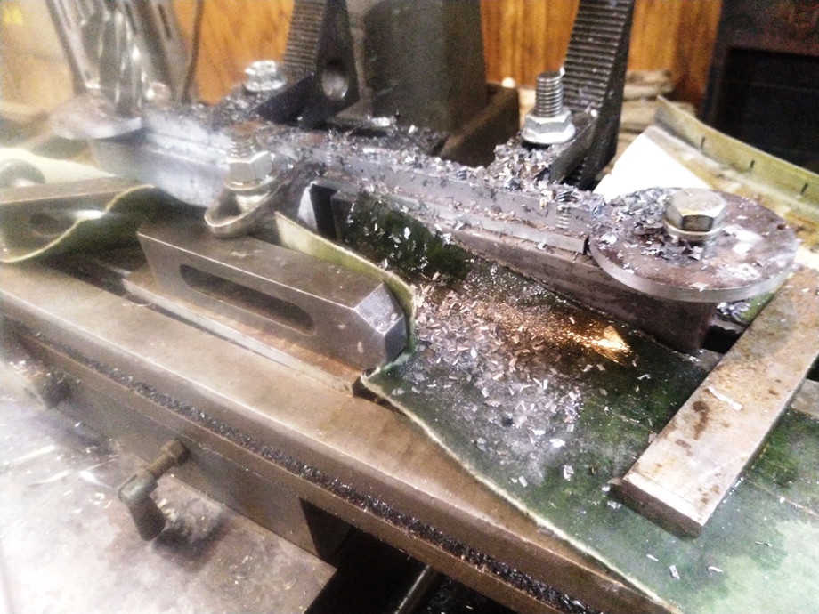

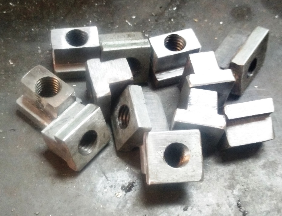

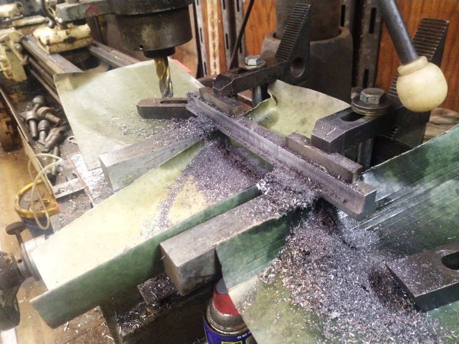

More T nuts, this time almost real ones made from a bar of 7/8" square keystock
Trust me it would be cheaper to buy them

You know what your time is worth, so I couldn't argue with you for your T-nuts, but the ones I need go for about $7-10 each when you can find them. These are for a Unimat lathe. I bought a foot of 12mm square keystock, and figure I can get something like 15-20 of them out of that foot of stock. I need something like 12 of them, six for each of my Unimats. They are gigantic! :) 12mm square by 6mm tall. https://groups.io/g/Unimat/files/Drawings/A2A070020.PDF You probably need to be a member of the group to see the print for them. Currently they are unobtanium. That price I quoted above is as of a few weeks ago, when last I looked. Today, a search for Unimat T-nuts came up with zero results, and I only got through 3 pages of 200 items per page before believing them. Turning them on the lathe will probably be faster than milling them. I may find out today. I can reach my lathe (not the Unimats, they're still getting cleaned up) and I have a 4-jaw chuck, and parting tools that should save me a bit of time.
there are alternatives, like the t-nuts used on 80-20 extruded aluminum stock, but those have to be modified to work, and it's probably finicky and time consuming for that, too. There aren't any really good answers. Except "Fugedaboutit!" But I've wanted one of these things since I was a kid, and finally have not just one but two. One is going to be set up as a lathe, the other as a mill. I've got blank milling tables laid out, and ready to drill/tap/mill so either machine can be set up and used for whatever I want to use it for. They ain't much of a lathe, but the one that came in it's own box weighed under 25 pounds. I can think of uses for a very transportable micro-machine tool... Do need a way to power it by hand. Thinking about a 24vdc motor conversion for them, too. Something to keep me out of trouble while the world goes to crap around me. ;)
