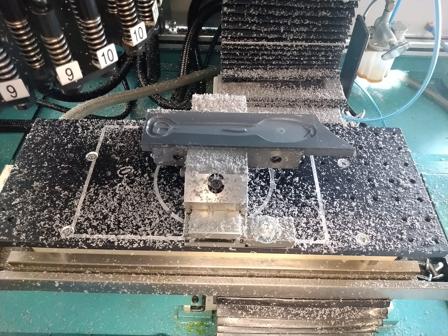

At work I use scrap aluminum to make consumable tooling plates similar to this for use on the Kurt vises. I'm often dealing with small and very small stuff at work and you need small clamps to deal with. In my case it is 1/4-28 due to having a bunch of screws that size, laying about, for tool post and some linear slides. Your post however just gave me a couple of more ideas when it comes to the clamping kit which I fully intend to implement if free time ever happens at Work.
In any event with retirement nearing I'm really thinking I need to implement something like this for use at home! Your Panavise idea frankly is golden so it will be a smaller plate than I use at work. Which brings up a question just how big is this plate of yours? I might even buy some prehard plate to make sure this does not tempt me to make it consumable.
There is something else I've seen that I haven't tired yet and that is to have a series of dowel pin holes in the plate to establish common angles from. Probably not sine plate accurate but many times you don't need that.
