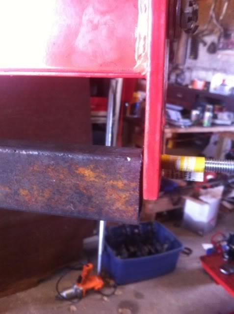

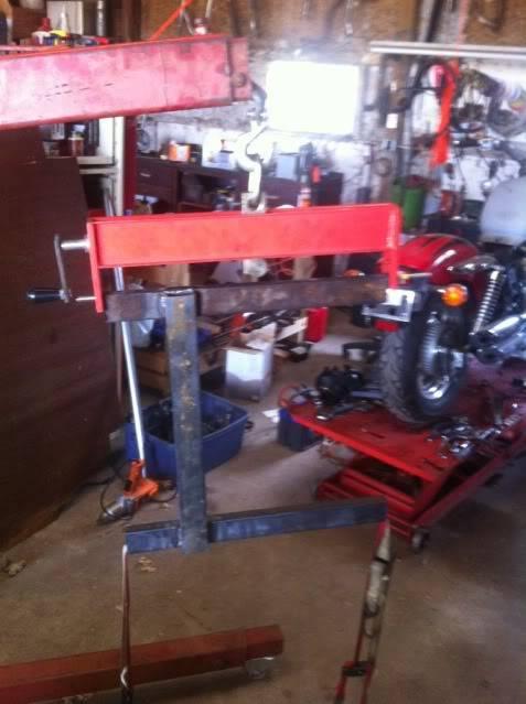

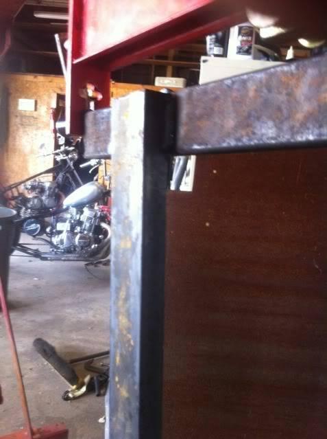

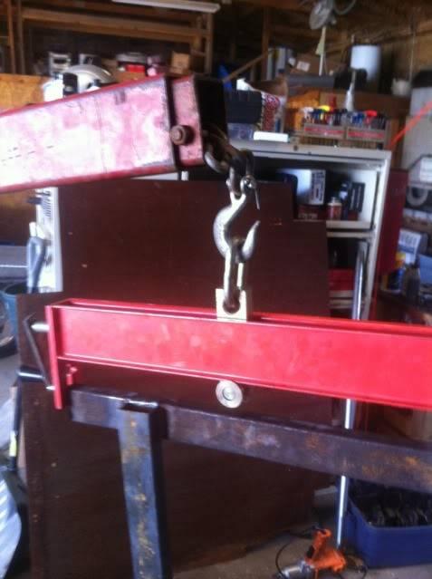

Motorcycle Engine Hoist Leveler for removal and intallation
This is a simply a C shaped piece of tubing that will allow you to lift around the backbone of the motorcycle to remove and install a motorcycle engine using car engine lift.
Basic materials:
3- 1"x2" square tubing ~ 20" long. I built mine from scrap and used what size I had.
1- car engine load leveler.
2- ratchet style straps.
This turns a 4 hands task into a 2 hands task. Also allows easy installation to prevent scratches and chips in fresh paint.
