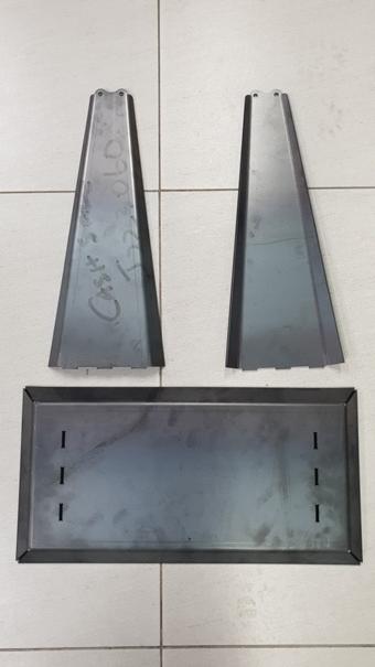

I had the frame laser cut and bent professionally.
Attachment 31523

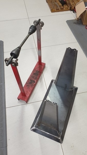

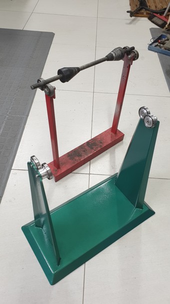

Here it is welded up, alongside the one it will be replacing.
Attachment 31524

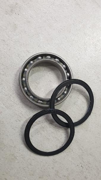

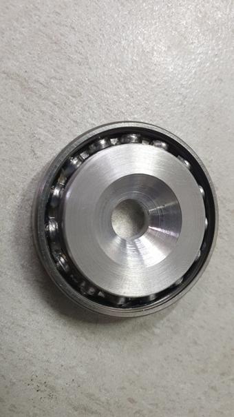

The new bearings were stripped of their seals and cleaned out to reduce most of the resistance.
Attachment 31525

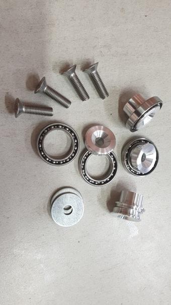

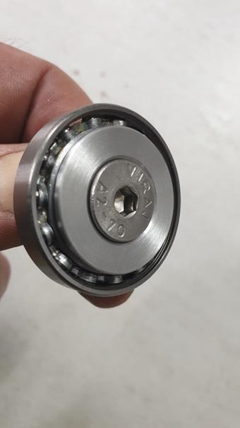

Inserts were turned on the lathe to attach the bearings to the frame uprights.
Attachment 31526 Attachment 31527

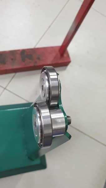

Here is the complete set of bearings and inserts. Two are shorter, and two longer. This is to enable the bearings to overlap each other to reduce the depth of the "V" they create. I didn't want the axle lying deep in the "V", as this creates extra pressure on the bearings. I wanted it lying instead on the "V" as it were.
Attachment 31528

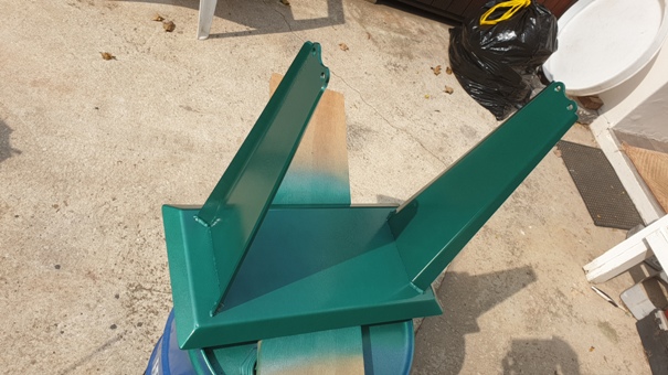

A quick lick of paint
Attachment 31529
And assembled alongside it's predecessor.
Attachment 31530

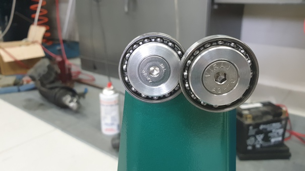

Here the overlap in the bearings can be seen.
Attachment 31531
Attachment 31532
