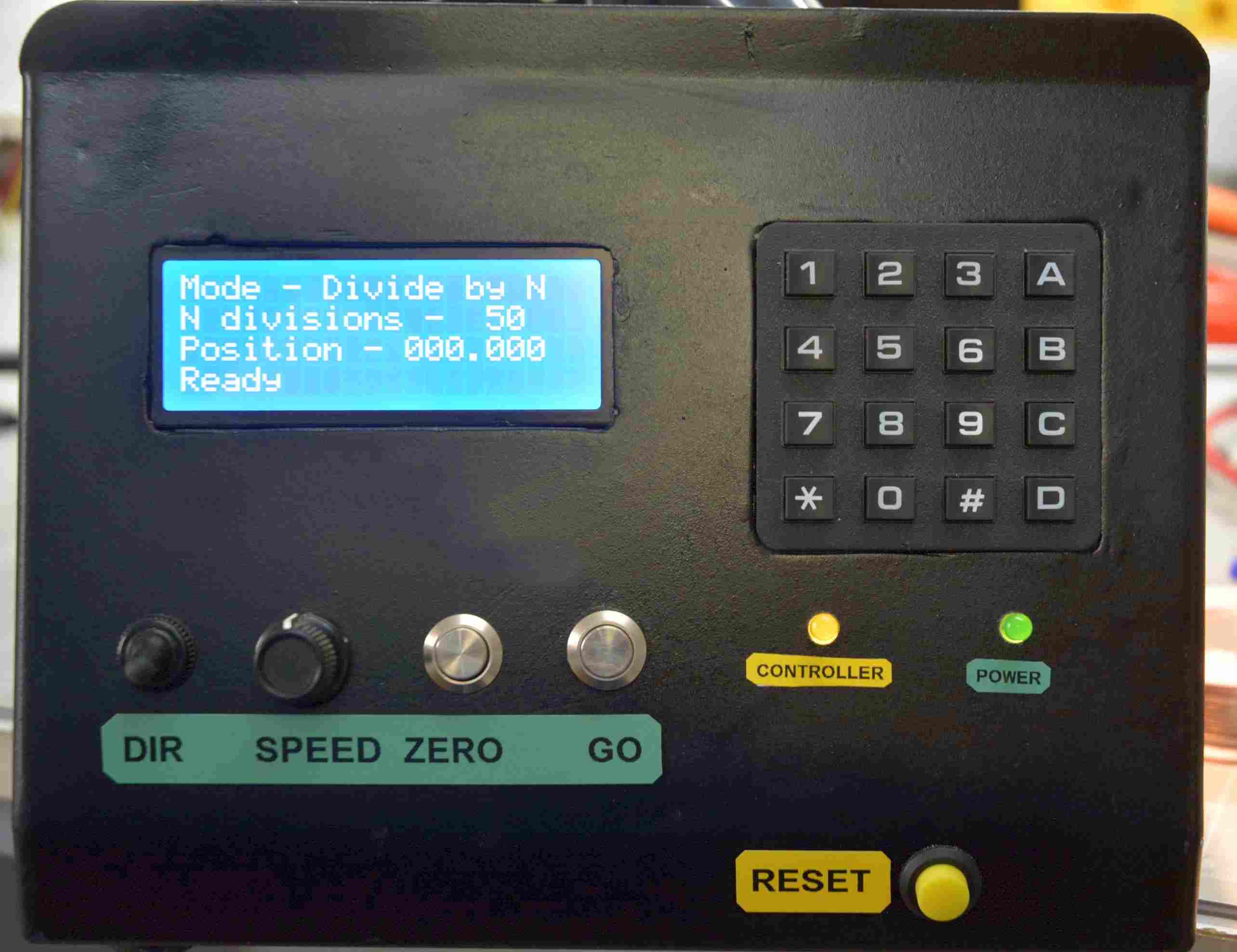

    I made a similar project earlier this year but I had forgotten about your project when I did it. Considering that, it is surprising how similar the final results are.
    It has different modes selected by the letter keys, viz:
    * Divide a revolution into N parts and advance one for each button press. (Shown in video)
    * Continuous rotation at a specified speed until stopped (also in video)
    * Advance to a specified number of degrees.

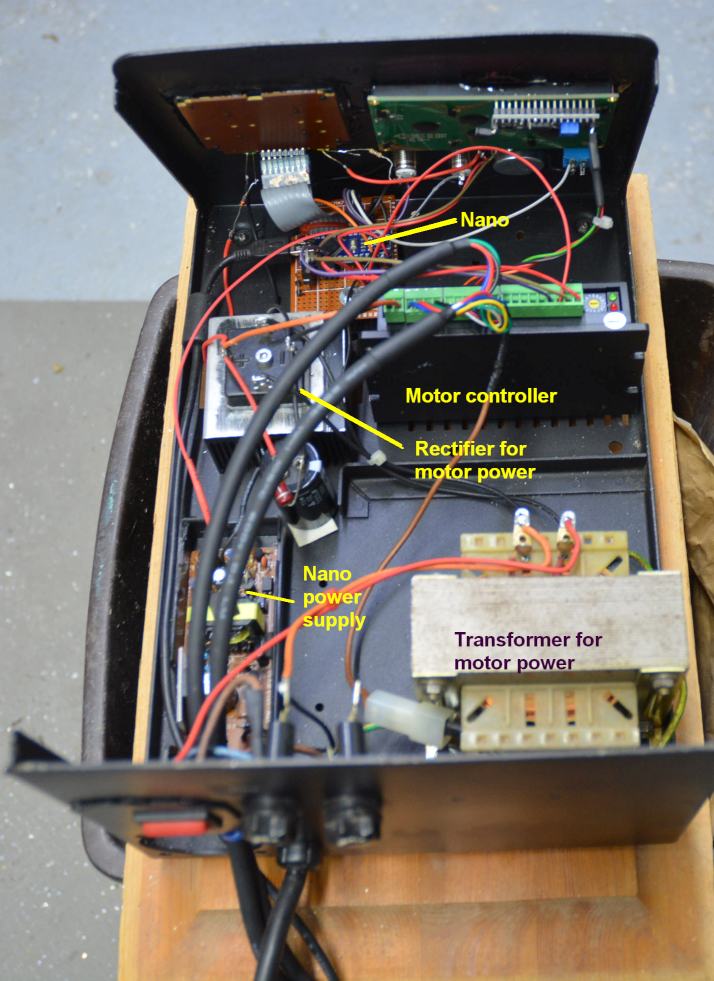

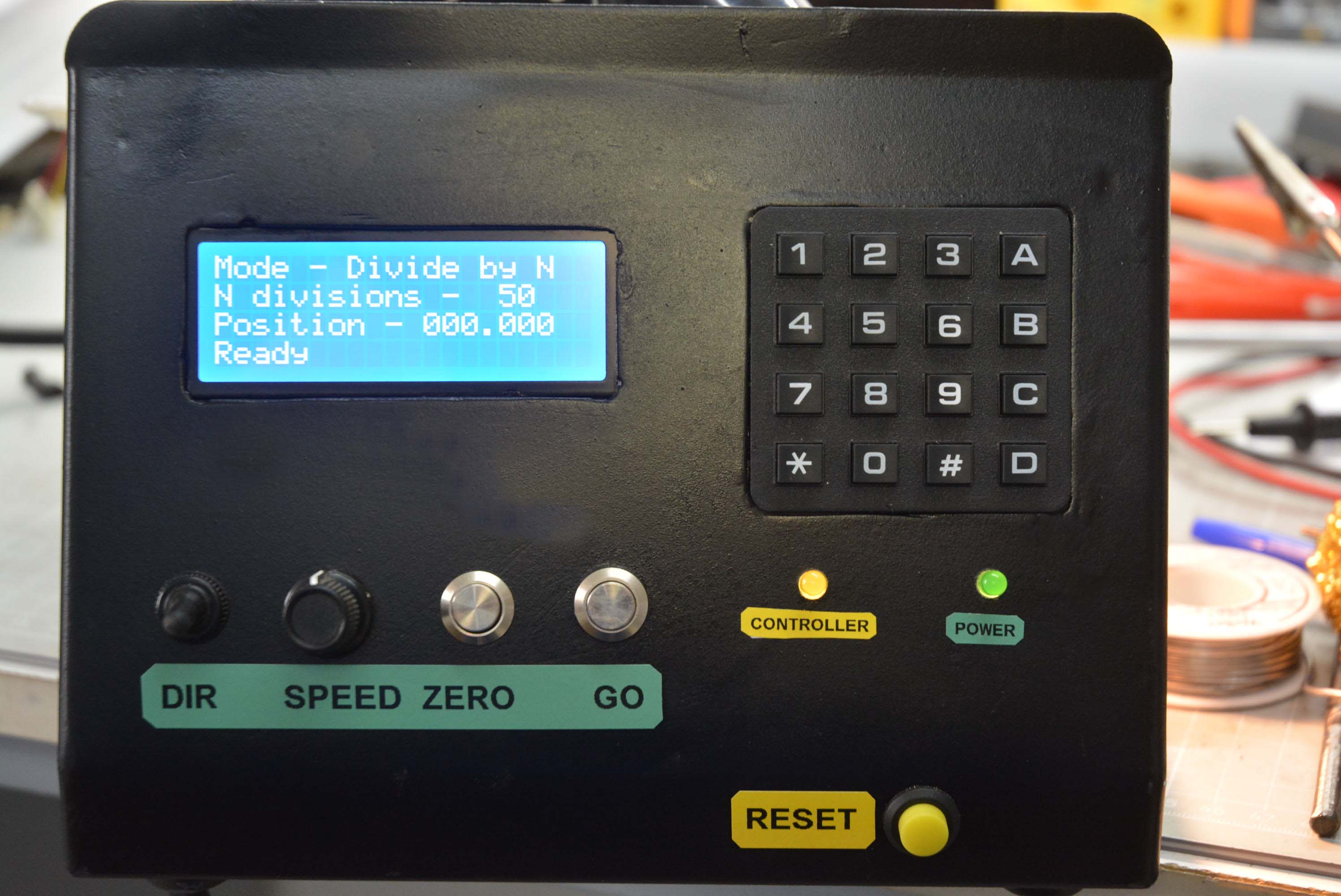

    Anyway the purpose of this post is to enquire whether you are still interested in looking at different coding possibilities. I am quite willing to share my code if you wish. It is only 250 lines and uses a single Arduino Nano. In the meantime here are some pix. Click on them for full size.
    The controller. This contains a simple transformer/diode bridge and capacitor power supply for the motor as well as a small power supply for the Nano and display.

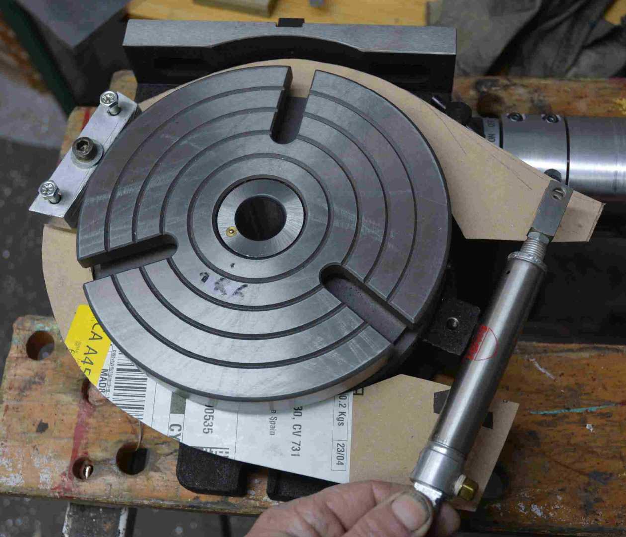

    This shows the cardboard templates for a pneumatic brake. Which locks the table when stopped. The software controls this automatically.
    I use a closed loop stepper and controller. This ensures no lost steps and the controller takes care of everything.

    Looks like a nice setup. Are you able to adjust the speed during any operation like when moving by degrees? I am interested in getting the code.

    Tony, would be real handy just to post the 250 lines here, as it's easy to copy paste into an Arduino sketch.

    What is the resolution of a step? (0.1, 0.01, etc., degrees)
