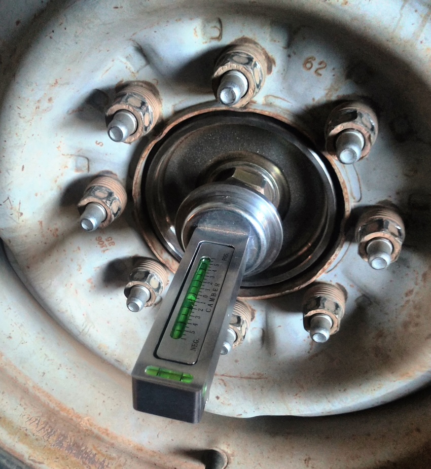

Mount for caster camber gage

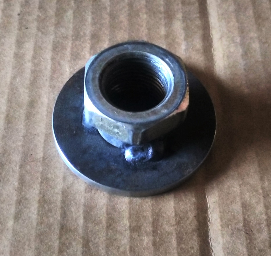

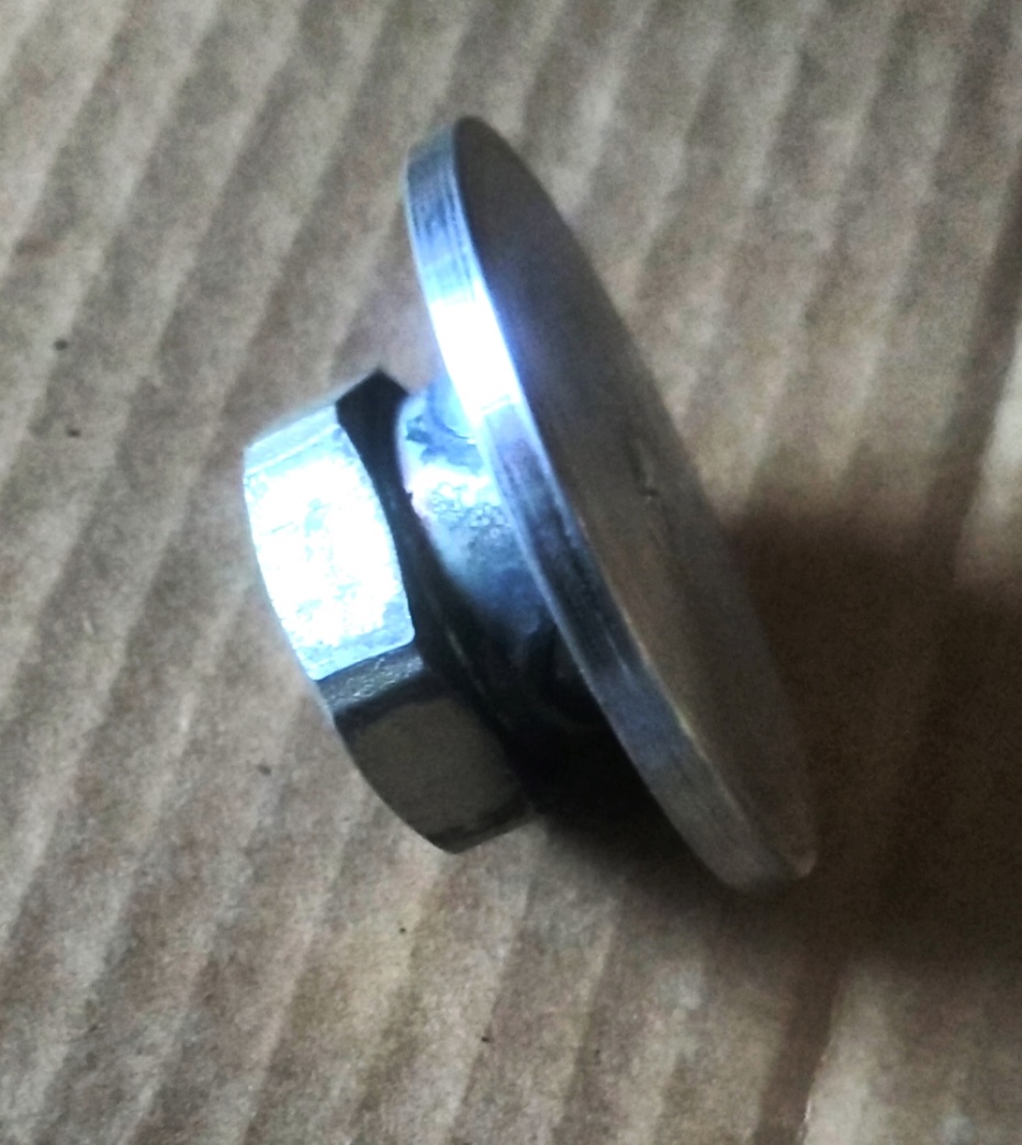

I needed a way to mount the magnetic Caster camber gage to the axle on the GMC pickup since I had replaced both CV assemblies I had the old spindle nuts that I cold thread on the few threads sticking out of the axle I welded a disk to them and machined them true then stuck the gage to them.
Attachment 45440
Attachment 45441
Attachment 45442
these inexpensive gages work great but you need to zero them against some known perfectly vertical member prior to use each time.
