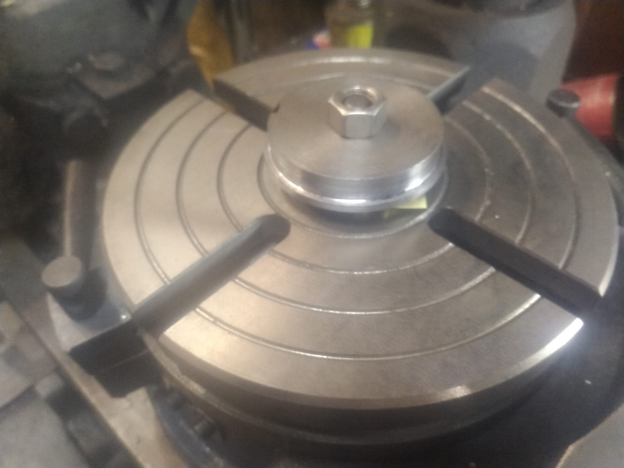

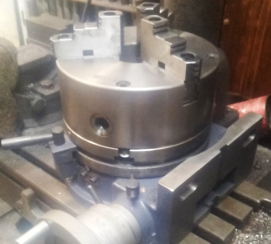

I have a small Vevor rotary table Vevor is admittedly not the highest quality tool manufacture nor is it the lowest in several areas.
One thing the little 8" rotary table has going for it was the price and after all sometimes all I need is something that can be rotated on my bench mounted Enco round column mill. However the addition of a 3 jaw shuck enhances its usefulness
Here is wat I did first T machined a centering stub shaft then through bolted it in the rotary table
Attachment 50544
Attachment 50545
