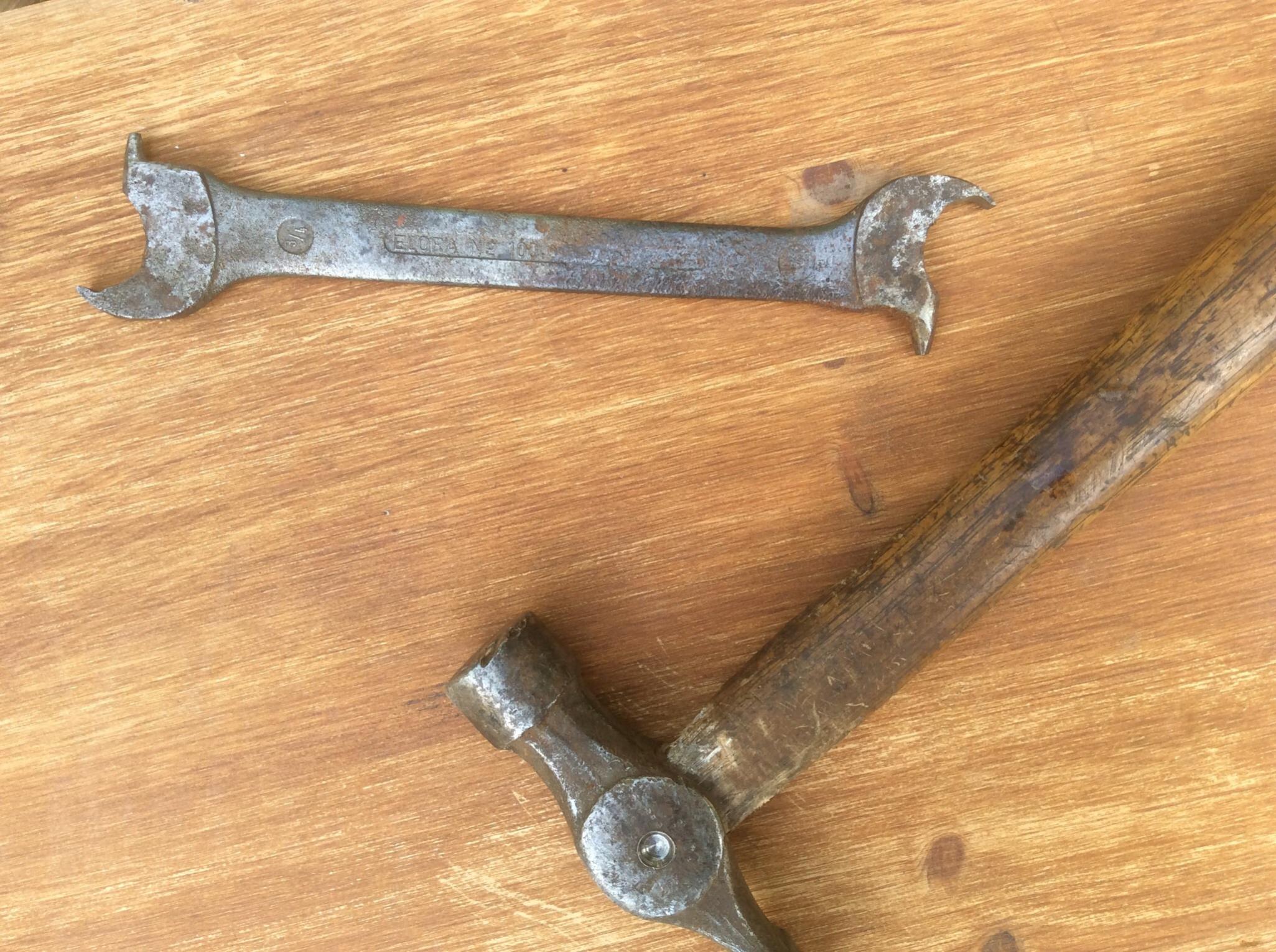

Attachment 12627

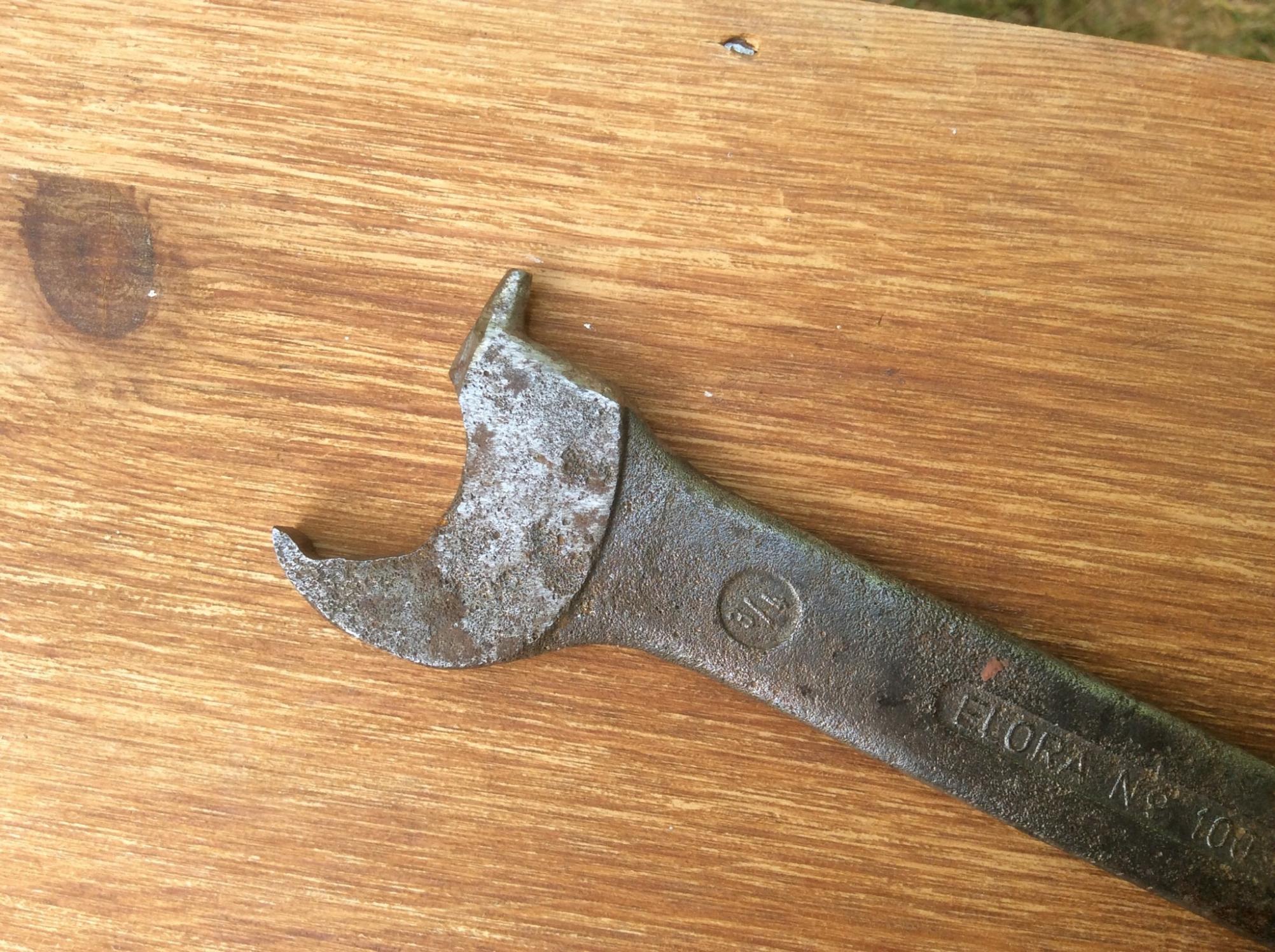

Gripping the conventional nail punch is hard on the fingers, I find, increasingly as I age. I saw in a catalogue a Japanese nail set. I ground an old spanner to suit. The tool is also a pry bar.Attachment 12626

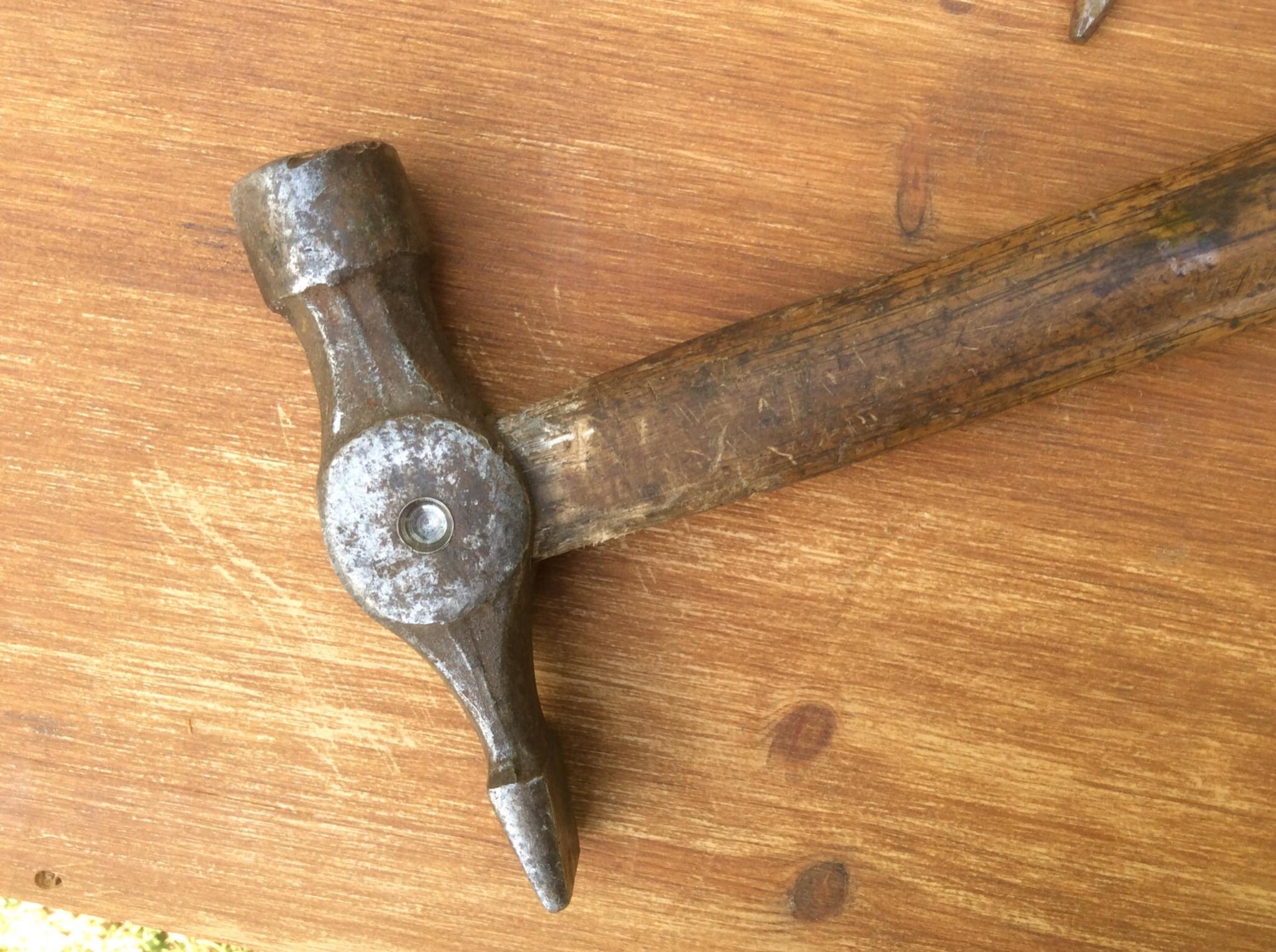

Can you make out the dimple on the hammer? It is for heading rivets.
