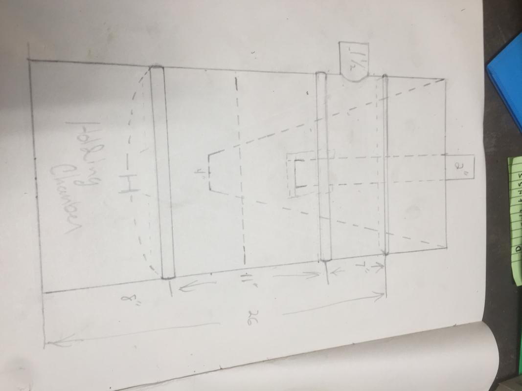

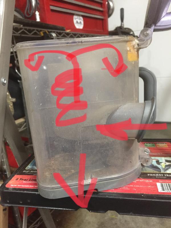

How I got the idea for this was one night a while ago during some research on the inter~web I needed to a break to let my thoughts settle and grabbed the vacuum cleaner to vacuum up my shop floor and work benches ( yes I said vacuum cleaner not shop vac! It’s our old house one and works great 👍 for cleaning shop floors~better than broom and dust pan!!! Faster too) it does not have a cyclone or multiple cyclones in it but it is bag less..it is a cyclonic style. I’ll post pic of it... but anyway as I was doing this the 💡 came on and then confusion/dyslexia set in at same time....lol

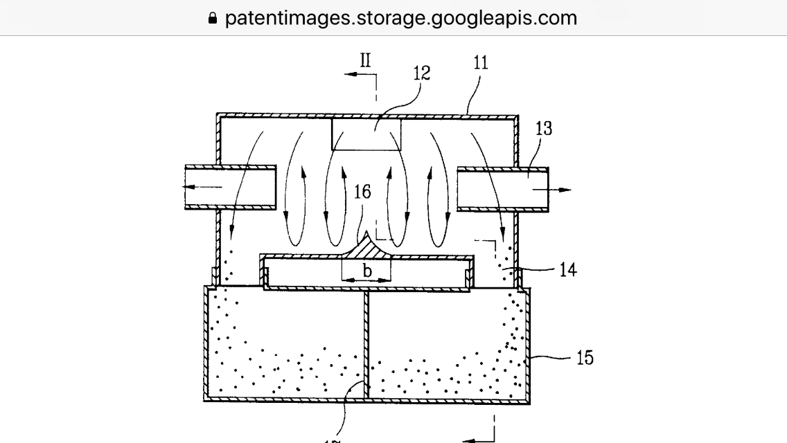

I would like to build a bag less all~in~one system to reclaim~separate~and filter out the fine dust blast media or sand using a shop vac... I am not sure if I want to make an R2D2 pancake system or not yet. I have 2 different shop vaca. One is a standard Crapsman wet/dry 3.25 hp 8 gal one that blows exhaust out the sides below motor. The other one is a 16 gallon Hoover 2 tank wet/dry with a wet tank and dry separator switch that has 216 airwatts of suction (which I have found out that is a true suction reading vs hp~but I can’t find what it converts to as hp) and has a blower accessory port but also exhausts like other on.

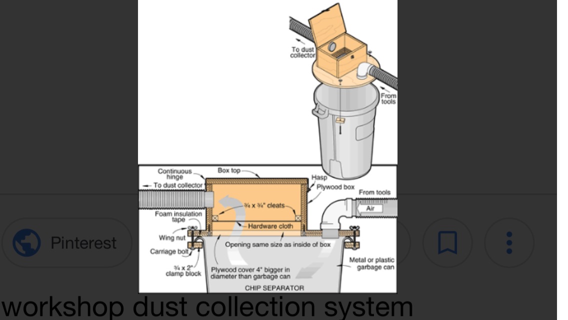

I learned from from a different sight that a cyclone system takes more to pull air through than Thien’s baffle system.

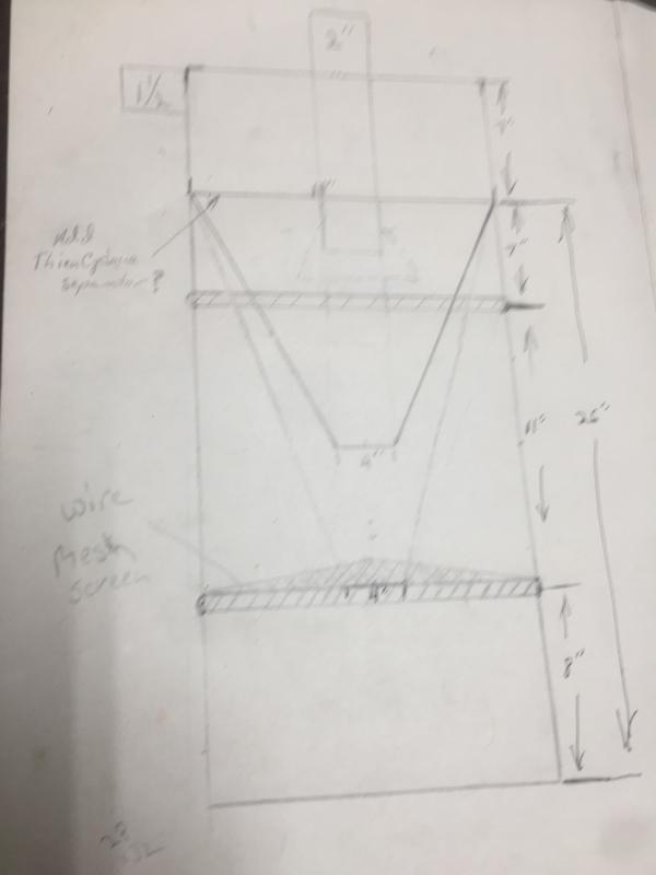

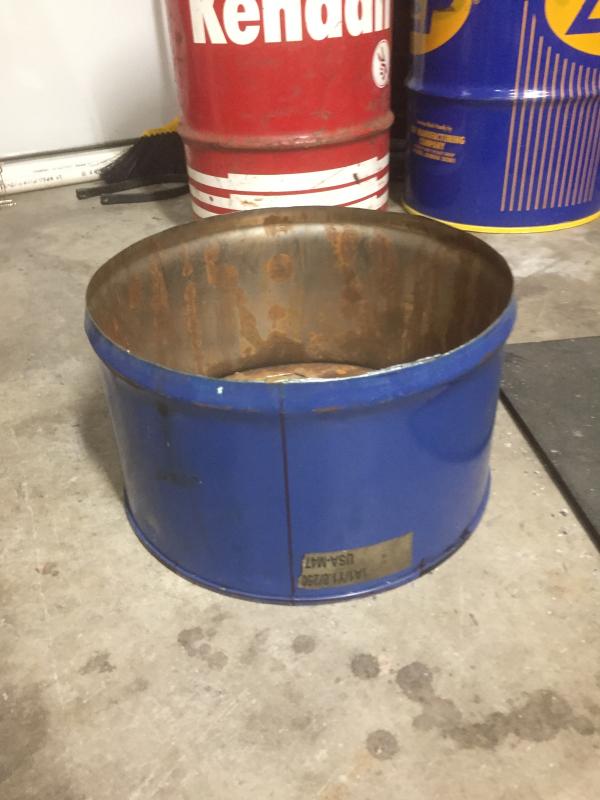

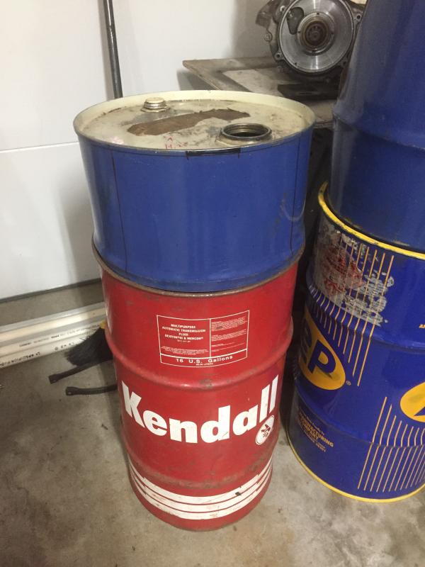

So that being said... what I want to build (and since I’m trying to reclaim sand everything needs to be metal) since space is a problem I’d like to try and build a cyclone inside either one of my 30 or 35 gal metal oil drum. Or I can build a Jp baffle top hat system or combine them both. But here’s the one of the problems I also need help with... i need to pull media/sand from blast cabinet and separate the media/sand from dust/garbage and have the dust in a separate container or compartment. Preferably on top of drum. I have drawings of what my thoughts are that I will post.
Has anyone tried putting a cyclone inside drum instead of on top like a vacuum cleaner?

I’m adding some pics of a horizontal system that I stumbled across and looking for thoughts on that too...
