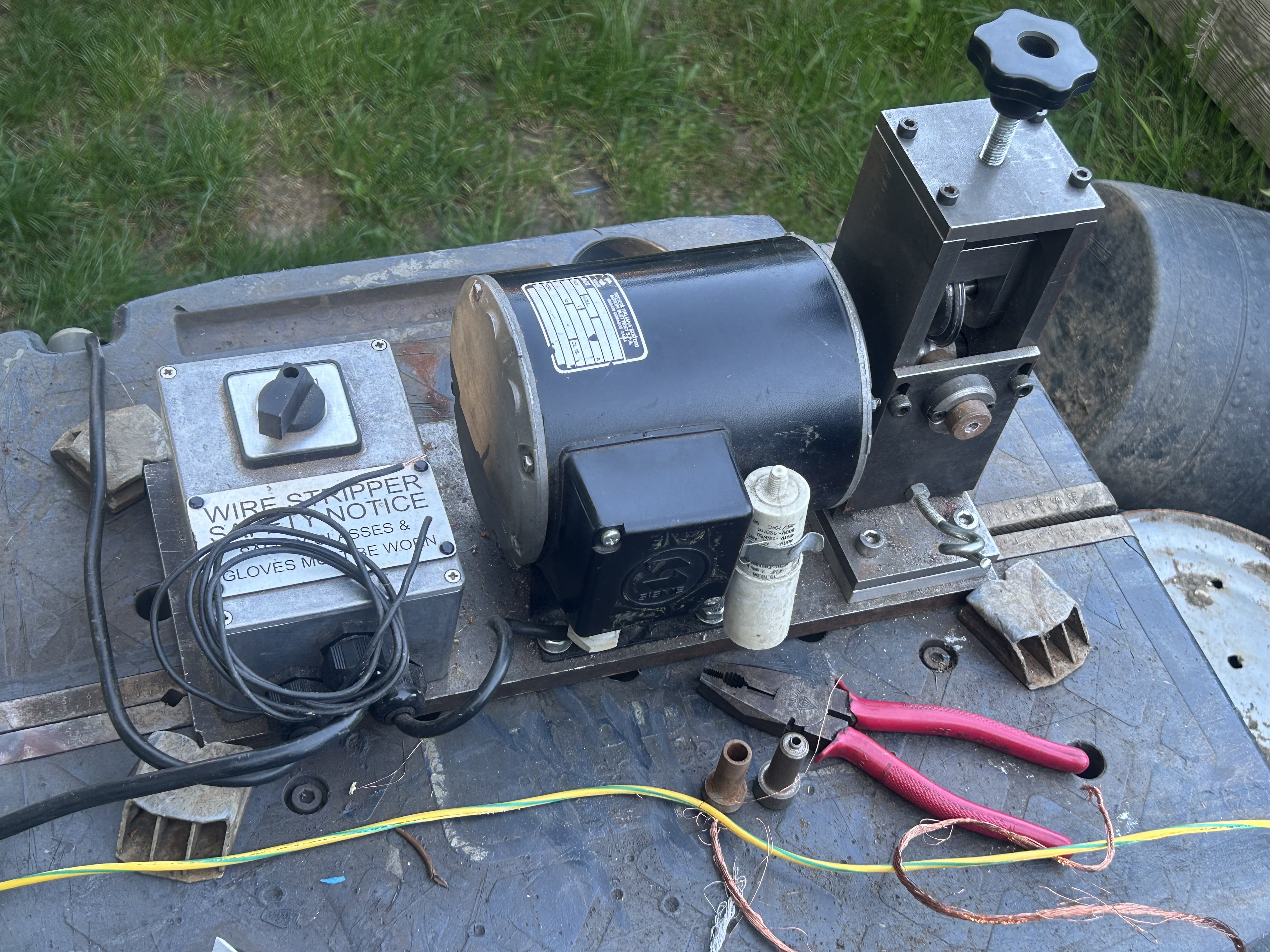

Have a lot of cable so decided to make a cable stripper machine to maximise the current copper scrap value.

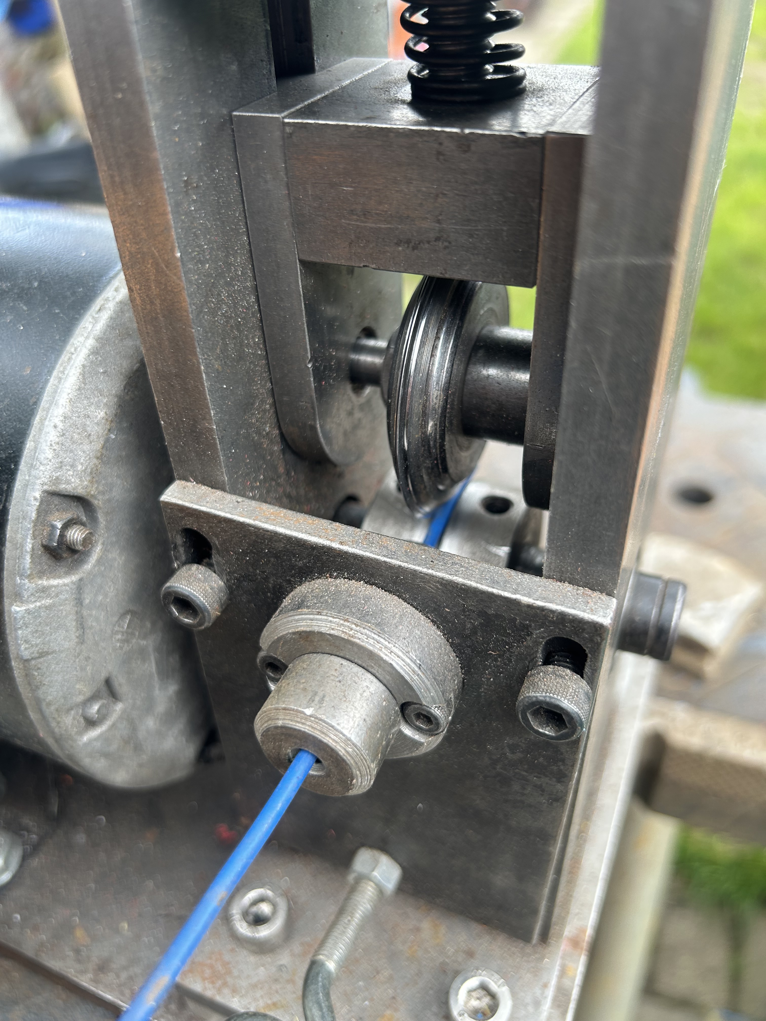

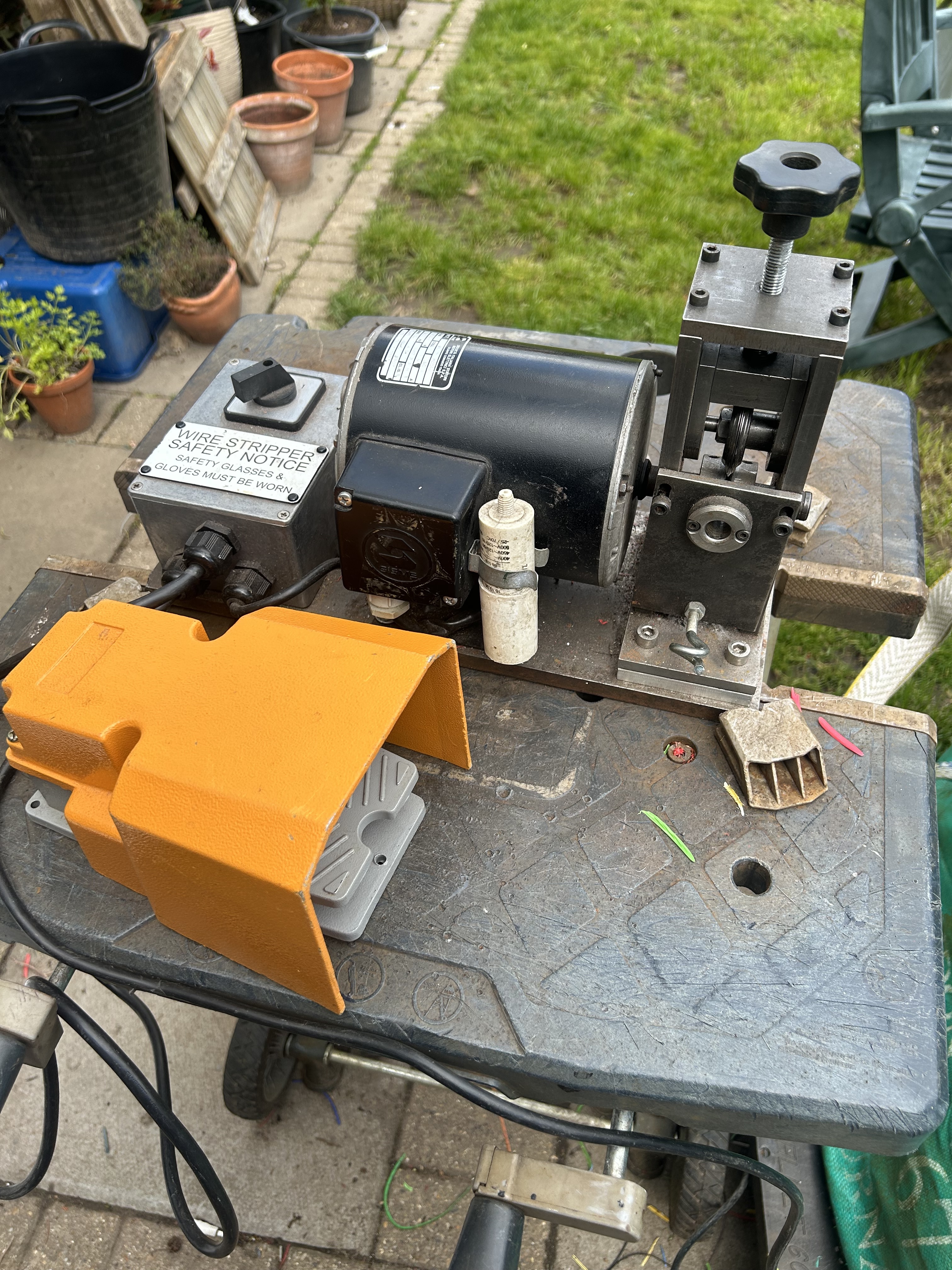

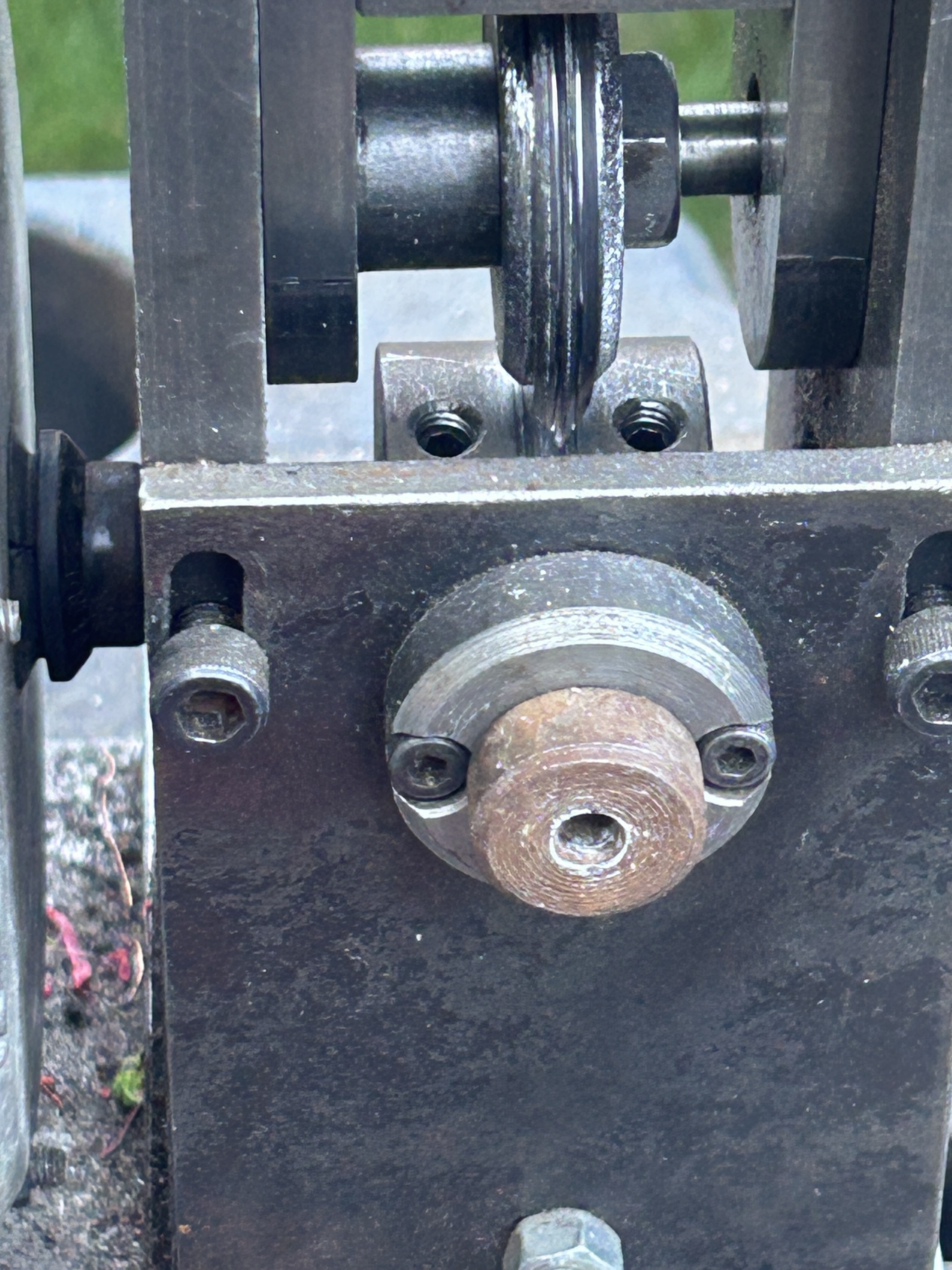

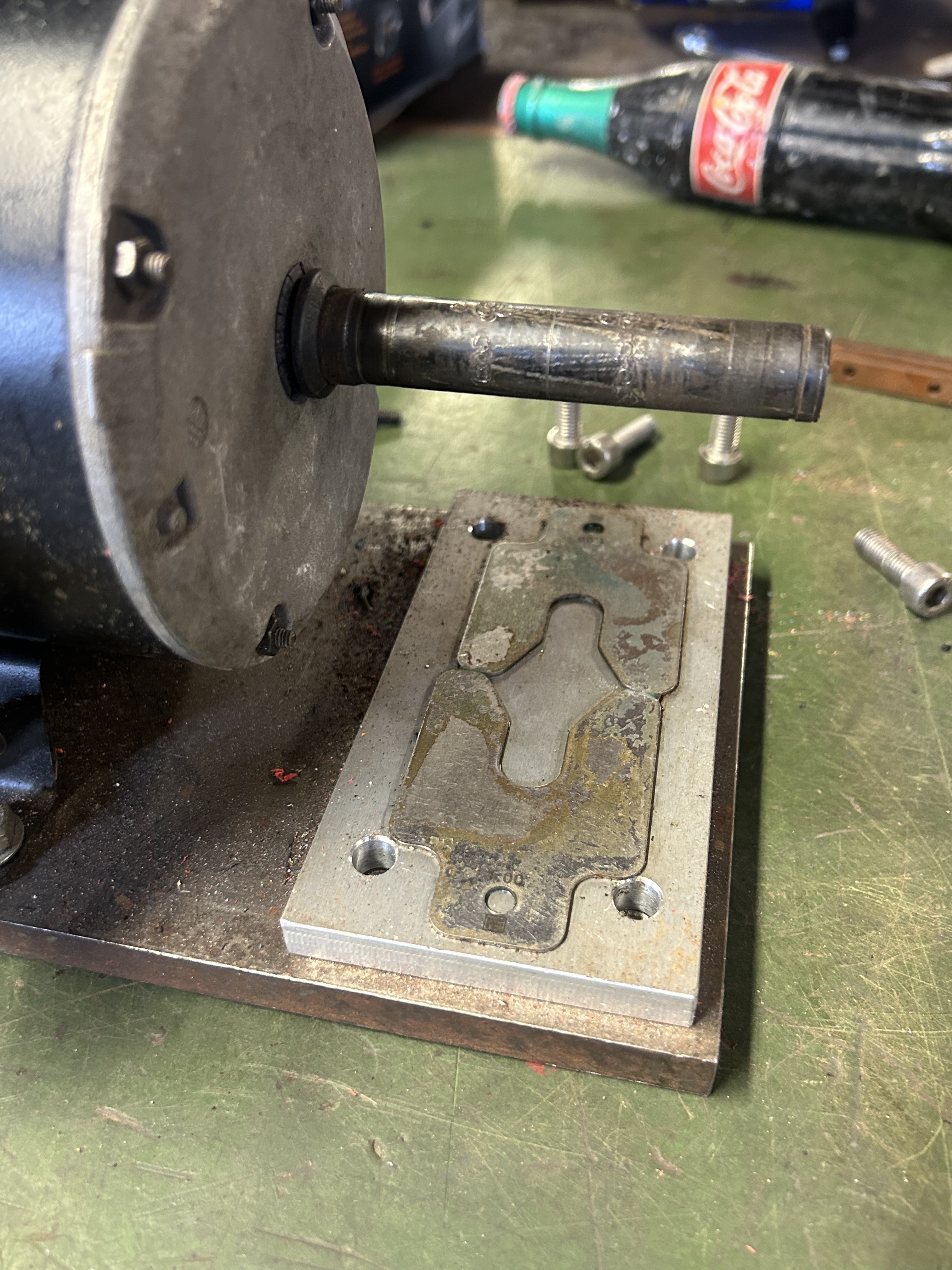

The machine was designed around the motor I had lying around, as the output shaft was a decent length to support on two bearings and fix a vee groove driver. The body of the machine was cobbled together and the cutting blade made from gauge plate and hardened and tempered.

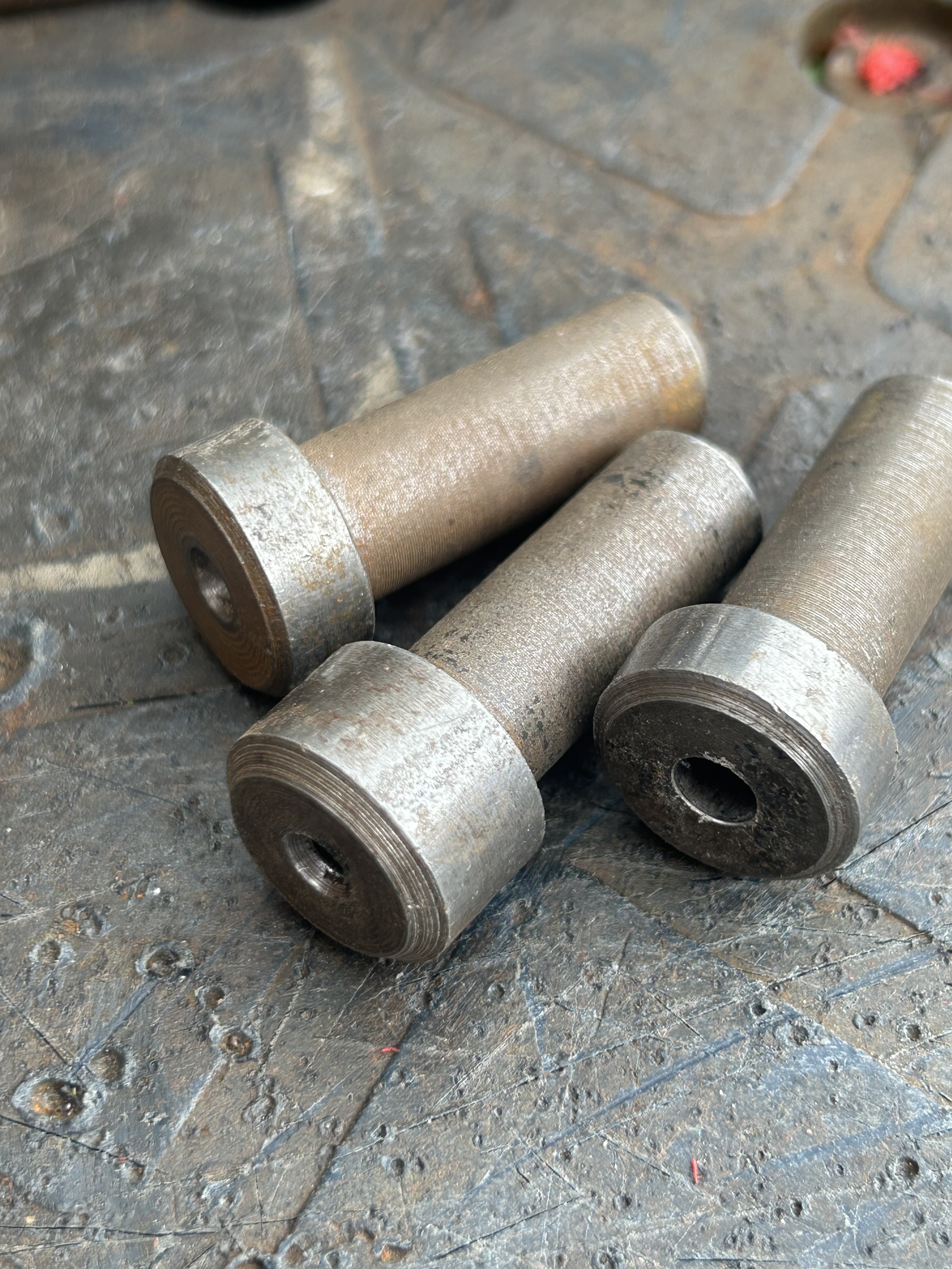

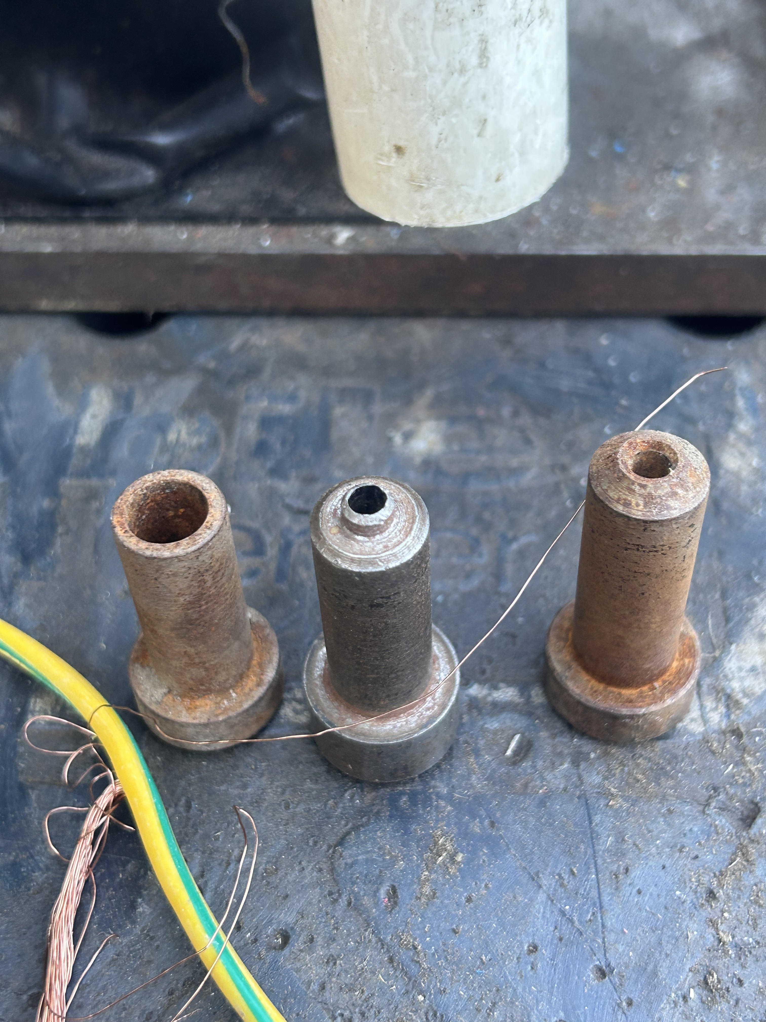

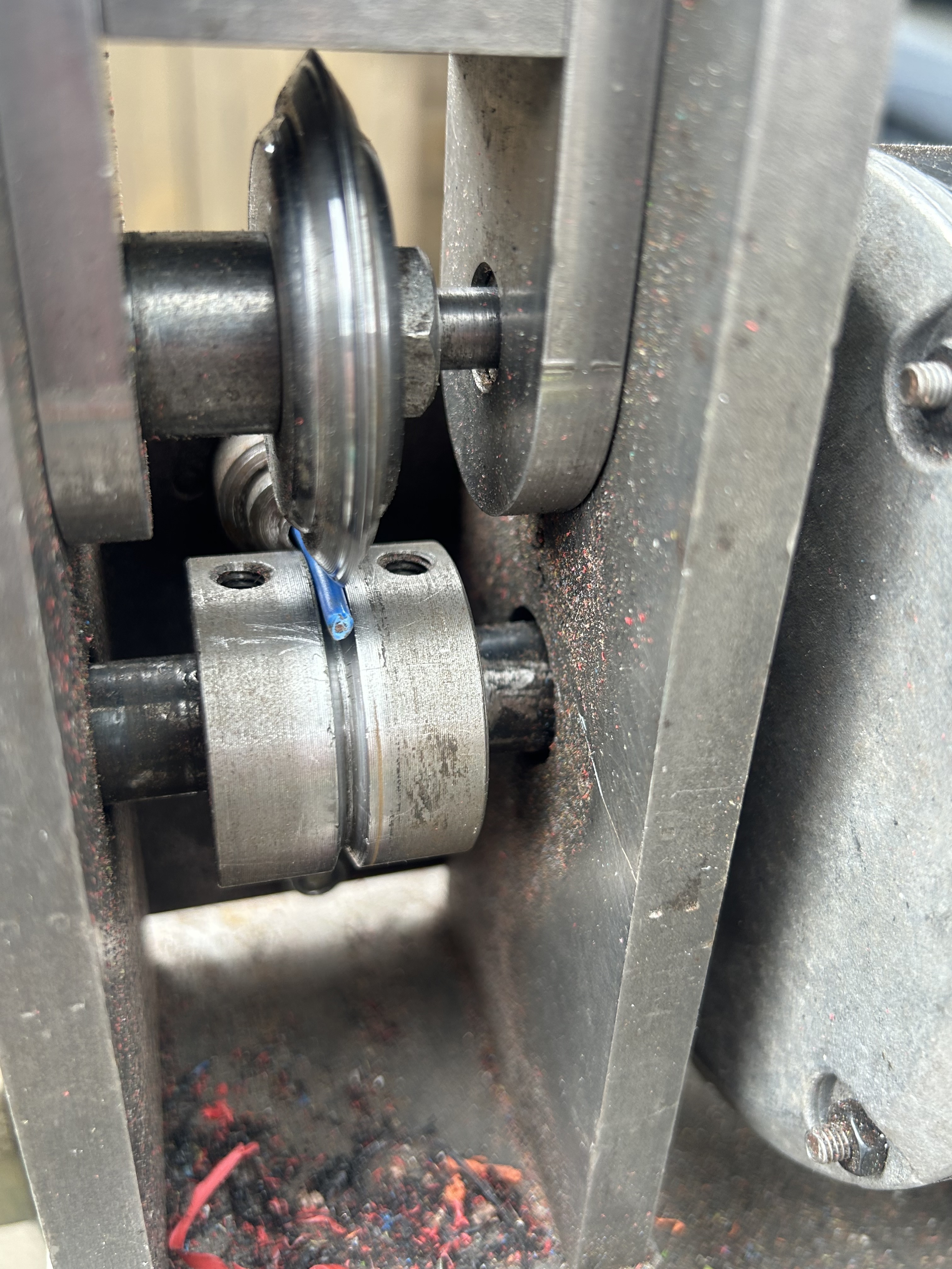

To enable smaller gauge wire to be stripped a few collets were made to align the wire as close to the cutter and central to the drive vee so it couldn’t wonder away

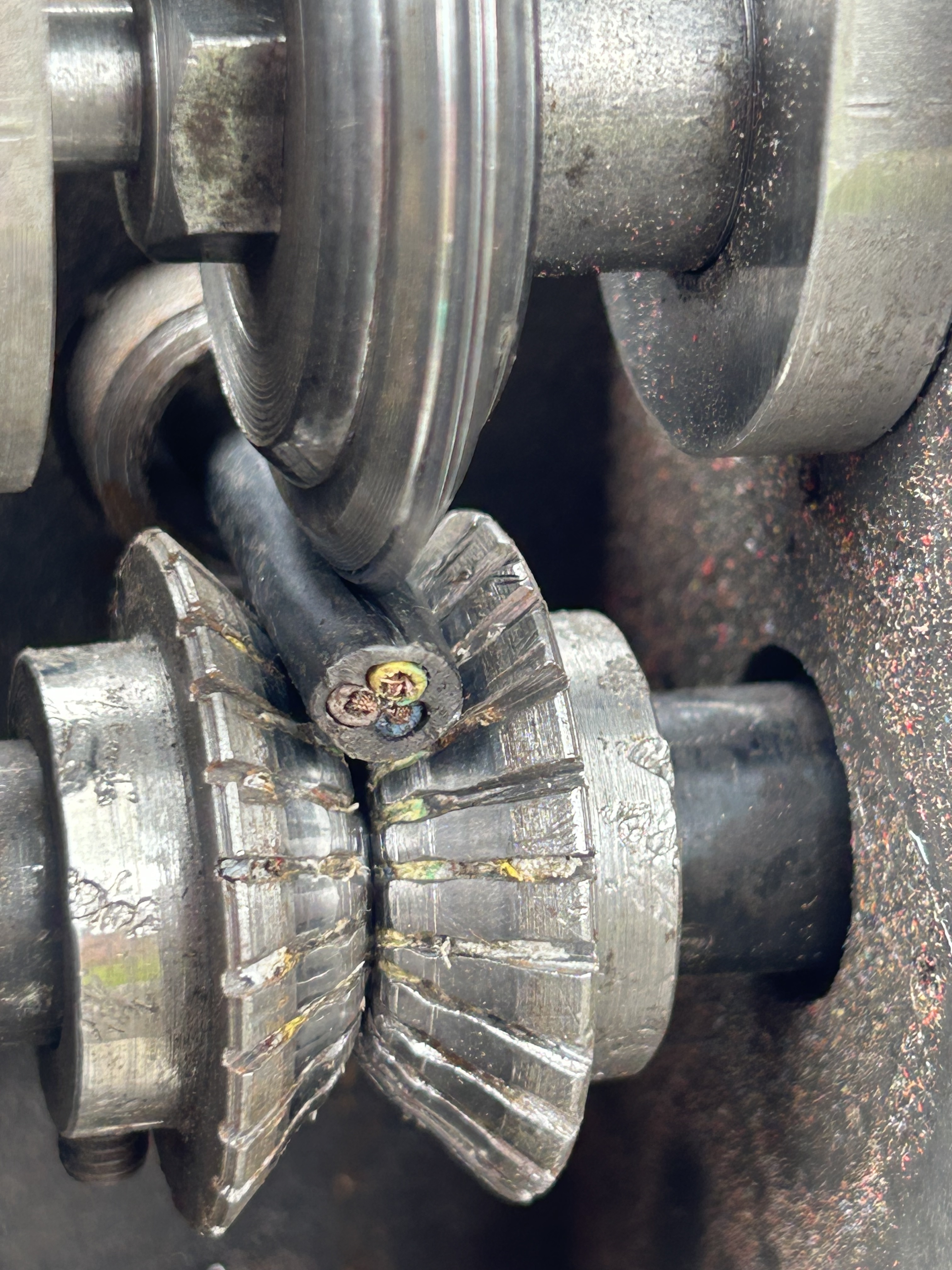

To cut large cable the vee drive can be swapped out for a larger vee drive.

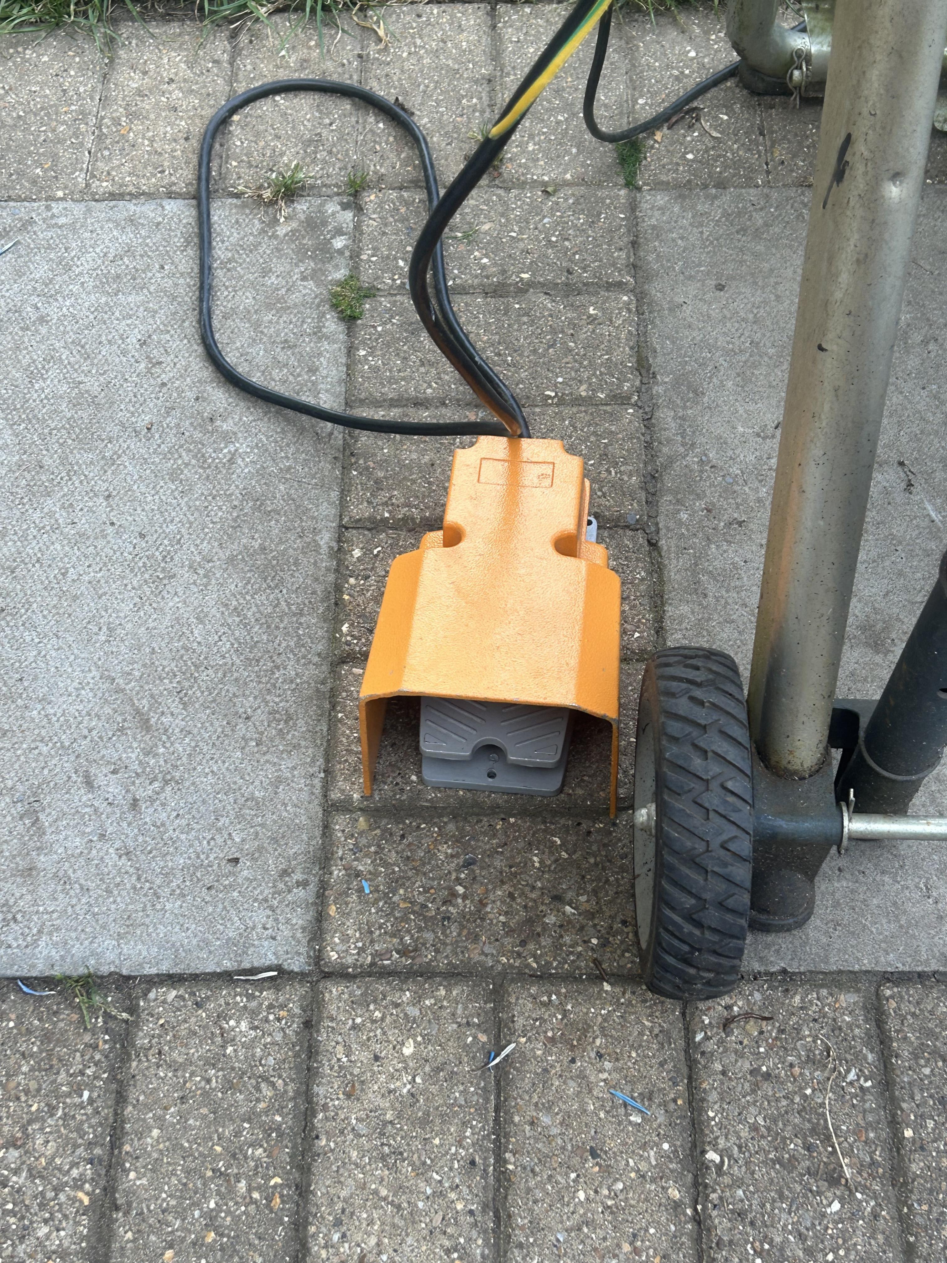

The machine is operated via a foot pedal so the machine is not constantly running.

Attachment 47791Motor on base plate and shims to get the cutting assembly to the correct height.
Attachment 47780 Attachment 47785 Attachment 47788 Complete machine.
Attachment 47781 Attachment 47792Collets for different diameter cables.
Attachment 47782Collet in place to feed cable into the cutter and lower drive wheel attached to motor output shaft.
Attachment 47784 Attachment 47786

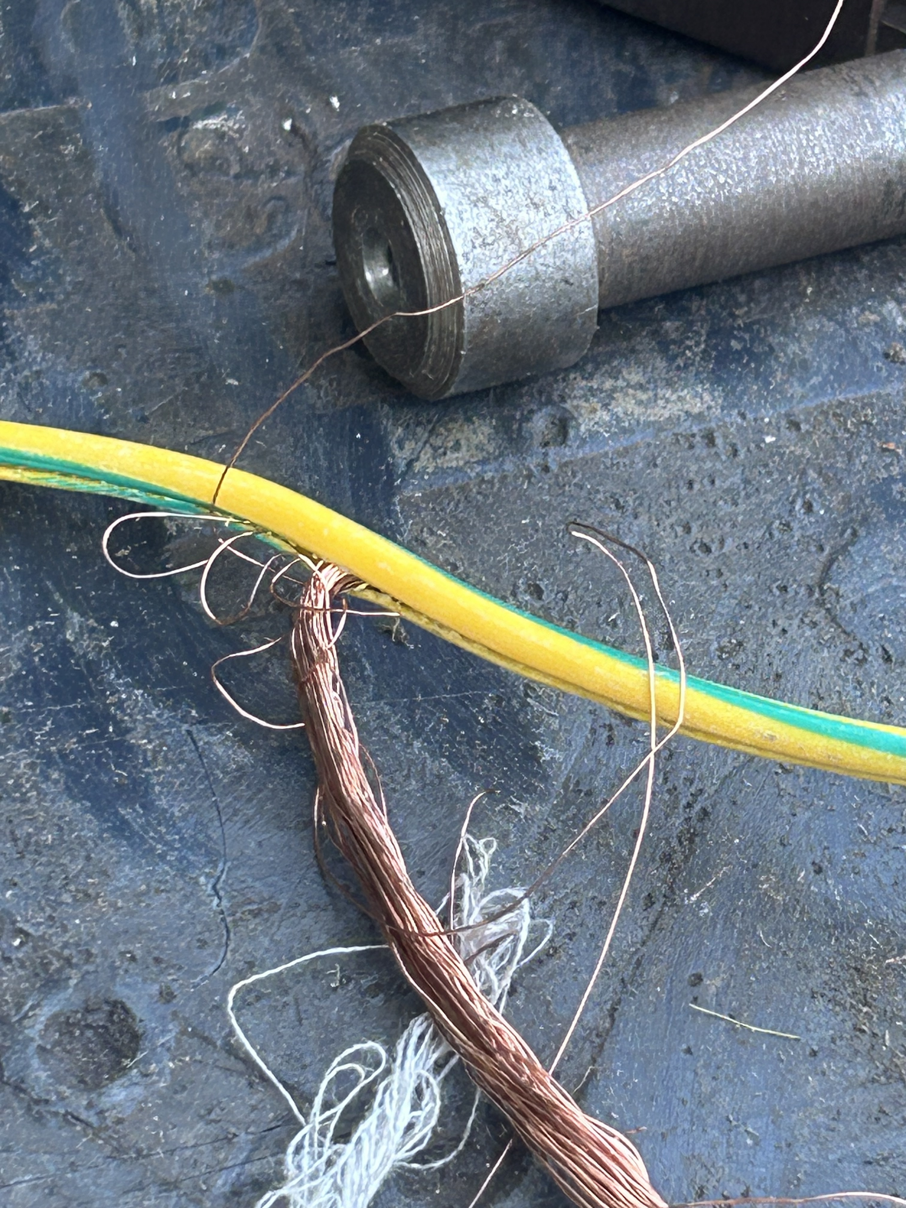

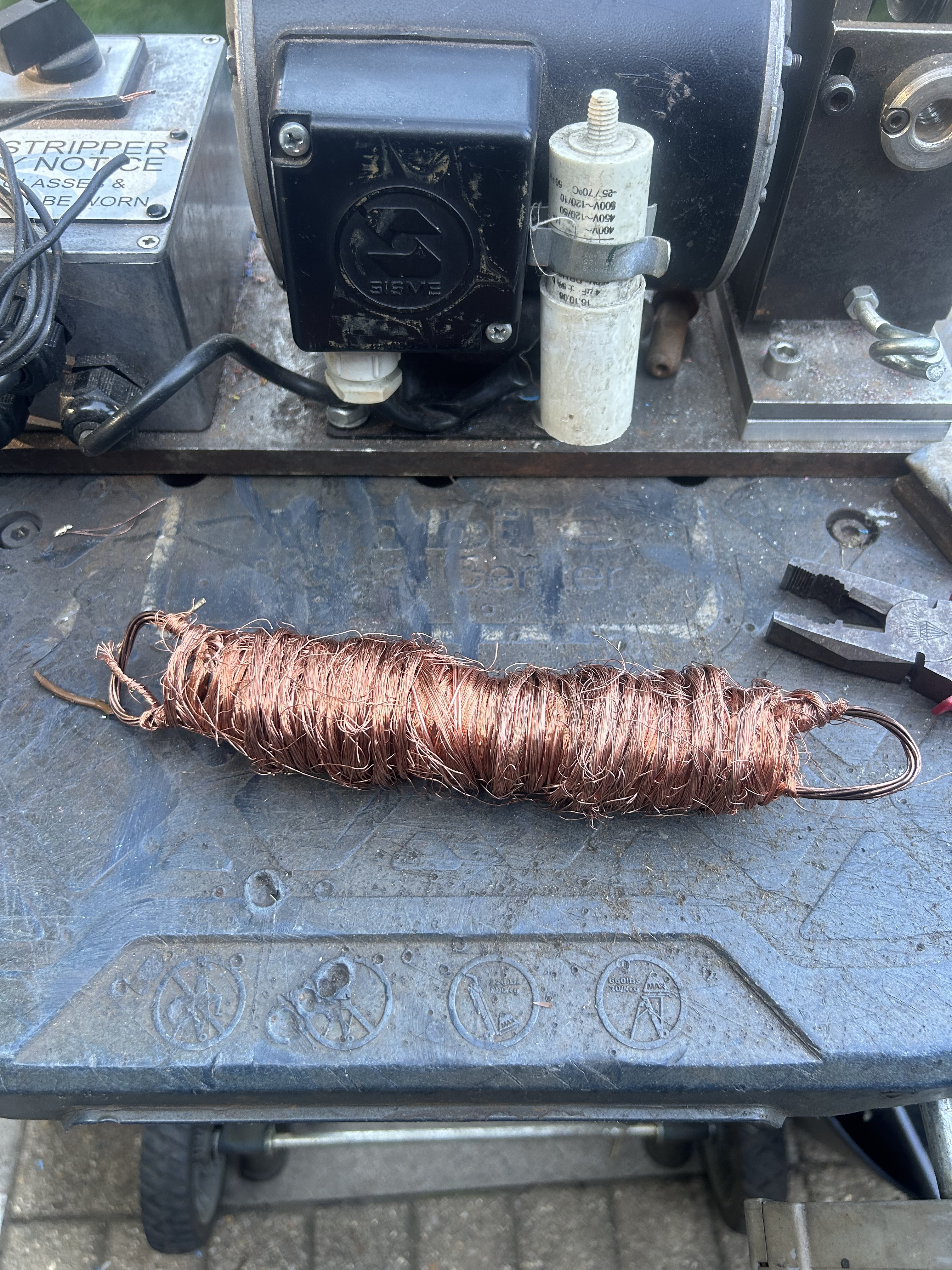

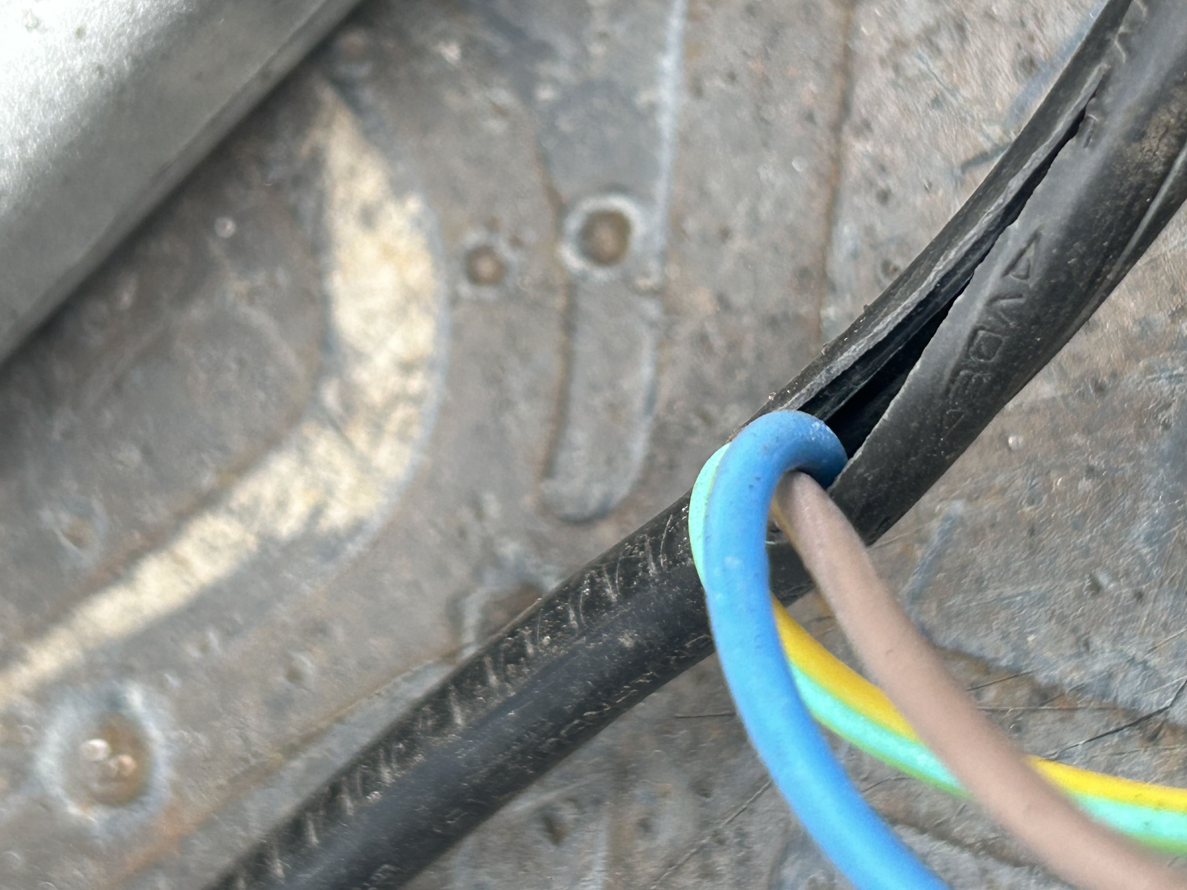

Attachment 47790 Attachment 47789The cable flies through the machine and the copper is easily removed.

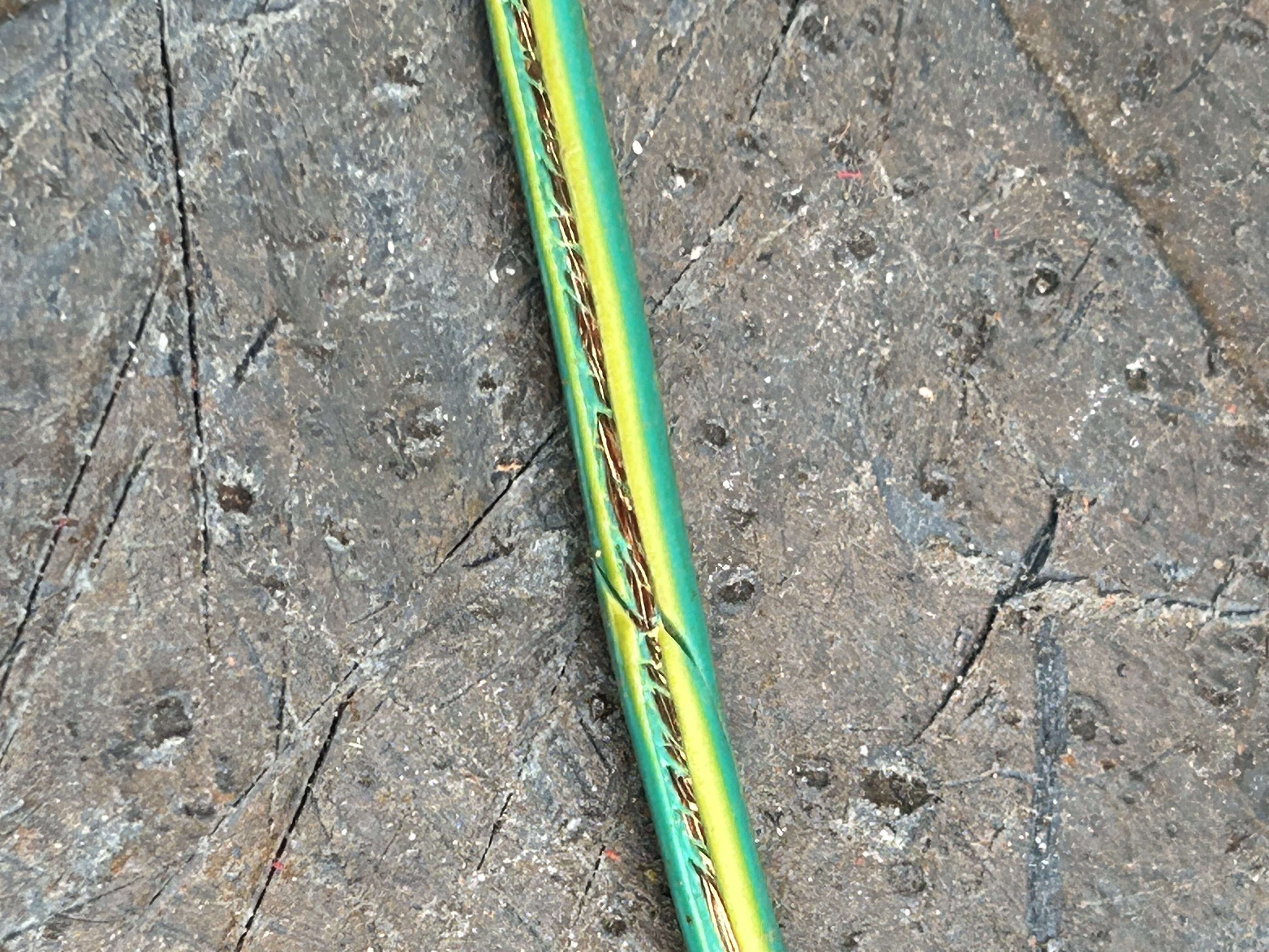

Attachment 47783 Attachment 47787PVC insulation scored to allow copper to be removed.

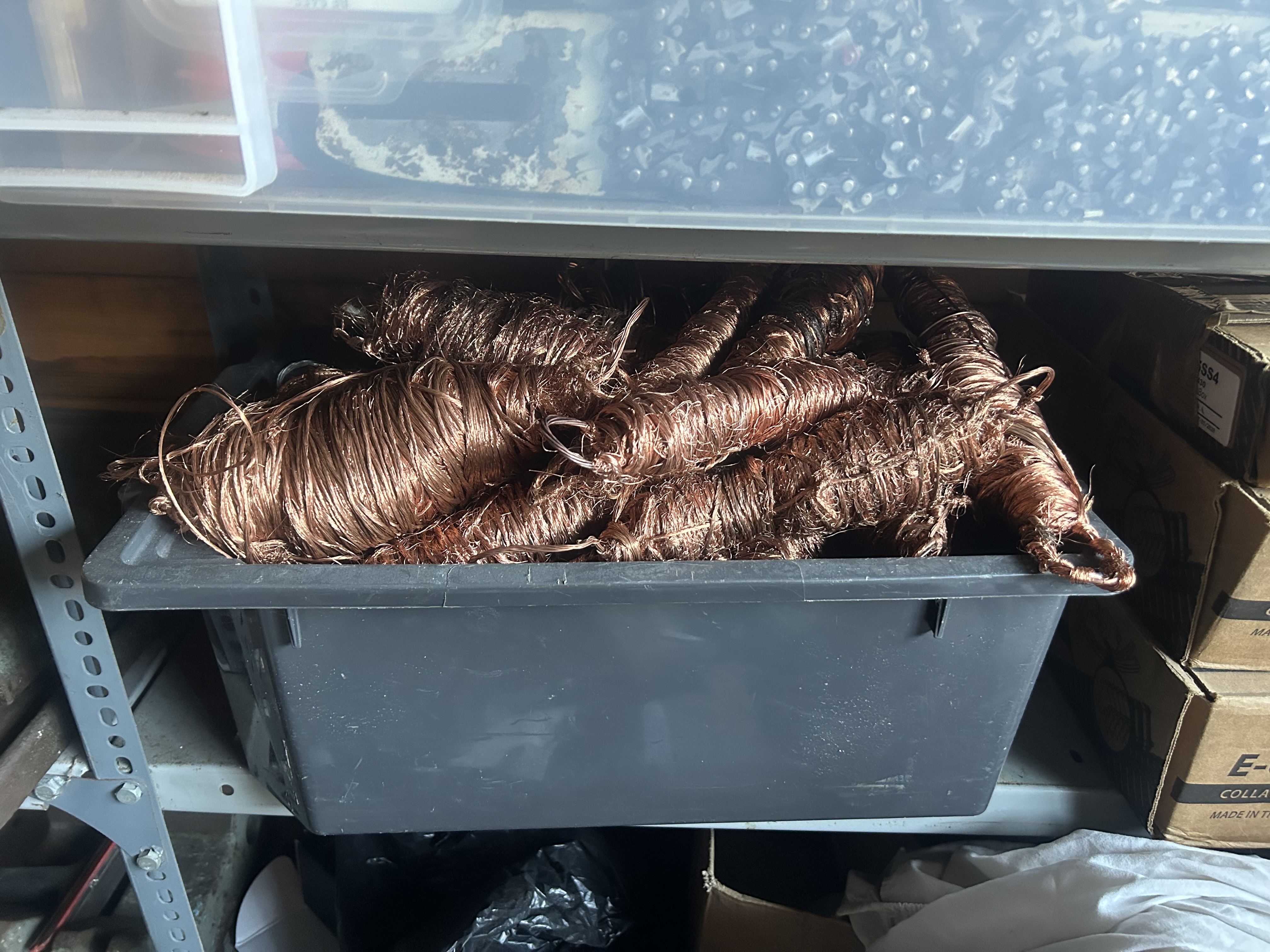

Now for the money shots! Just wait for the price to be right and then weigh it in.
Attachment 47793 Attachment 47794
There is a lot of talk is it worth stripping cable? time and effort vs return. My answer is this was a fun project to build and it works. Haven’t worked out my hourly rate, but the extra cash will help towards bits and pieces for the house refurbishment. So for myself a lot of effort but great to see the copper pile up.
