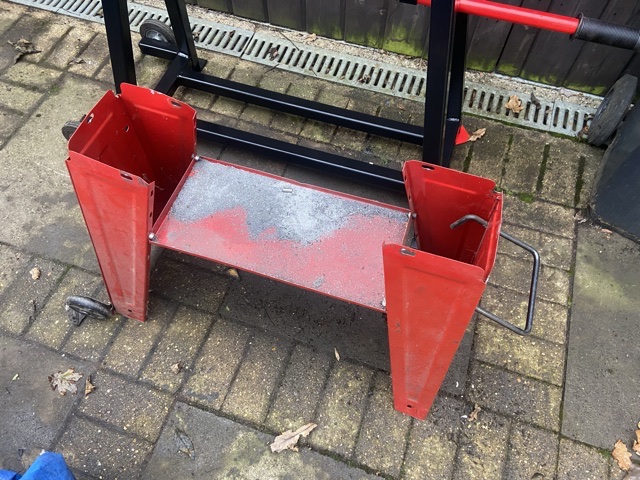

Attachment 41250Photo of standard flimsy sheet metal base

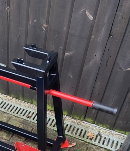

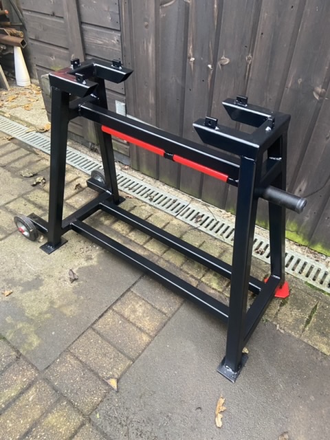

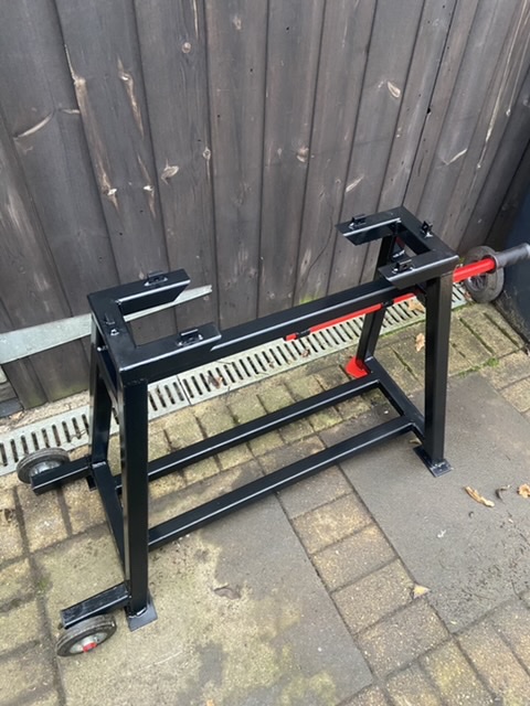

Attachment 41252 Attachment 41254 New stand made from 40mm x 3mm box section (had this left over from another project)
Attachment 41253 Handle slides out to aid moving the saw around the shop

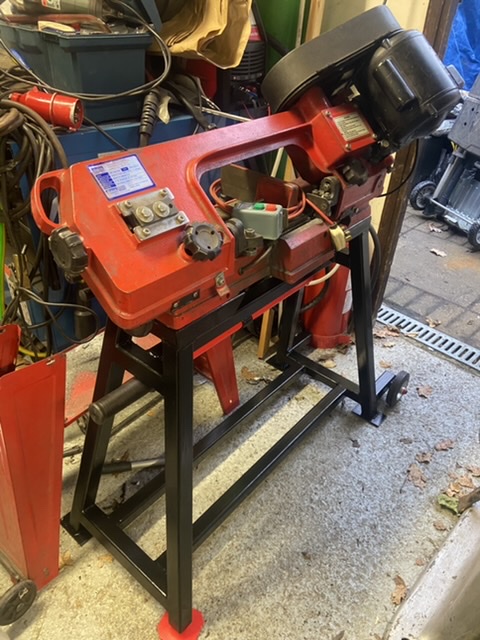

Attachment 41255Saw in place waiting to be permanently bolted to new stand.
