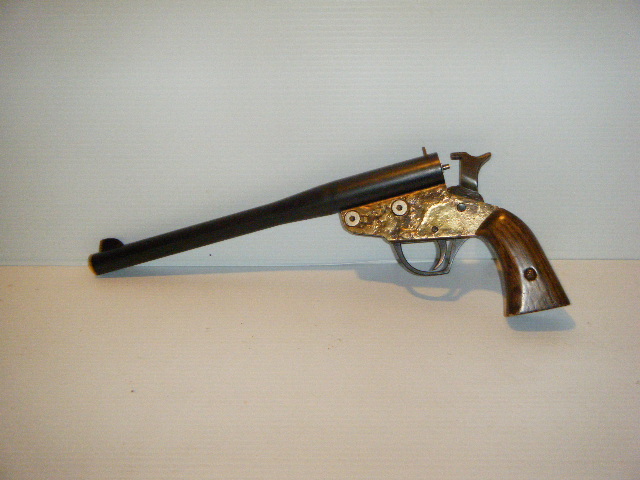

Ken here are a few pics of my BP pistol.
As far as my next projects I'm wanting to build a rifle. Also thinking about experimenting with finned sabots or bullets to shoot out of this smooth bore.

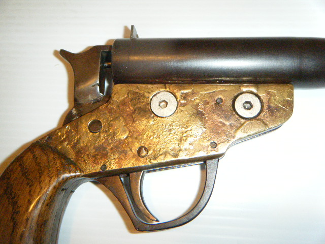

Very cool, indeed! :hattip:
Did you cast the frame and side plates yourself? Do I detect a little color case hardening, too? Impressive.
I think it would look great with fire blued screws… :cool:

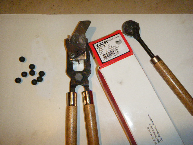

What's the powder load? 35-40 gr. or a bit more?
Ken

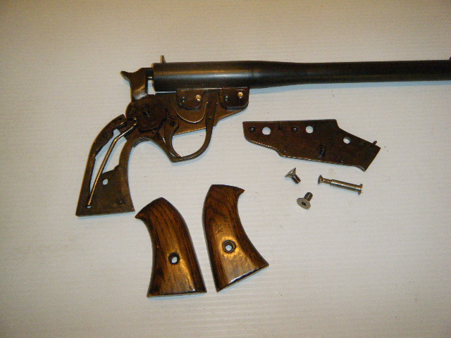

I spent 3-4 years building on my spare time. While building I was all over the board on how to finish. I really wanted to blue it, and nickle plate the side frame, then I thought of plating brass and milling it to a smooth finish. Once I came up with the moon surface finish a friend suggested that I brown the barrel. That's what I did here. The only part that I ended up milling was the trigger assy. The trigger guard and all frame work I welded up and ground and filed down. Lots of file use. The screws are stainless steel and I was not able to get them to color. So I painted them. Presently shooting 40-50 grains 3f BP. I did test 100 grains by securing it to a board and a string on the trigger and standing behind a tree. MAN was that loud, but it held up. I think 50 grains is all I care for.

Beautiful work Sking0369! Curious to know how you created that amazing "Moon Surface"? An acid etch of some kind? 100 grains in a 44...Wow, great that it held up...says lots about your work on this beauty! Thanks for posting, look forward to more! ~PJ
