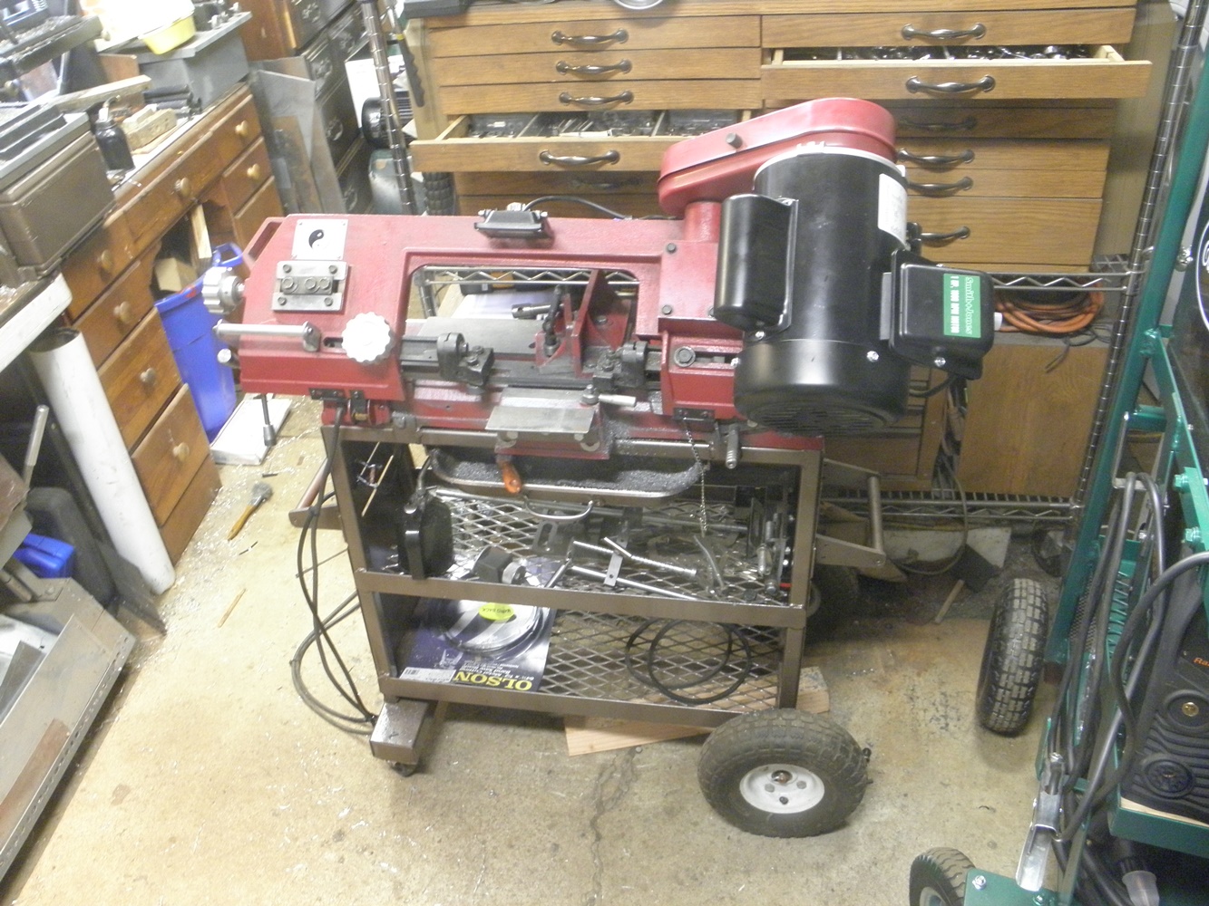

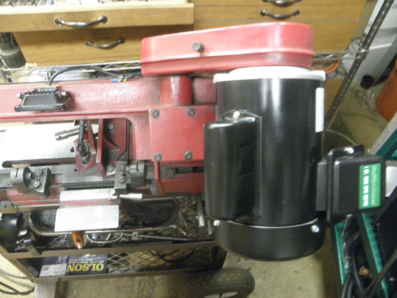

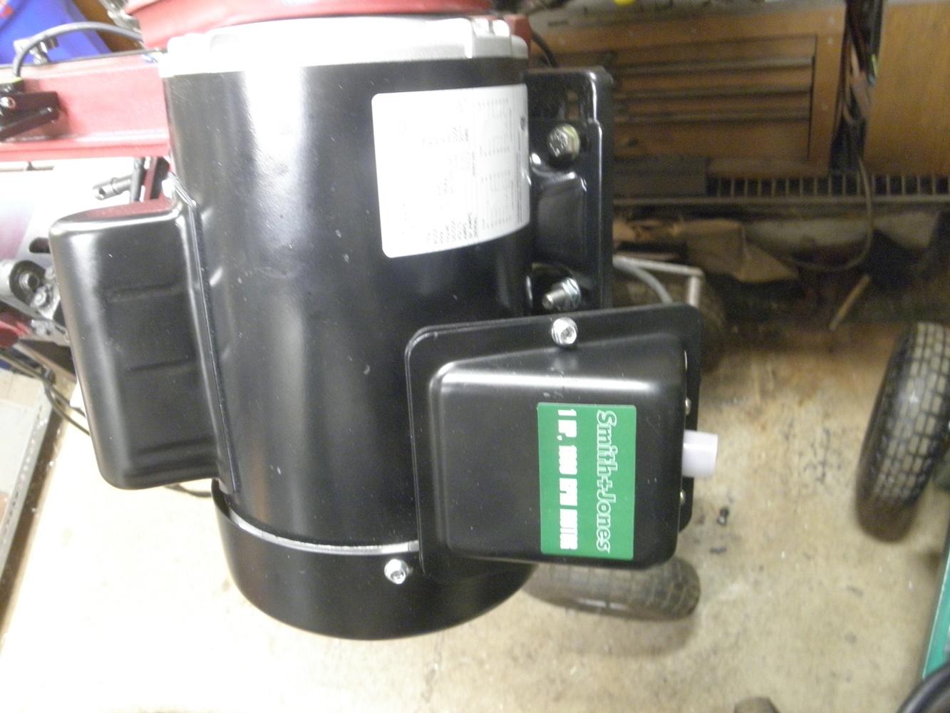

New HF Motor for Band Saw. 1 HP 1765 RPMS 5/8 inch shaft 120/240 volts 10 Amps $164.00@ HF. need to drill out pulley from 1/2" up to 5/8" for the motor shaft to fit. Also need to trim belt guard bottom a little for this motor. I think this new motor has more torque as it jumps a little what a beast.....Cap.
