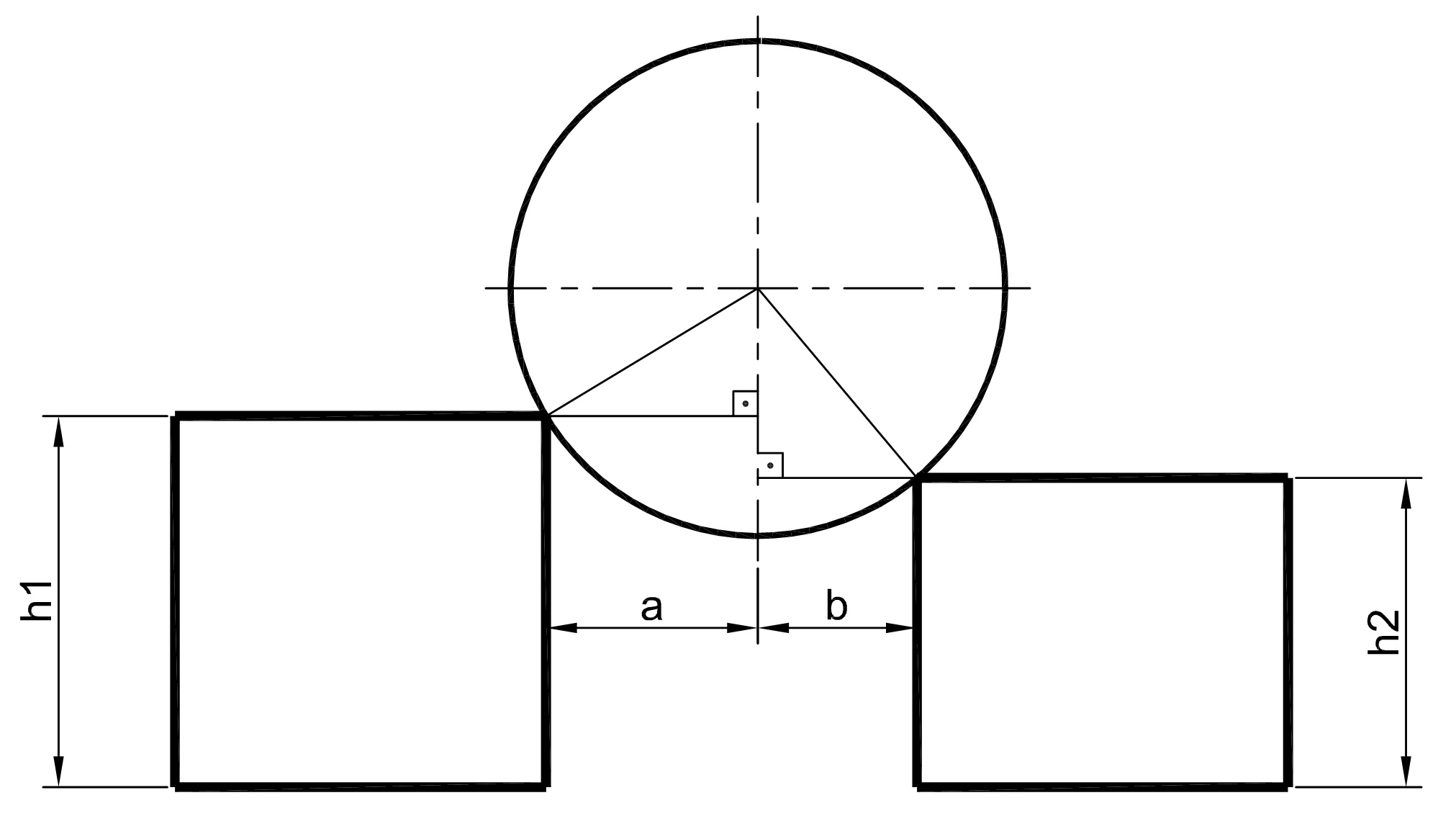

That tool has evolved into https://rick.sparber.org/UniversalCenteringTool.pdf
To test, I would drill a holed in bar stock. Put a pin in the hole, and measure the altitude of the pin on a surface plate. Flip the bar the over and measure again.
