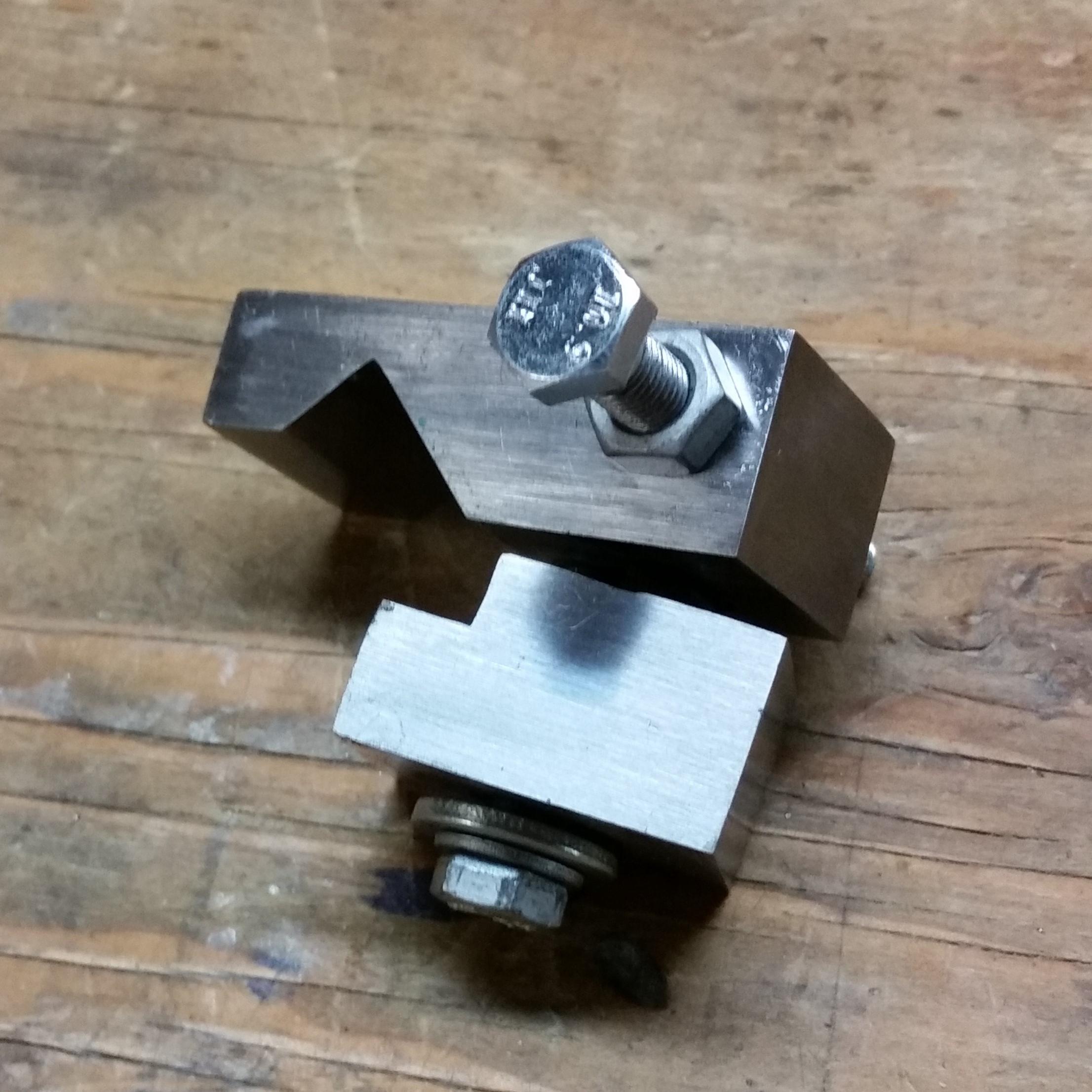

Hello, Name is Mark, retired field construction Boilermaker. attempting to learn a bit about machining. like to work with my hands and tools. have just finished up my first real project, made a carriage stop for my 10x22 g0602 Grizzly lathe. Basically a copy of one made be xynudo on you tube. Only thing I did different is I used a piece of 1/4" round stock for pivot point instead of ball bearing. machined a grove for the rod and tig welded it to the bottom piece to keep it in place.

Attachment 16727 ok figured out how to reduce pixels. hope this worked
Nice! We'll get it indexed and added to the encyclopedia, credited to your name.
