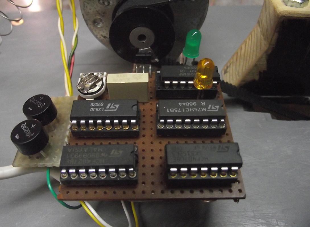

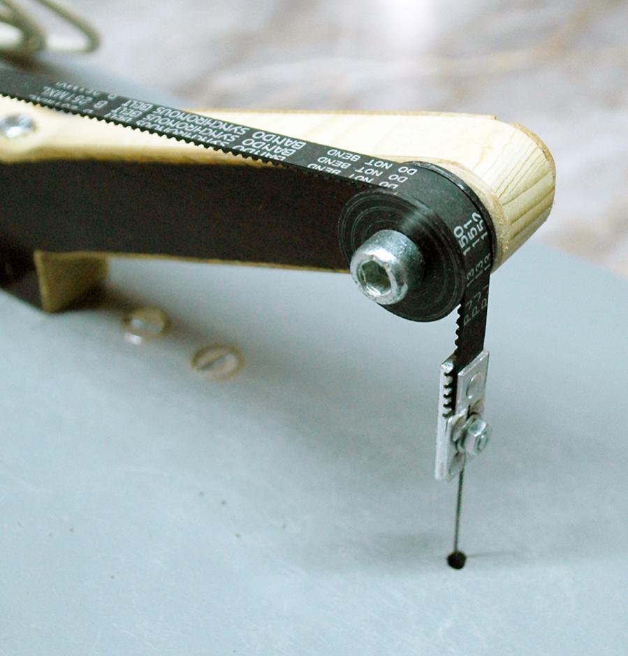

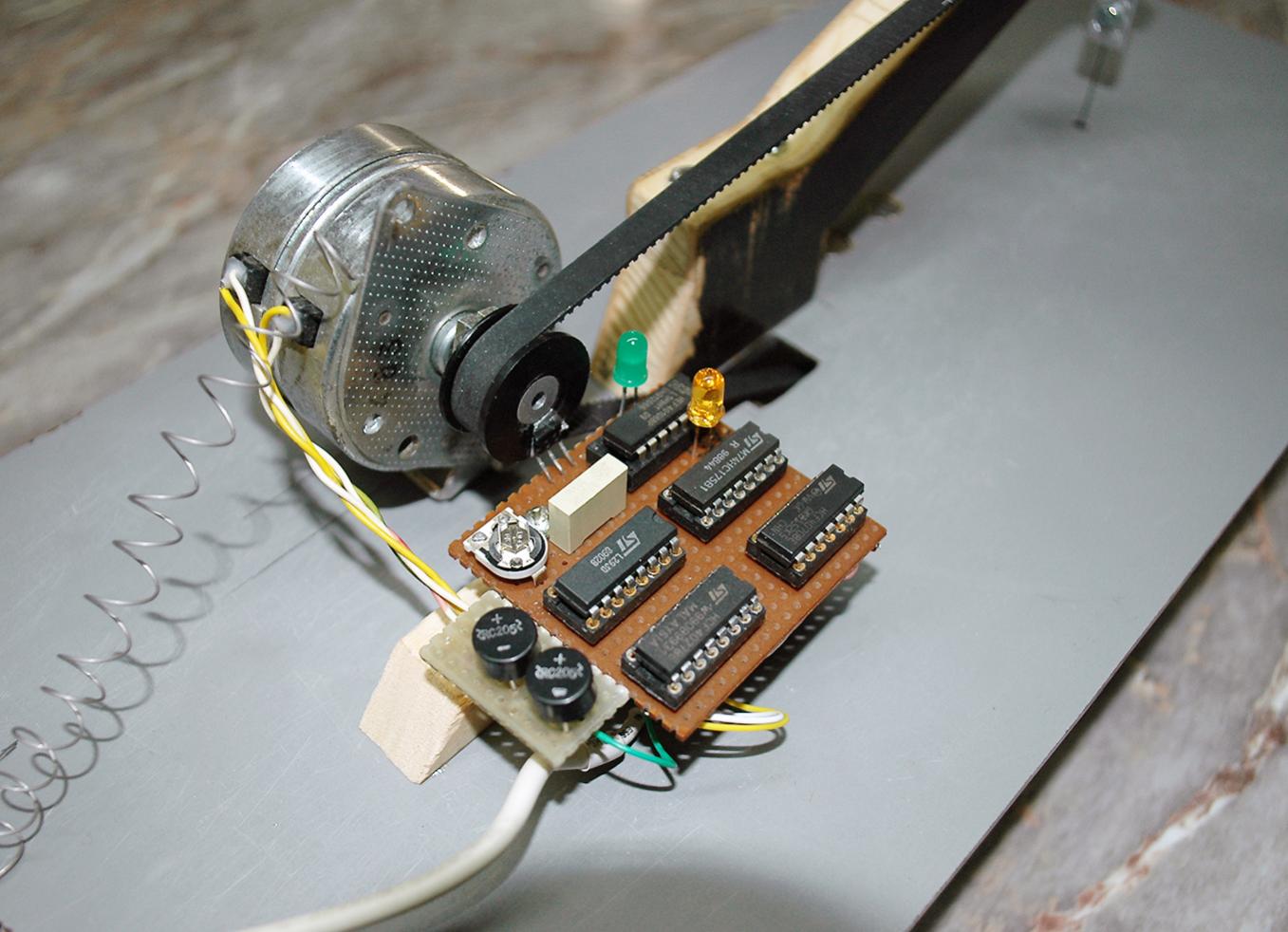

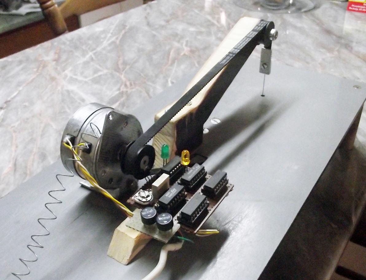

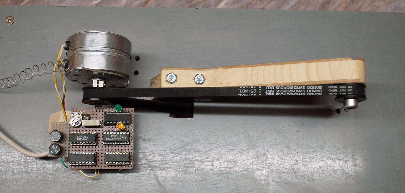

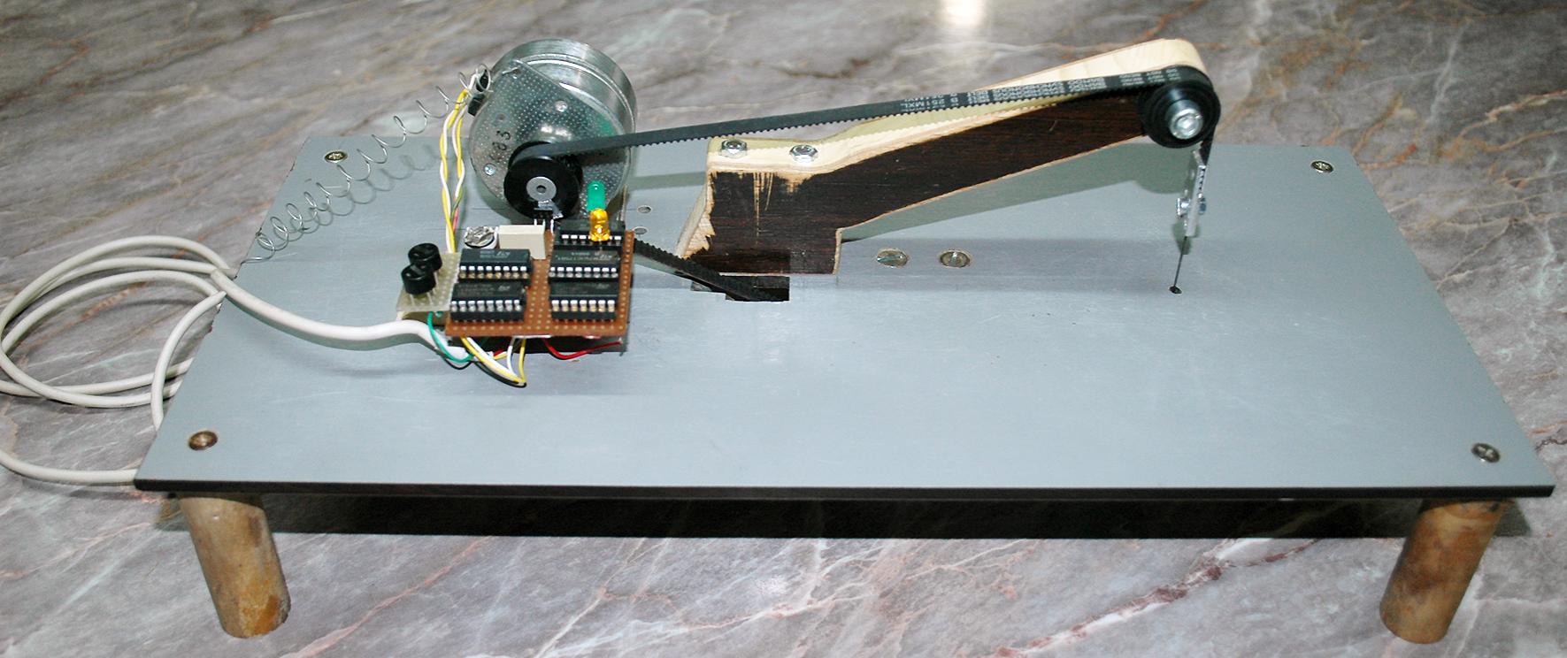

This is only test model using the step motor.For a practical use it needs a more powerful motor, but it wooorks nicely !

That's my guess. Picture a typical engine crankshaft driving a piston up & down via a connecting rod. Its converting rotational motion into 2 way constrained linear motion. Now if a belt were connected to a slider block (piston component) and looped over 2 sets of pulley wheels and the belt was open to accept the blade holders... I think that satisfies the up & down blade stroke in sawing mode. Larger crank pin radius = longer stroke. This way the motor always goes in one direction, you don't need complicated reversing mechanism. But of course you can vary the rpm for slower/faster stroke. But to keep the belt in tension & blade aligned & easy on-off for piercing the blade into inside pilot holes... thats where the R&D comes in! :)

My intention was to avoid this mechanical solution,simply by electronically changing of step motor rotation, but every design has a cons and pros, unfortunately.
